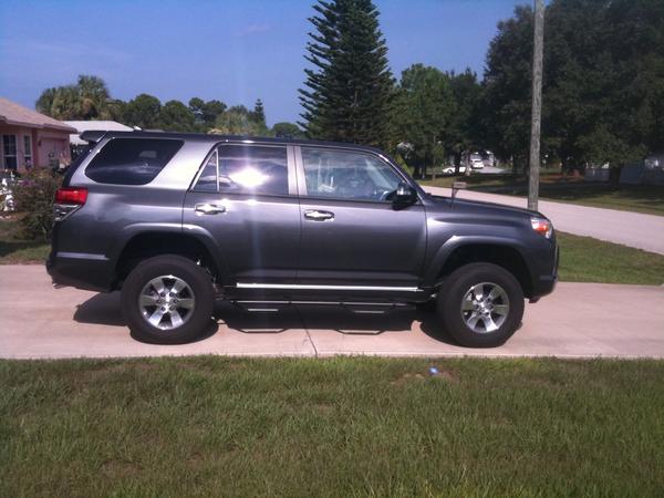

Finally got the lift installed. My driveway has a slight slant down so runner is not sitting on level ground.
I installed 884 springs on the front and 895E on the rear, with Bilstein shocks all around.
Ride is a little stiffer then stock, with less nose drive on braking. It actually feels pretty good, now I just need wheels and tires (next week).
Stock height was 34.5" front and 36" rear (ground to fender edge).
Now 38" front and 38.5" rear drivers side, passenger side sits a touch higher.
My alignment numbers weren't to bad, seeing I did not do UCA.
Camber is 0.1 both sides, caster is 1.9 / 2.0 (wanted more just not any adjustment left) and toe is .03 / .04 (total toe .07). Steering feels better then stock, so who knows what the numbers were from the factory!
Stay tuned! Anyone looking for low mileage stock SR5 rims at a good deal let me know!:zoom:
I'm running Toyo Open Country A/T's in P285/70R17's. They ride smooth and are pretty quiet. I'm still on the lookout for a second set of rims and tires, where I'll most likely go with a more aggressive tires, like a KM2. We'll see, I think the TRD forged wheels would look killer, but they are pricey.
Great looking truck! I am going to lift mine this weekend and will be doing almost the same amount of lift you did and probably the same size tires on stock wheels. I'm curious, did you get any rubbing with the 285's? I think that size looks great. Very nice.
Thanks!
I installed the tires before the lift and moved the front fender liners forward 0.5". With moving the liners forward, the tires only rubbed barely during off-camber hard turns. With the lift, that's now a non-issue.
Good luck with the lift!

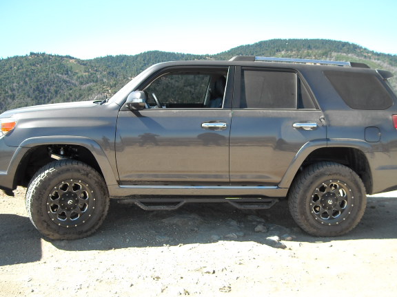

Yep Fuel wheels but onl 17". Details... 2011 SR5 with 4600 miles is all. 3" toytech 285/75/17 GY Wrangler Kevlar. Black and Gray Two tone Leather. Bought it for my 150 pound great dane so he can stay off my back seat and have his own roll down window in the back.
Bilstein 5100 all around
All pro 2" springs rear
OME 884 front springs
light racing UCA
17x8 atx mojave
285/70 duratrac

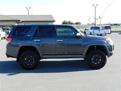

Now I have the 2/1.5 toytec spacer kit...285/70/17 nitto TG's...and 1.25" spidertrax spacers which really makes the T4R look like it should IMO. This should tide me over for a while until I get the bug to upgrade to a real lift with adjustable bilsteins. Until then...this works!
I was thinking about going with the ToyTec Ultimate Lift on my 2011 SR5, I was wondering if you have any rubbing (even at ful lock) with the Spider Tracks and the 285 Nittos TG's?
