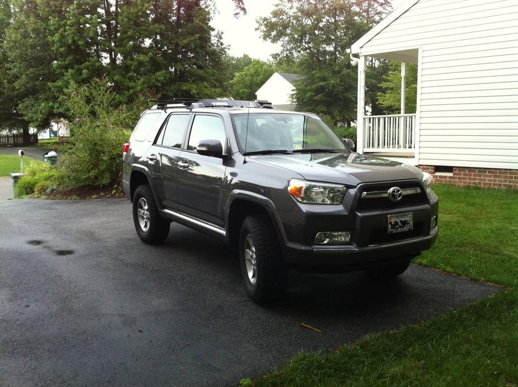

hpower1 - Looks great! Thanks for listing the tire size, can you tell us the make and model of tire?
They look great.
edit: looks like GoodYear Durratracs... how is the road noise and handling with those on?
That is funny. I do believe that is the truck. Ha.
Awesome Truck, love the stance, makes it look mean.
Looks like the other one linked above had the rocker panels removed, and yours still has them. I guess they could have reinstalled them, but either way yours looks a lot better, at least in my opinion.
Yeah hpower1 that is my old 4runner. If you look up my build under my user name it will give you all the specs you need. Or just look in my sig. I did have the rocker panels removed but gave them to the dealer when I traded it in towards a 2011 Tundra DC RW.

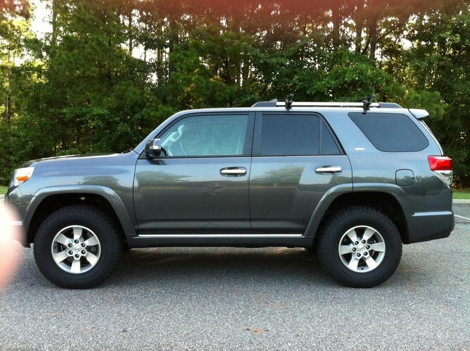

Got my 285 Terra Grapplers put on...love this setup! Ride is great with the Toytec spacers - most of my offroading is on the beach or medium mountain trails. I will eventually get new adjustable shocks and probably go 2.5" all around...but for now this is a nice, meaner look than stock!
