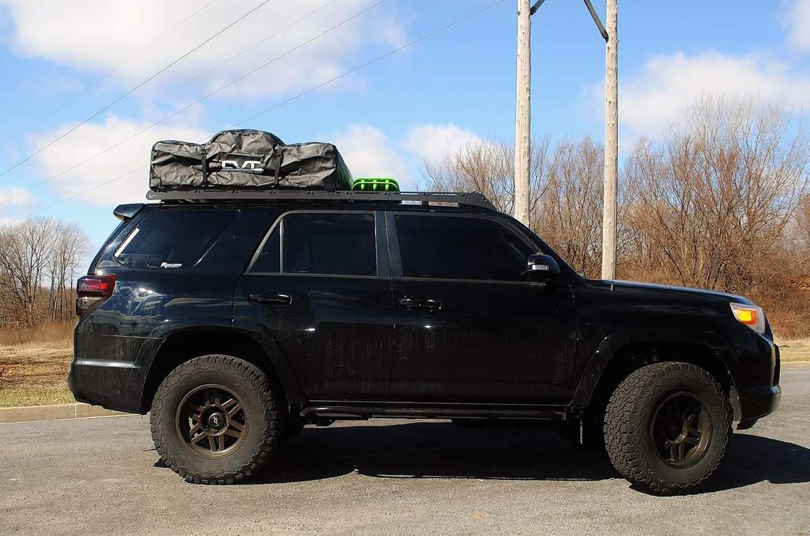

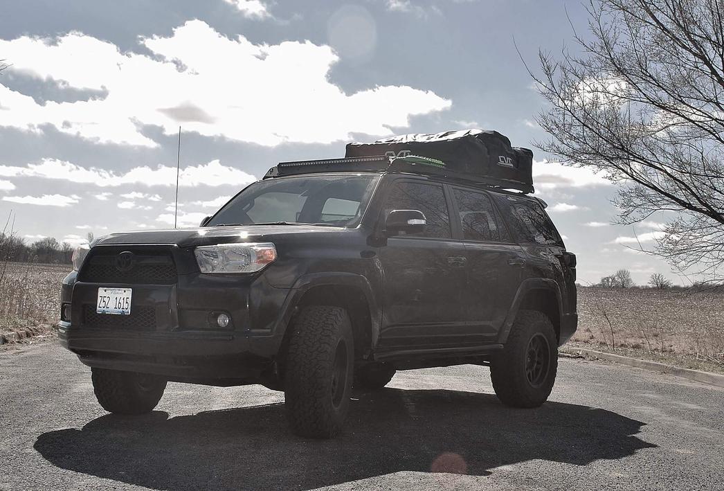

This is how SHIRO stands now with some new components:
FN Wheels Overland Bronze
Kings suspension w/reservoirs & adjusters
Southern Style Offroad hybrid bumper
Warn 10k S winch
Factor 55 Flatlink
Cascadia 4x4 license plate
Rigid Industries SR 20" combo

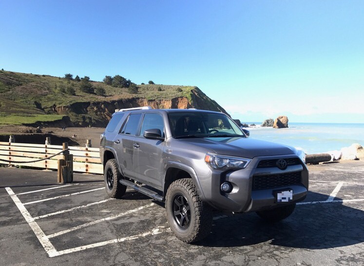

Just put the bilstein 5100's set to 1.75 on the front and had zero issue with alignment. Just had it done about an hour ago. I was very worried about it that's why I didn't go 2.5 but with numbers below I'm going to move it up before long.
I literally just told the Tech to max the caster but keep camber within spec. Not sure if I should have them match caster each side or if it's ok to leave as is but numbers are surprising with stock UCAs from what I've seen.
Driver/Passenger
Caster: 3.6/4.2
Camber: .6/.5
Toe: .07/.08
Total toe: .15

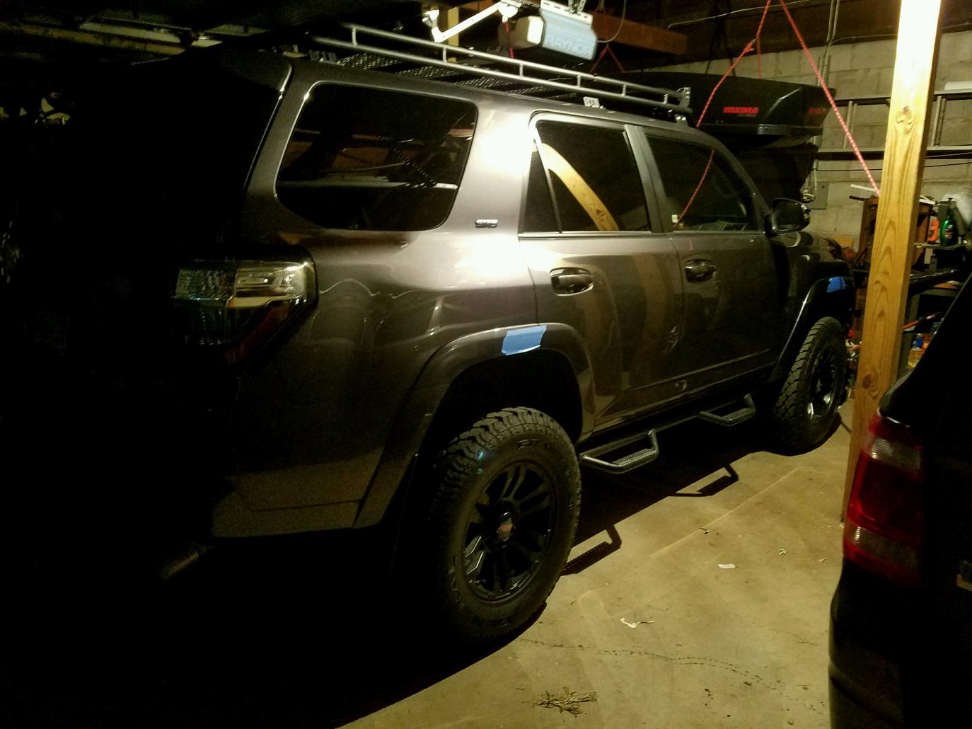

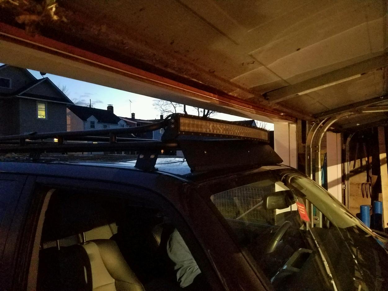

I spoke with a guy at a local off road shop that does lifted alignments all day long. He said zero issues with stock UCAs at 3" in front 2" rear. I decided to roll the dice and did 2.5" front/ 2" rear. I'll post specs after my alignment Thursday... better pics to come pics to come. My garage clearance is all but gone.
Nice! Anxious to see your alignment numbers and more pics. I keep telling myself wait another 5k before raising it up to 2.5 but its gonna be hard to wait.

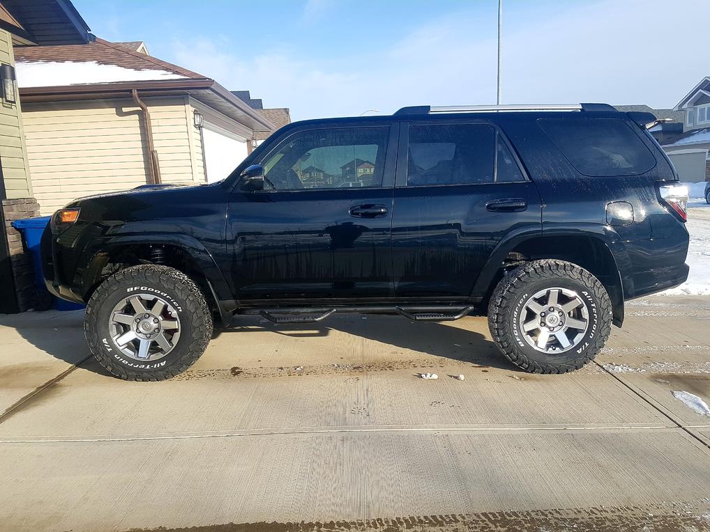

OME BP-51 OME 889 w/ SPC UCA on 235/80r17 @ 55 psi
Before and After
Front from ground
33.75" - 37.5"
Rear from ground
36.5" - 39.75"
All figures approx

OME BP-51 w/ SPC UCA on 235/80r17 @ 55 psi
Before and After
Front from ground
33.75" - 37.5"
Rear from ground
36.5" - 39.75"
All figures approx
Big difference, Looks great!
I was thinking about going with the BP-51's....If you wanted to, could you add another inch to the front to level it out little more?
