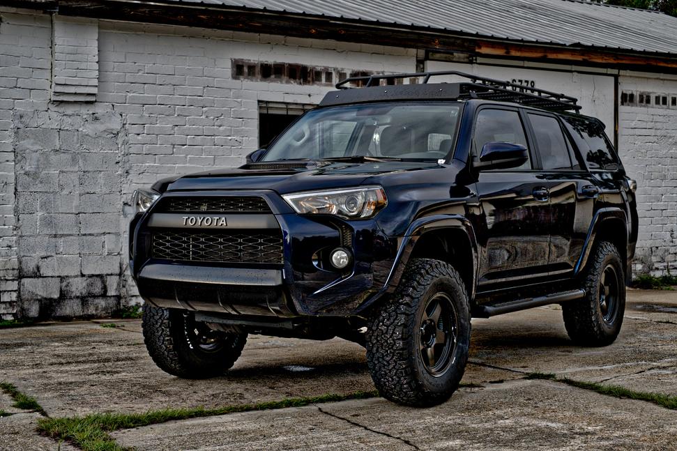

Nice! What rear springs did you go with and how do you like the ride thus far?
I did the medium load coils rated for 200-400 lbs to start and I love the way it rides so far. I am planning to eventually move on to full bumpers, tire carrier, roof rack, etc so will be upgrading these to be a bit more heavy duty in the future.. but for now I'm very satisfied with how it's settling

Good to hear..right, with the addition of the rear bumper if you stay with OME..the 898s handle well. You shouldn't ever have to worry about the front coilovers though which are 700# I believe

Good insight, are you running BP-51's on your rig? Or just OME coils? Love your build as well, can't wait until I'm ready to make moves on bumpers and roof rack to be a bit more capable off road.

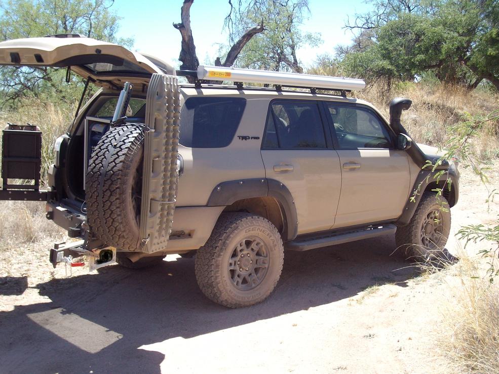

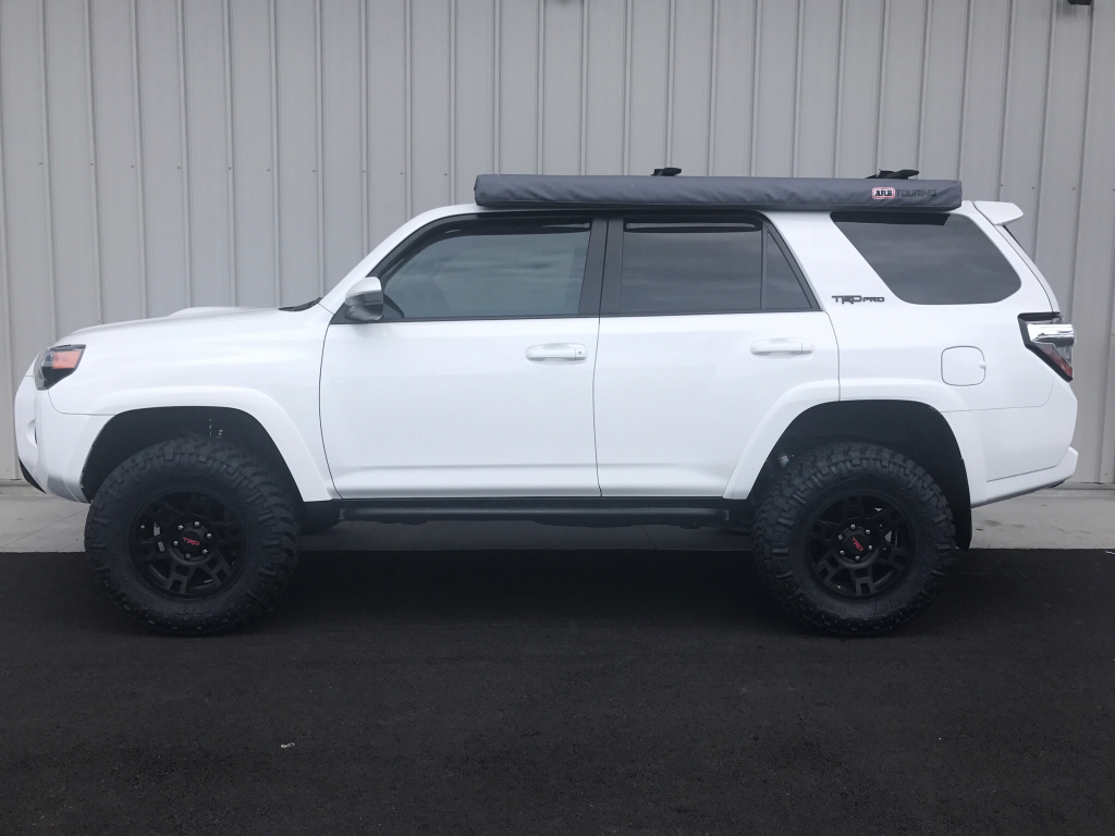

Yes, I've been running 51s for about 6 months now with OME 899s in the rear. Also, I added TC UCAs as well and you will get squeaks out of uniballs...racing parts..racing noises. I just molly lube the uniballs and grease the fittings every oil change or as needed

Yeah, in regards to the UCA's I couldn't really find any brand that has uniballs and won't eventually squeak. Really happy with the TC thus far though... as you said if they've proven themselves as racing parts they'll prove themselves offroad. It's awesome to see you running the same suspension setup, hopefully it won't be long before my build is somewhere close to yours. Really looking forward to being able to take some long range trips in UT, NV, and AZ in your neck of the woods. What kind of roof rack are you running right now?
Eezi Awn K9 2.2m

Bro love this QS build! That color has grown on me and looks WAY better with the black flares, especially the BW ones. Let me know when you sell it so I can have 1st dibs. :cheers:

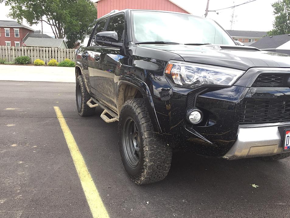

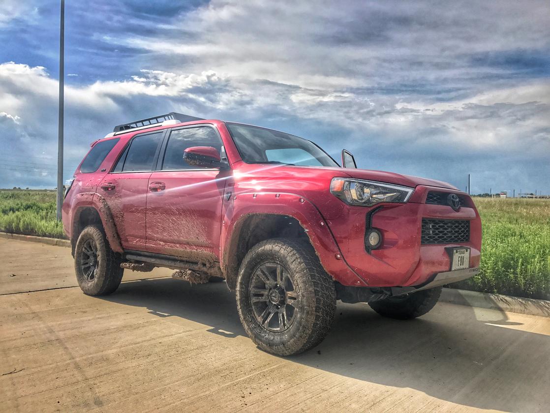

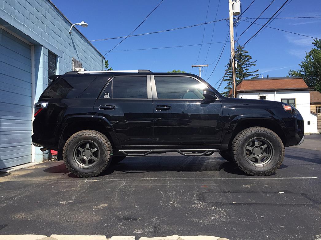

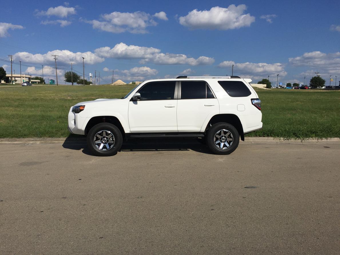

Subtle lift/Leveling
Just installed the Bilstein 5100s @ .85

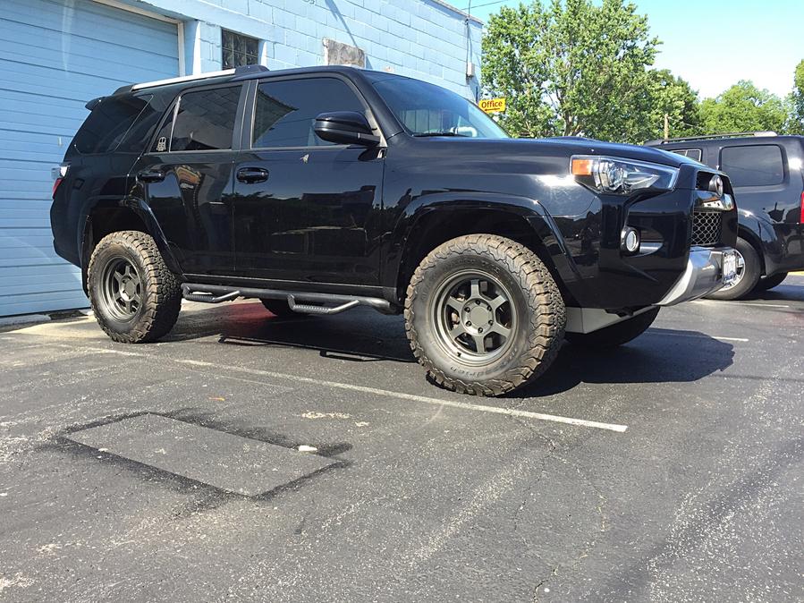

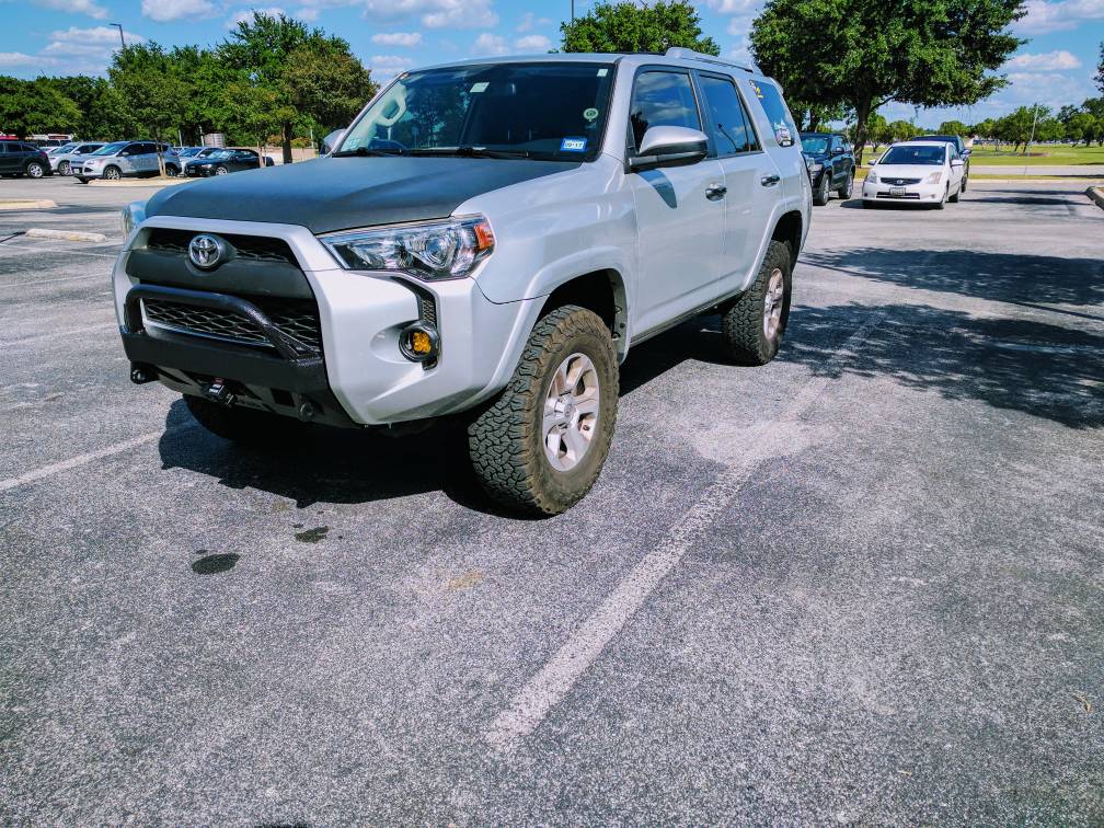

Finally got my lift on. Went with toytecs ultimate lift. Front is set to about 2.75". When I get a pair of aftermarket UCA's, I'll add .25" spacers on both sides and crank them up a tad bit to level it out.

Nice rig! What kind of tires are you gonna run / running?
