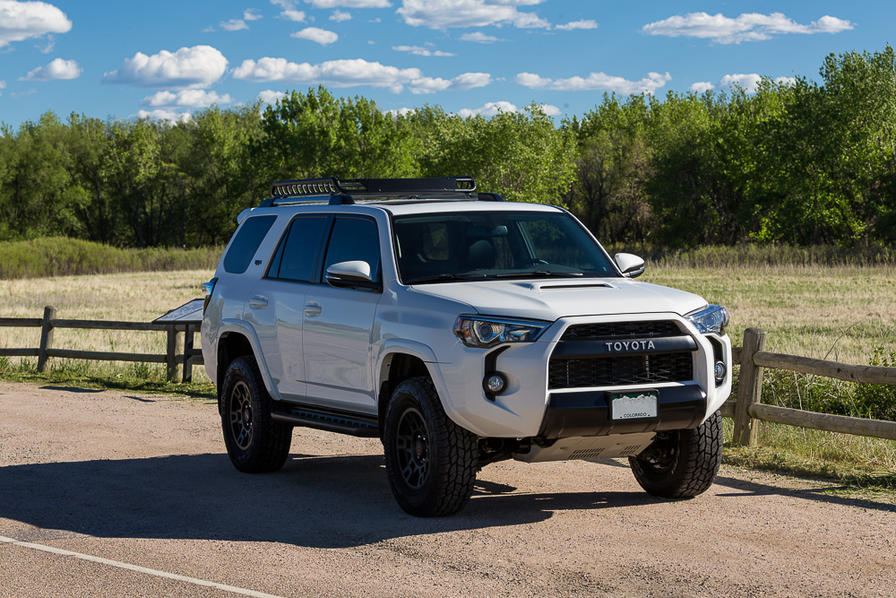

Minor lift on full TRD suspension, effective 2" front lift over stock (1" over stock TRD Pro), 1.5" T13 coils in the rear. Not a fan of the front riding higher (as it would if you evened the space in the wheel wells), thus about an inch of rake, which effectively evens the height of the running boards (and frame) relative to the ground.
I like it.

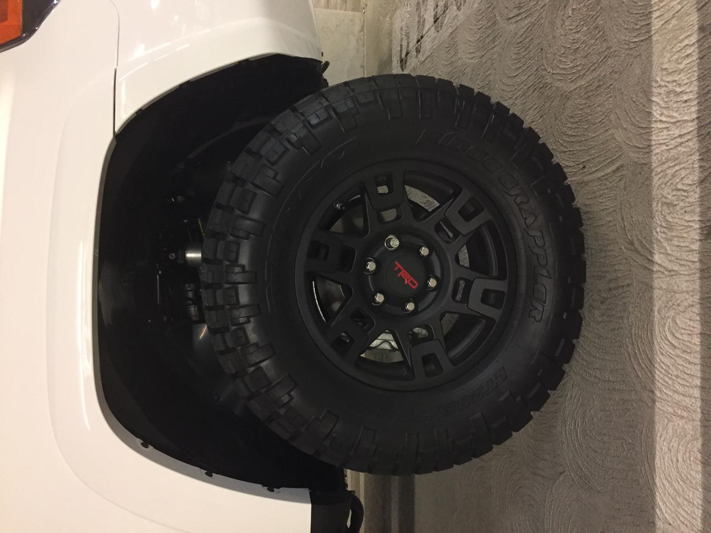

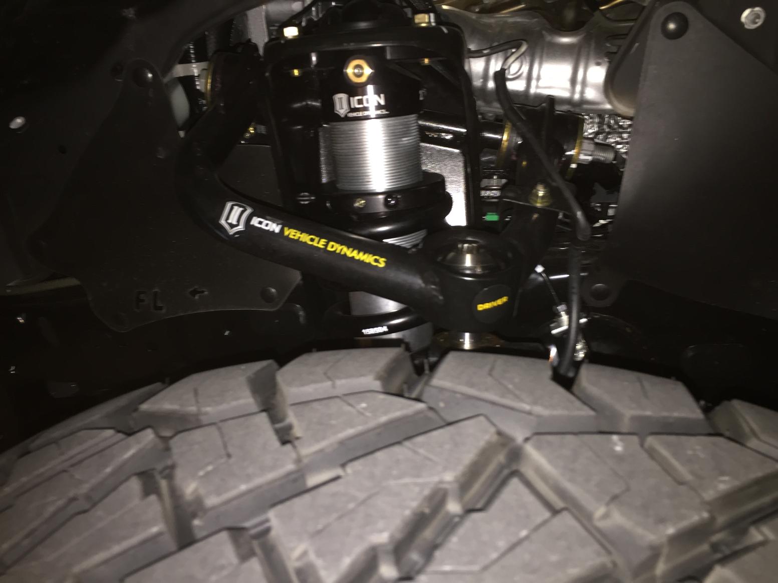

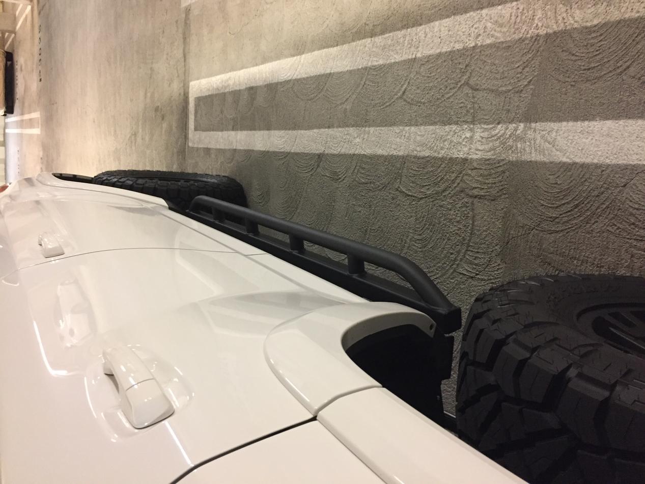

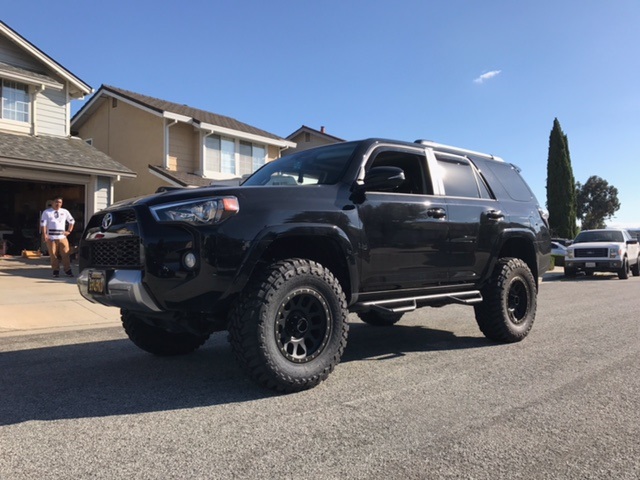

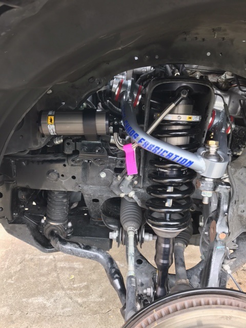

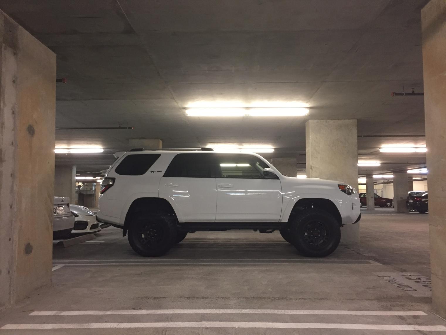

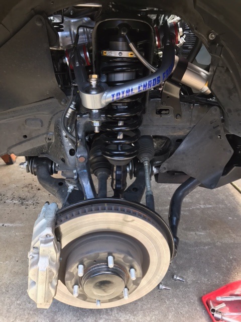

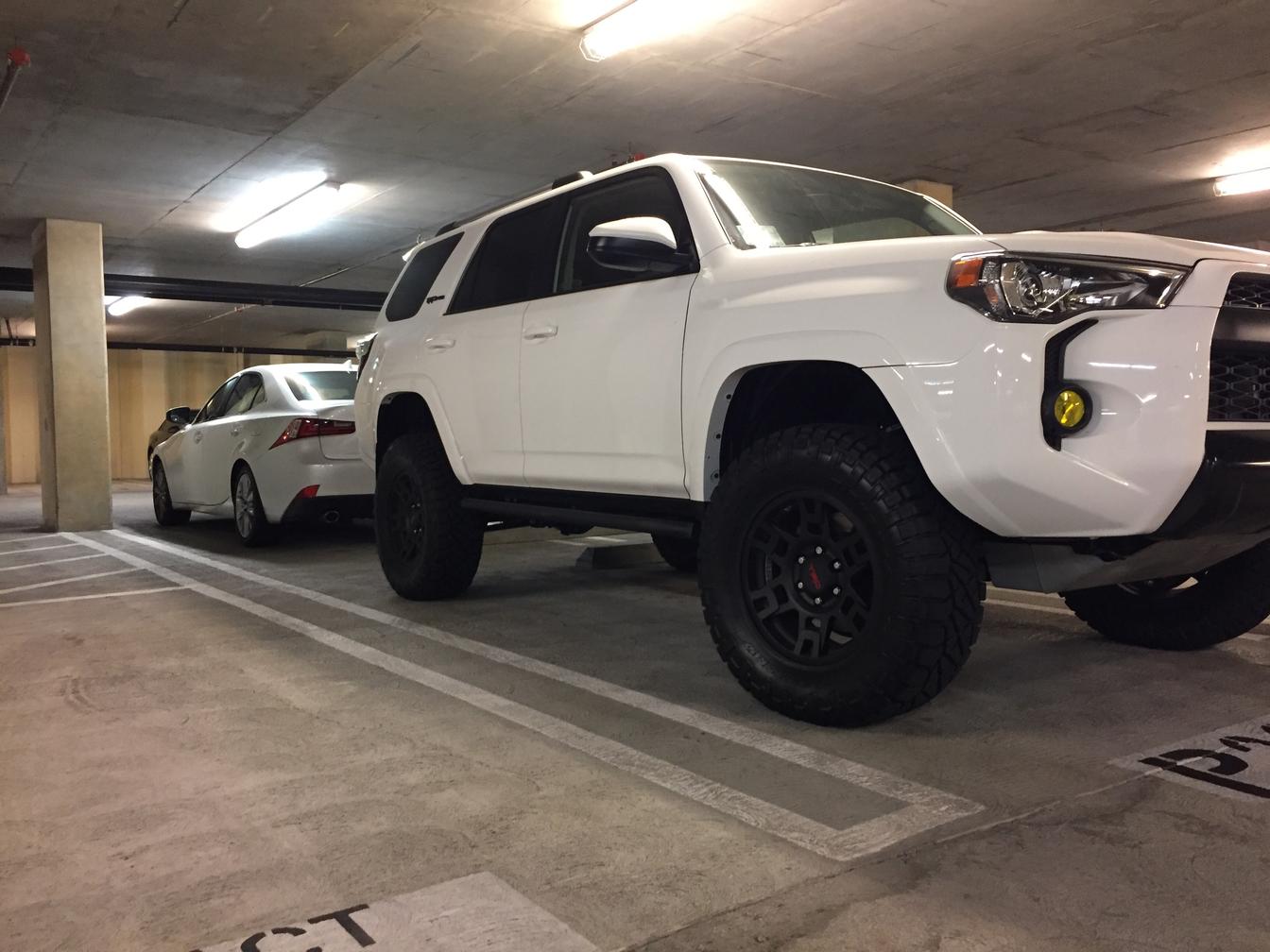

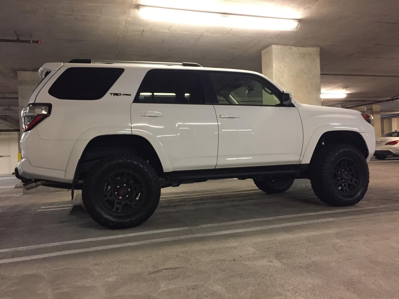

Hello T4R,
Icon extended travel front coilovers
Icon tubular UCAs
Icon 2" rear coils
Spidertrax 1.25" wheel spacers
Demello Offroad hybrid bolt-on sliders
Nitto Ridge Grappler 285/70R17
Sorry for the low light pics. Will take more in the light another day.

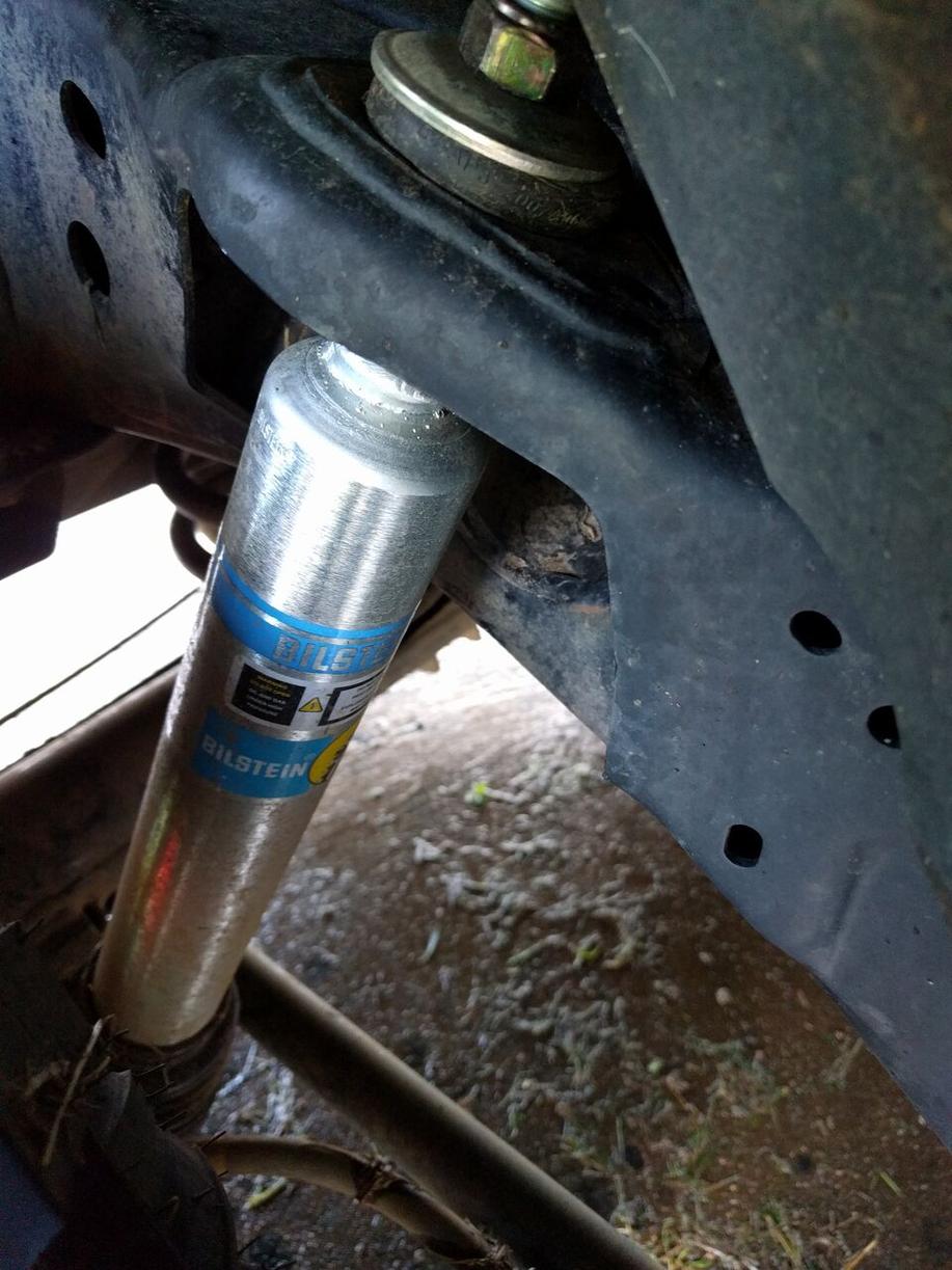

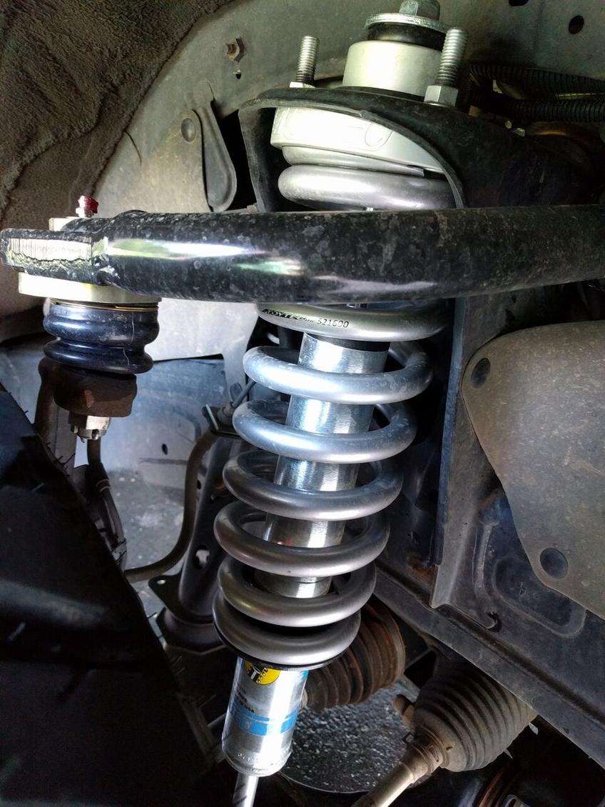

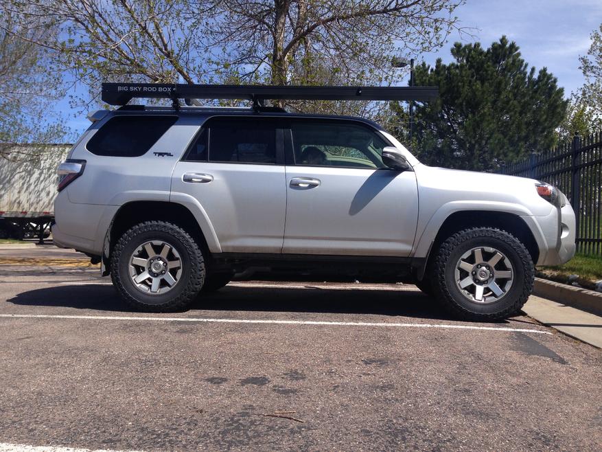

5100' s front and rear. Fronts set at 0 - OME 884 springs front, 2 inch Icon springs rear.

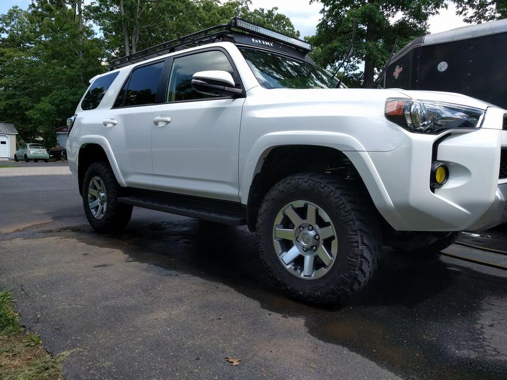

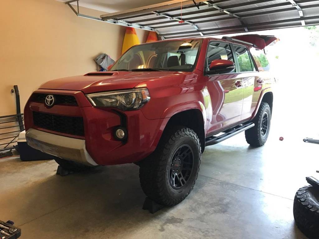

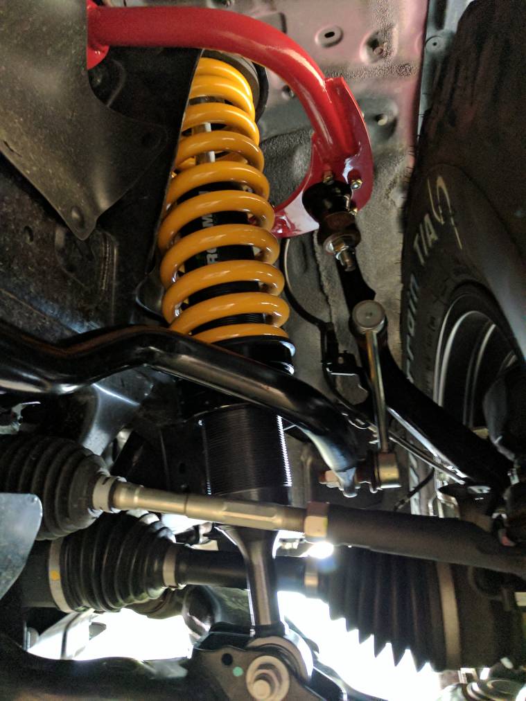

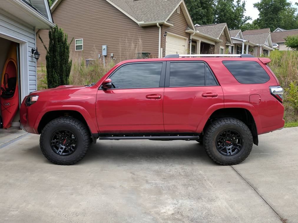

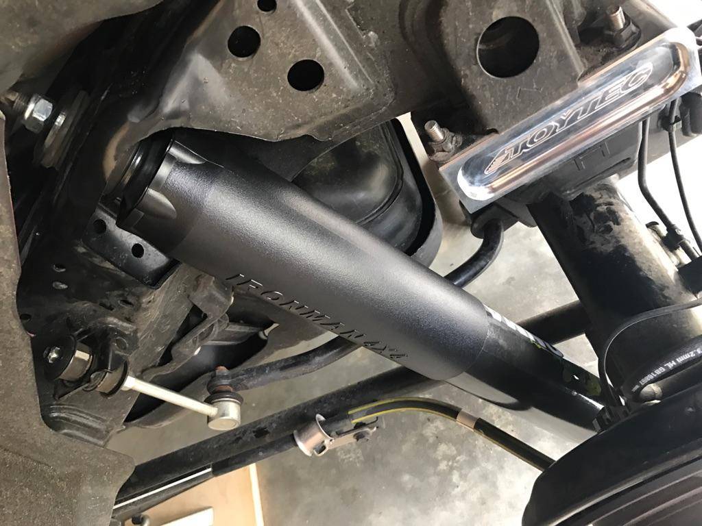

Finally get to post here. Ironman Foam Cell Pros, JBA UCAs, Toytec rear bump stop extensions and Icon 2" rear springs.
Sent from my Pixel XL using Tapatalk
How much lift did you get in the front? Looks good
Sent from my SM-G935V using Tapatalk

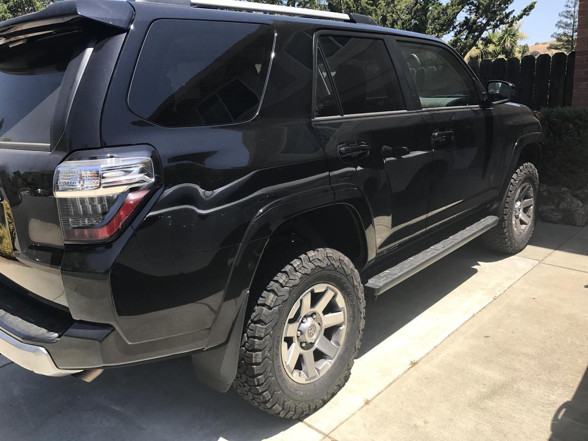

Sometimes on the driver side rear, the lift is an inch taller from the top of the tire to the fender. It seems normal from what I've read (lean). It has something to do the with KDSS.
Also I think I want to bump the front another .5 to 1 inch so it's not so raked.

Looks good Bocean. Do you happen to have center hub to fender measurements?

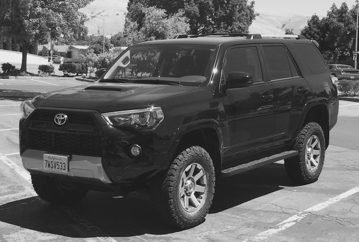

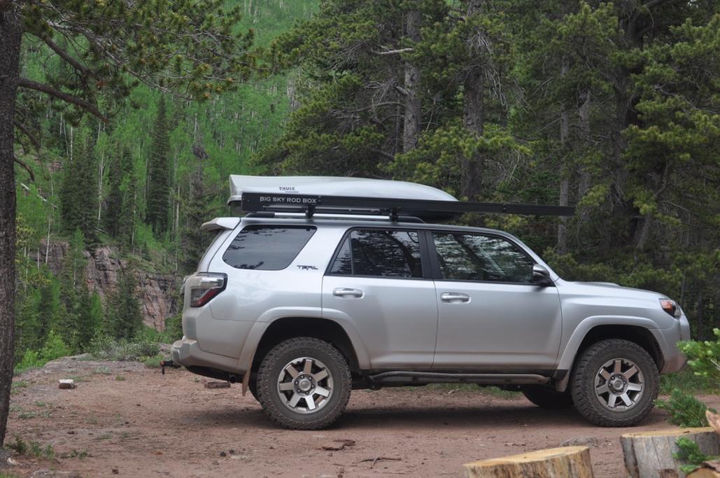

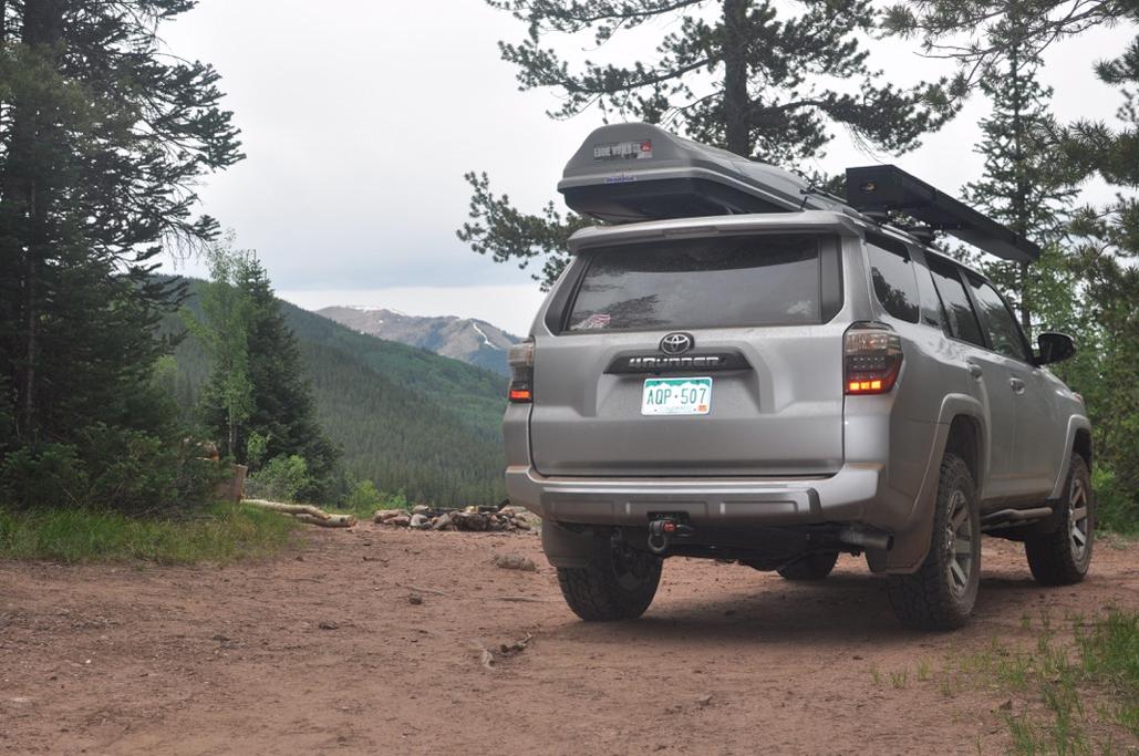

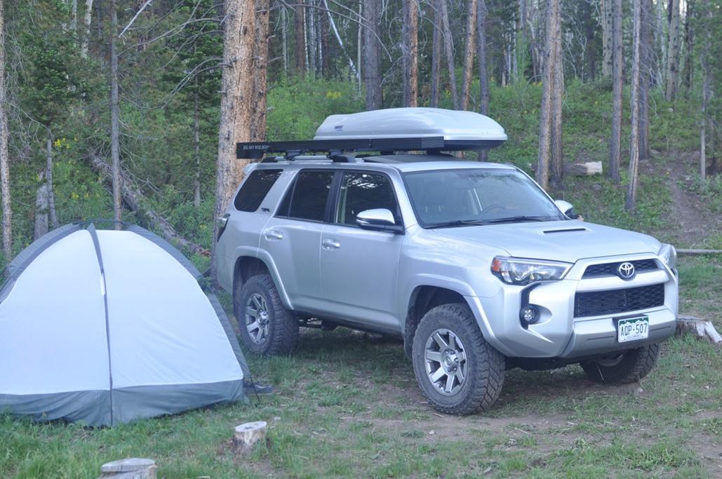

Not the best photo quality (from phone in bright sun), but here's mine with a Slee "low lift" using OME shocks and OME 2883 & 2895E springs. Achieved between 1.5 and 1.75 inches of lift on all 4 corners. I have garage height limitations and this gets me in there with only a couple millimeters to spare; plus, no worries about alignment difficulties and needing UCA's at this height. Tires are ST Maxx 255/75/17 (load range C). Rides/handles wonderfully; the excessive stock braking nose dive is gone.
[MENTION=134774]Ski Wagon[/MENTION] - Looks amazing, I really want to go this route and everyone is telling me I'm crazy. If you didn't have the height limitations would you have gone with the 2884 over the 2883. Also, I know it couldn't hurt, but do you think you could pull more caster with a set of aftermarket UCA. Do you have a build thread..? I'd love to see a few more pictures.
If I didn't have the garage clearance issue initially, then I likely would have gone with the "standard" 3" OME springs. However, I recently put 255/80 R17 (33") tires on and have no rubbing issues, so, in hindsight, I'm very happy with the current lift and not having had to spend the extra cash on UCA's. Slee did the install and aligned it to "their" specs, so it has never had any problems. Here's a few more pics (the mountain setting ones being with the old 255/75 R17s).

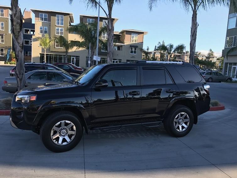

2015 TEP w Toytec/Bilstein 5100 Lift and LR UCAs-255/75/17 Nitto Trail Grappler MTs
