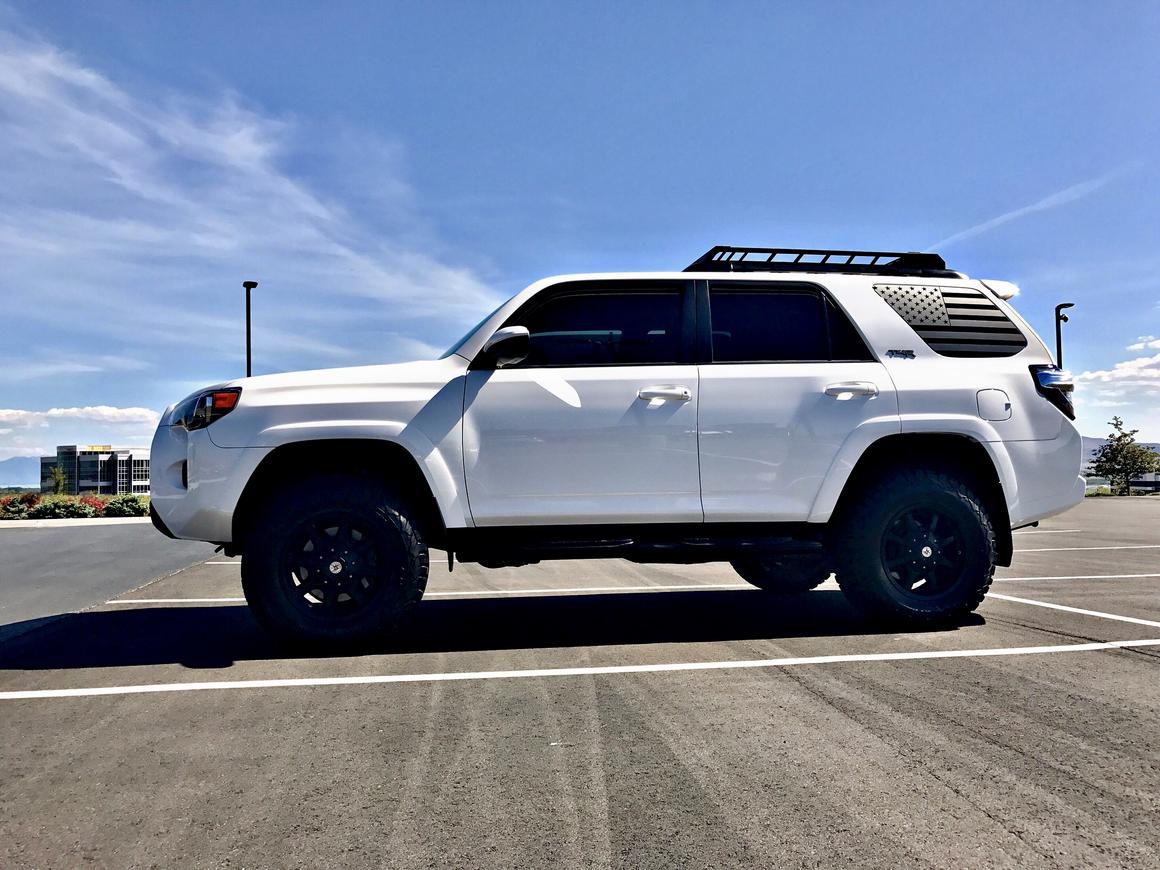

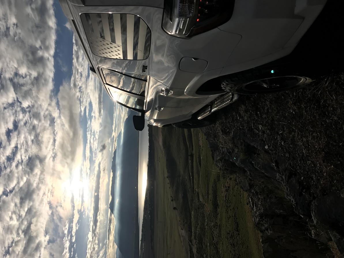

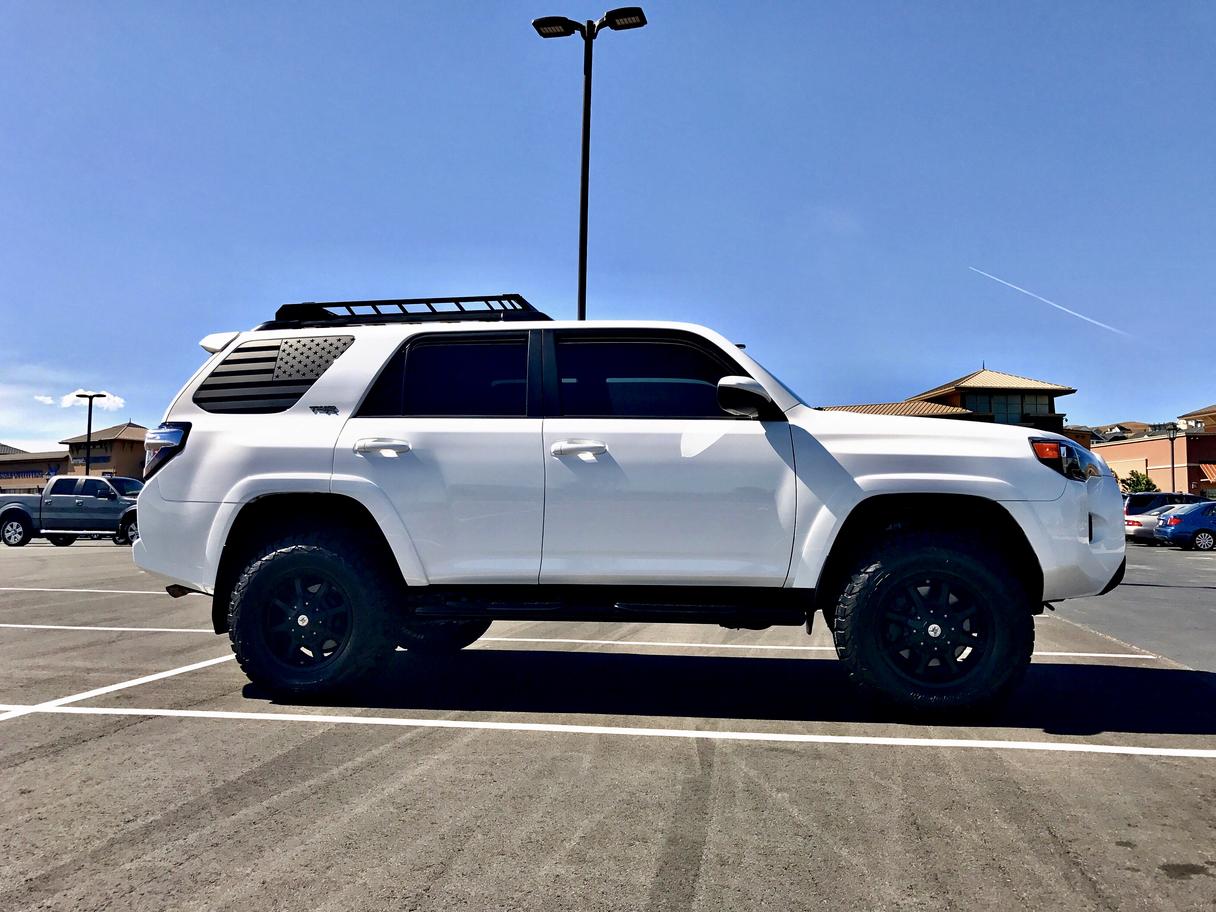

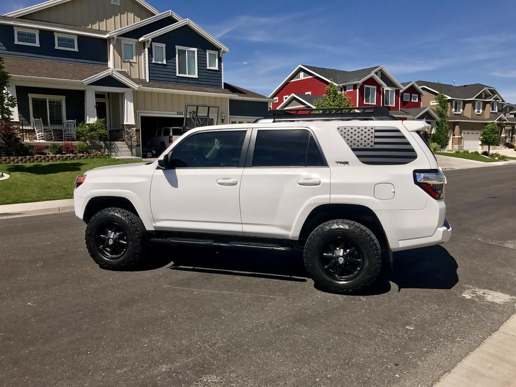

Finally Done!! Well.. For now.
Here's a few pics of The GOAT ��
Bfgoodrich KO2'S, American Outlaw Wheels, N-fab roof rack, daystar leveling kit, tinted windows.

Nice rig, bro! Are those 285 KO2's? I'm thinking about those flag decals too especially with the discount.

Yeah the flags give it such a cool look! But no.. They're just the stock 265/70/17 KO2'S. when they wear out I'll take the leveling kit off.. Put a lift on and do 285's

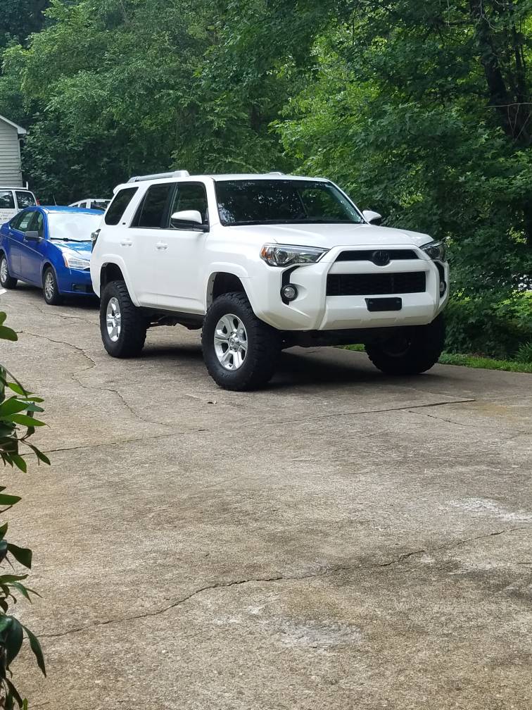

Finally got my lift on. Went with toytecs ultimate lift. Front is set to about 2.75". When I get a pair of aftermarket UCA's, I'll add .25" spacers on both sides and crank them up a tad bit to level it out.
No need to add spacers, just set the preload where you want it. The back is going to settle a lot also. I have the same lift. Mine settled to the point that with the front set to 3" I had negative rake and that's with zero added weight in the back. Not thrilled with these rear coils. Ended up installing a 3/4" Cornfed spacer in the back to give it a slight take again but very little.

Thanks for the input! I'll give it a couple weeks and see where it'll settle. In the mean time I'll continue to shop around and see what UCA's I'm going to go with. Were you able to get your alignment within specs at 3"? Or do you have aftermarket UCA's already?

I was able to get 1* caster 0 toe 0 camber with the OEM arms. Rides great but I do plan on going with aftermarket uppers.

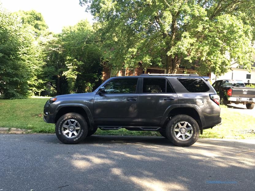

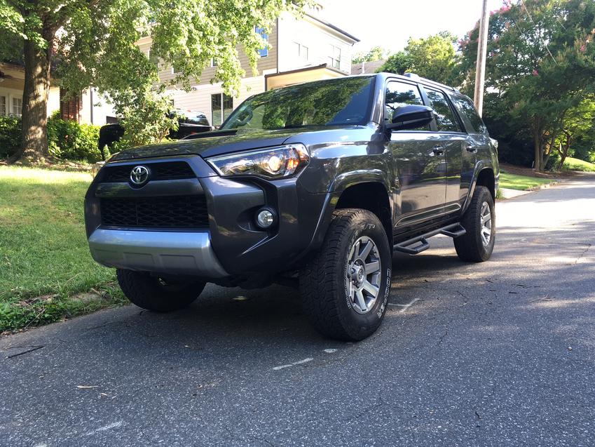

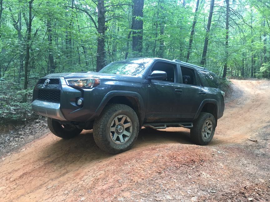

Finally I can post in this thread!

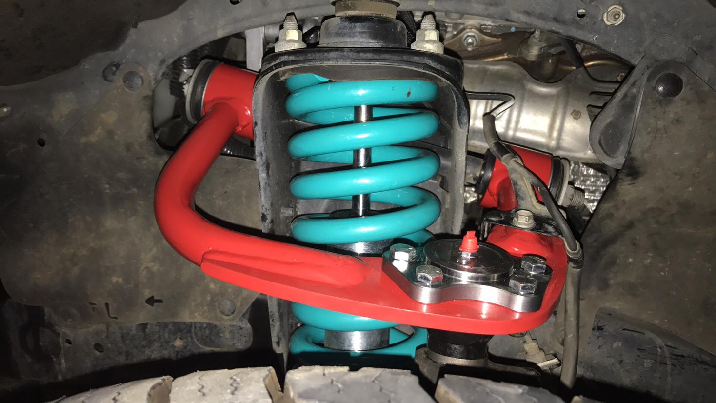

I've had my 2014 4Runner Trail since January this year and finally pulled the trigger on my lift setup and got it installed 2 weekends ago. I went with Dobinson's 302 front springs and 505 rear springs for a desired 2.5"F/1.5"R lift. I ended up getting about 2.5"F/2"R. I used 5100's front and rear with the fronts set to 0. Photos shown are with 4 x 80lb bags of quickrete in the hatch in an effort to settle the rear springs a bit. I also installed JBA UCAs up front. Rides great, hit a few moderate trails at Uwharrie last weekend with no trouble at all.

Well, I guess I'm just gonna have to go ahead and give it a couple turns to raise it then I don't mind losing a degree or so on caster. I was more worried not getting 0* for toe and camber.
