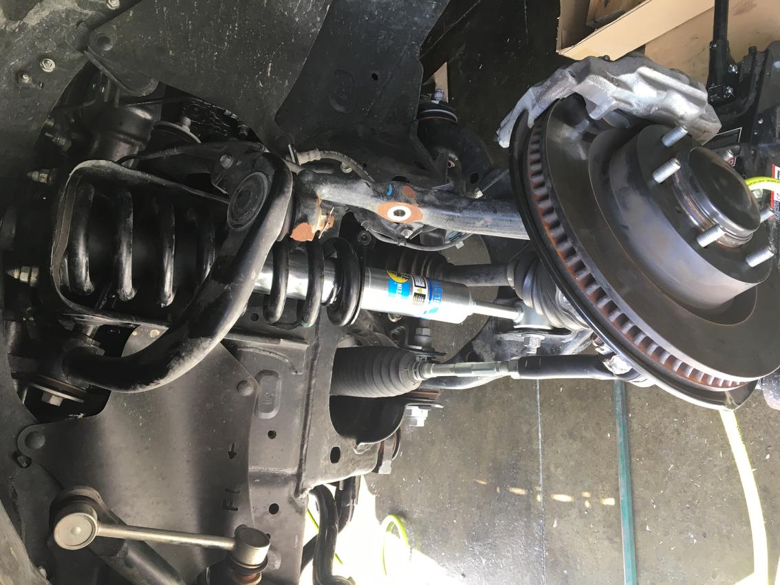

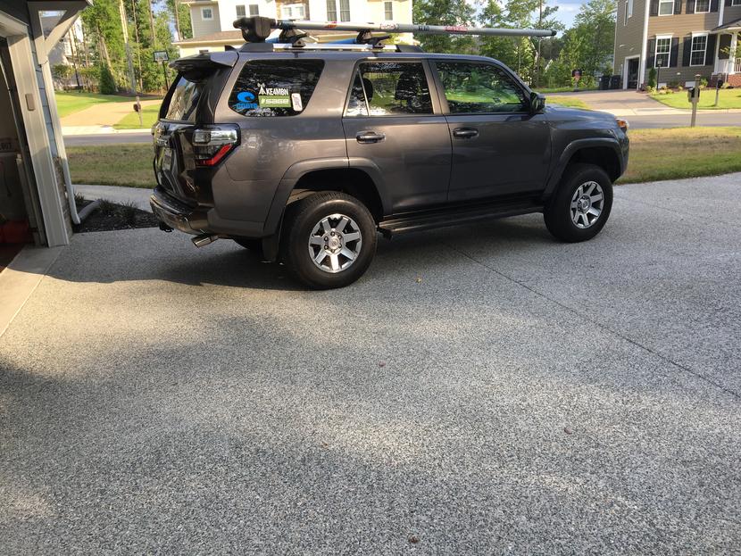

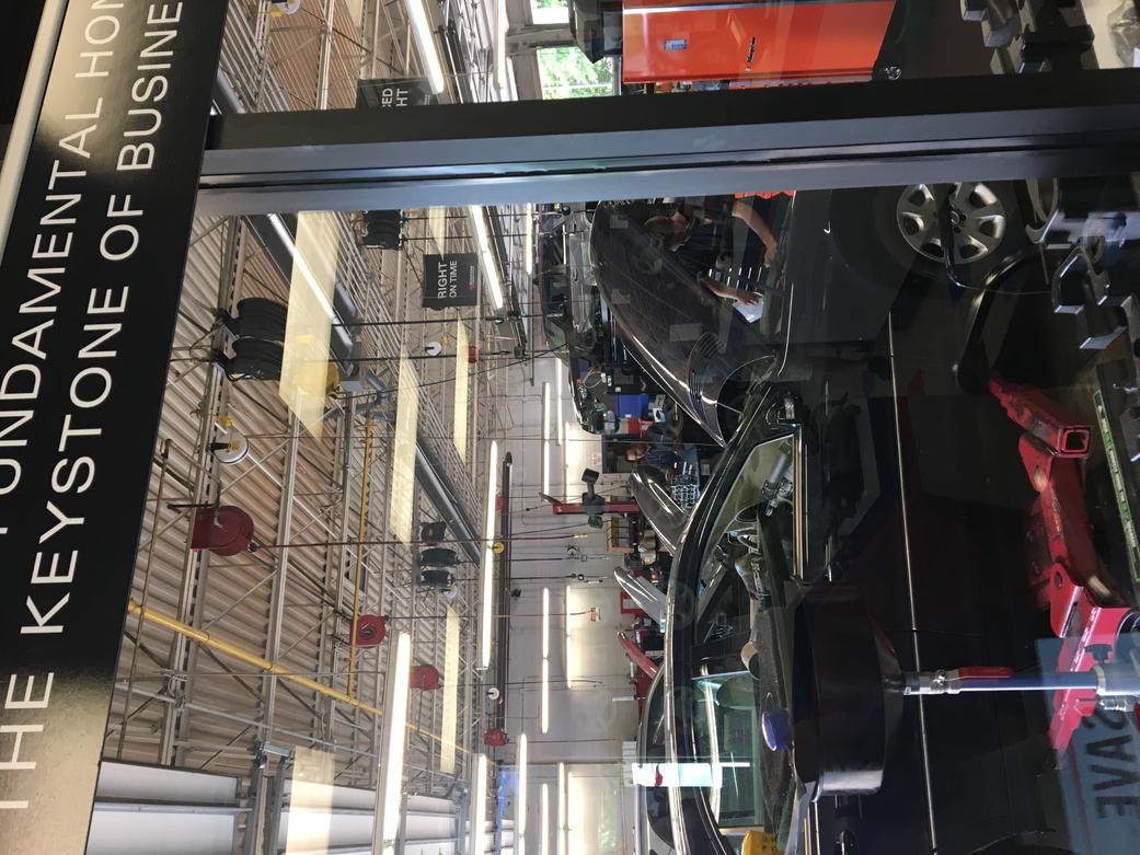

Sorry for the boring driveway picture but here is my setup. I took it to Firestone today to get an alignment and with 5100's all the way around (front set at top clip!) and daystar 2.5" spacer in the rear)) the alignment tech was able to get everything within spec with STOCK Upper Control Arms! He said it was easy and I have plent of room for more adjustment. It drives great with no wonder, noises, pull etc.

Did he give you a print out? Just looking at your driveway pic makes the front look like it has positive camber.
Factory specs are wrong for a lifted 4Runner, by far. Stock uppers work but they max out at 1* caster when lifted 3" which really isn't enough. You want 3* or better. What is your measurement from the center of the front wheel hub to the bottom of the front fenders? That is extremely important to know.
