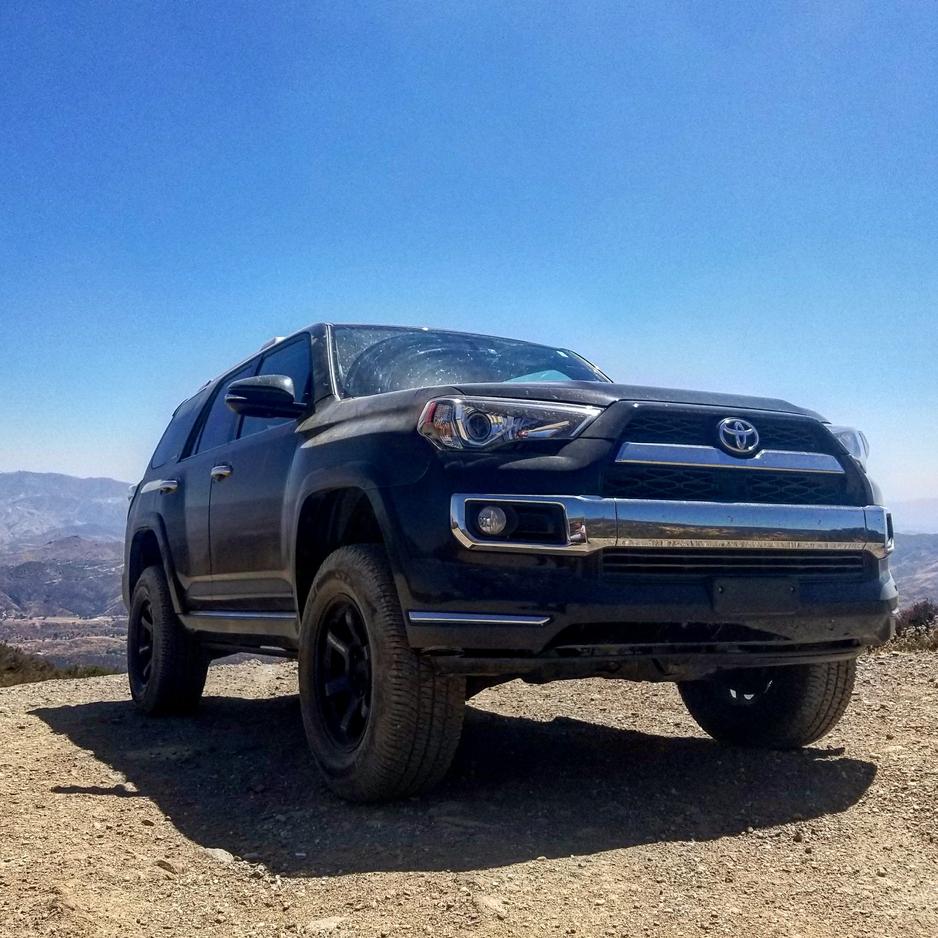

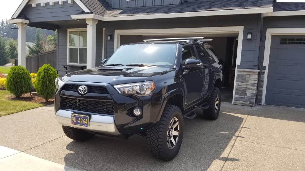

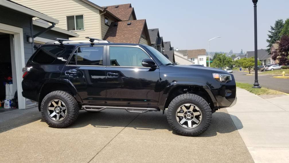

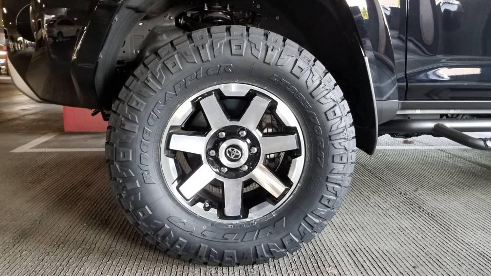

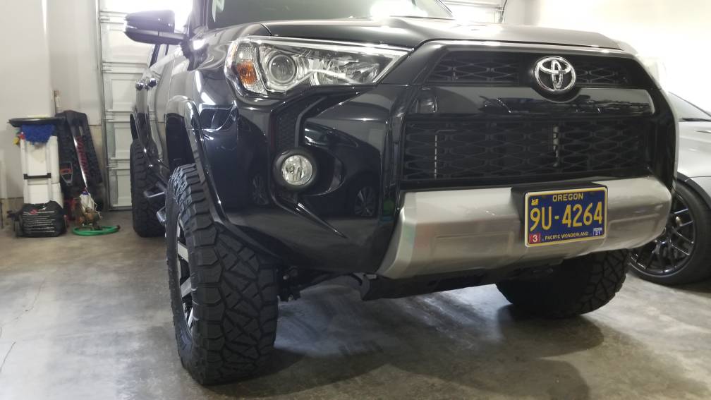

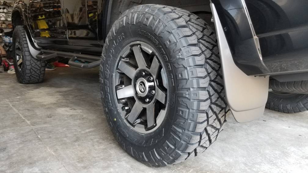

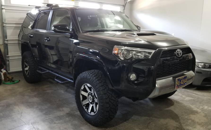

Here's my 2017 TRD OFF ROAD PREMIUM w/ KDSS. 6112/5160 combo. Front lifted all the way to the top of circlip and added 1/2 toytec spacer. Placed toytec superflex at the rear w/ a 2 inches lift. Went for a 1.5 inches wheel spacers by synergy. Kept my stock trd off road wheel I like the way they look and put 285/70/17 Nitto Ridge Grappler. Did a minor cut on my front mud guards but no body mount chop. Has rubbing in front but only on reverse full turn when car is leaning to one side but bearable very small rub. I hope this will inspire new guys wanting to do the same set-up or some ideas and how it will look. Proud to say I lifted this bad ass on my own. Can't wait to put this on it's paces. Hope everyone appreciates it! :)
Sent from my SM-G950U using Tapatalk
I like your setup. I'll keep my eye out for you around town. You do the same

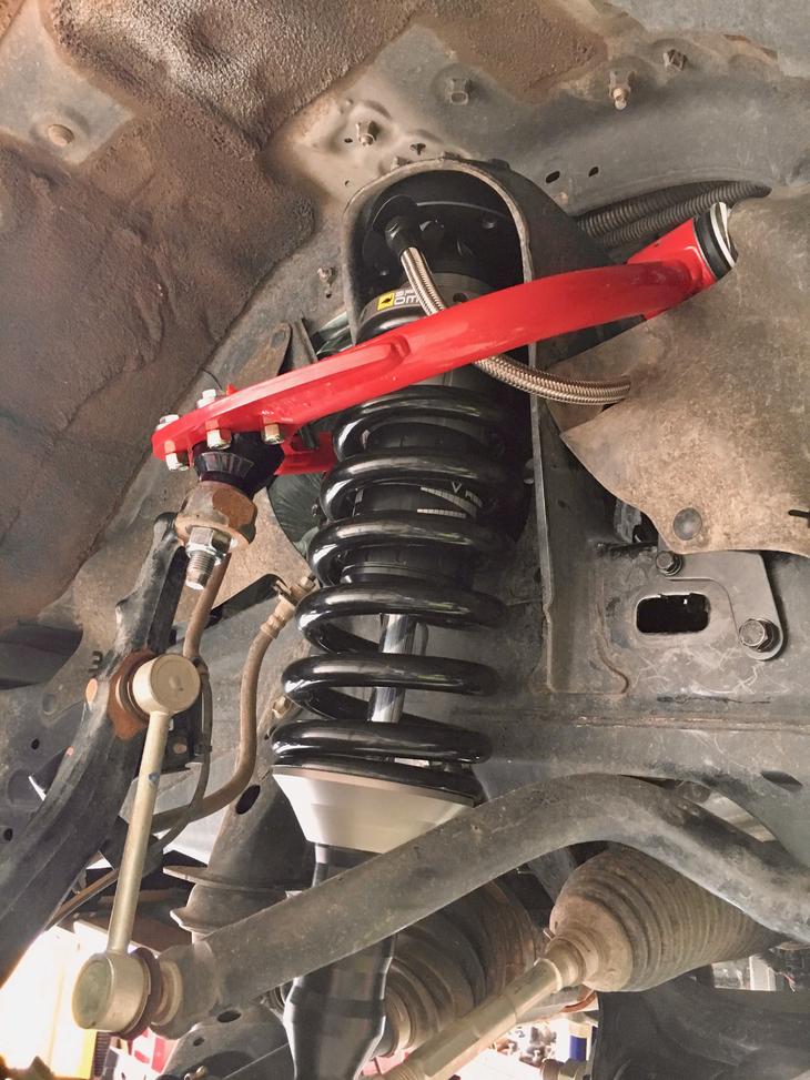

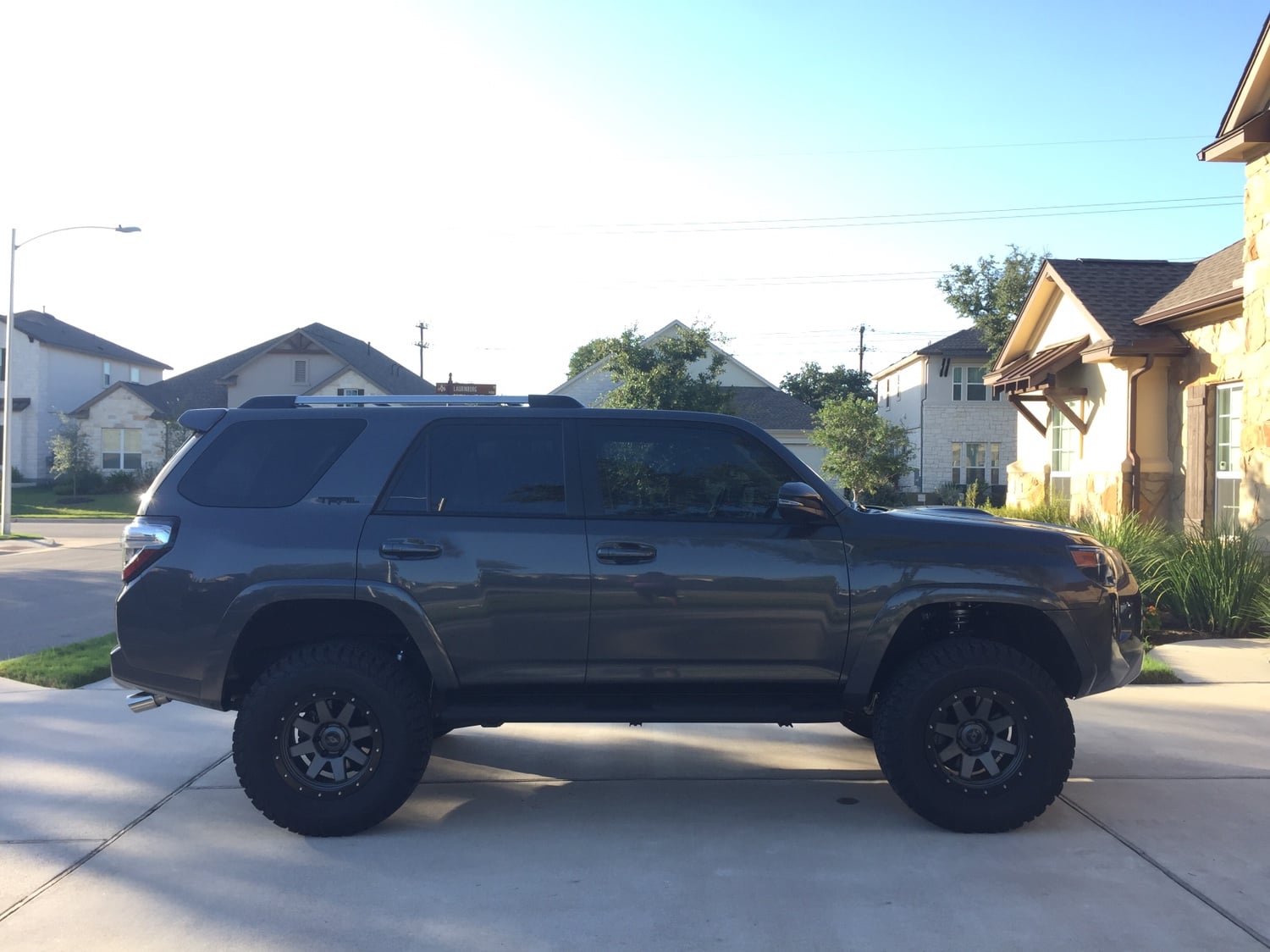

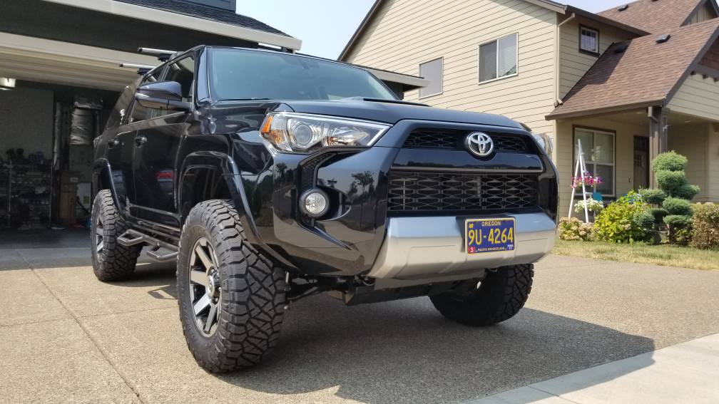

New OME BP-51 and JBA UCA's
I installed this new set up last week and finally got some time to check out the new suspension off-road. So far I am very pleased with the results. The lift added about 3 inches in the front and 3 1/4 in the rear with new medium springs (889's). I did not make any height adjustments from the way they shipped from OME. These should settle a little as I plan on a adding a front bumper/winch (130 lbs) and some storage drawers and regular recover and camping gear in the back (100 - 120 lbs?).

Did you ever do the 2.5" front and 1" rear? thinking about doing it. Any photos?
Def would not recommend this, I'm currently at 2.5 front and 1.5 spacers in the rear and with any type of load I'm sitting with a negative rake. Currently waiting on some OME 895e rear coils to replace the spacers to hopefully remedy the issue.

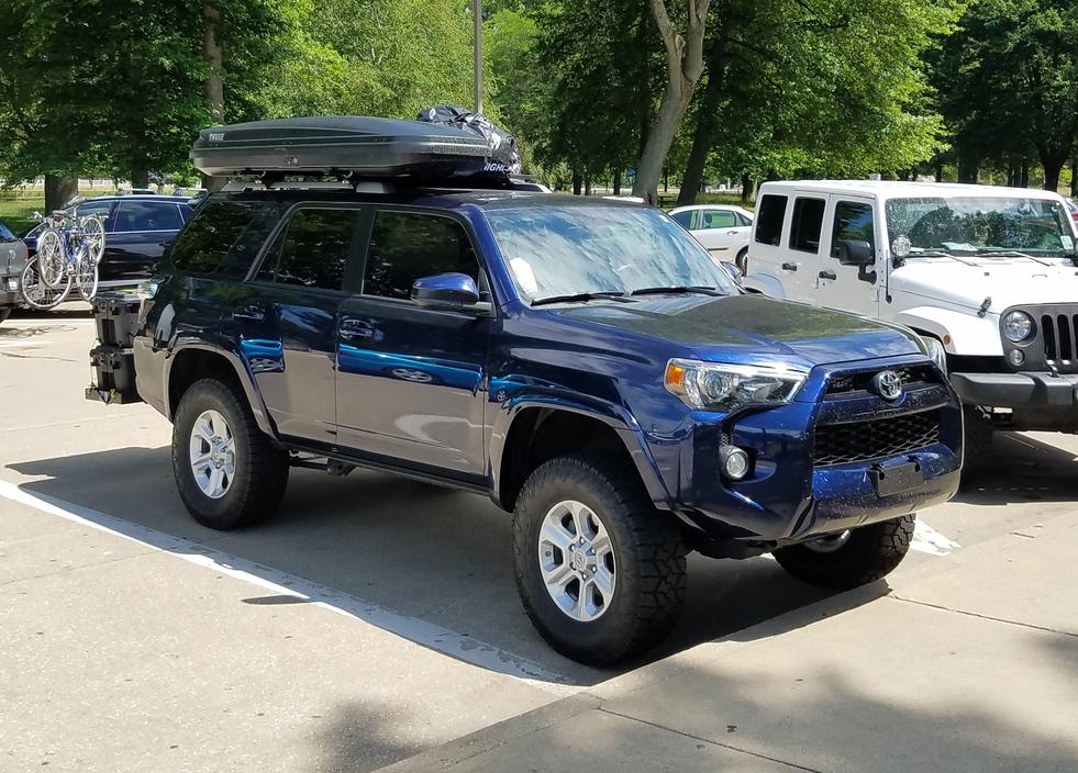

Love everything about your TE, down to the color and stock wheels. Basically what I have, and when/if I lift, I'll be going with JBA's, as well.
Looks like you were able to keep the front mud flaps. What size tires are you running? Did you have to do a body mount chop? Any trimming? Are you running wheel spacers?

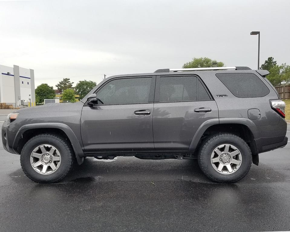

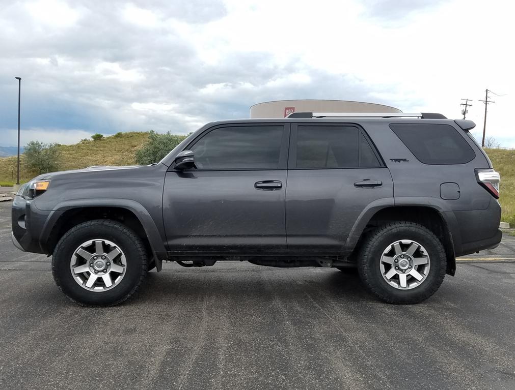

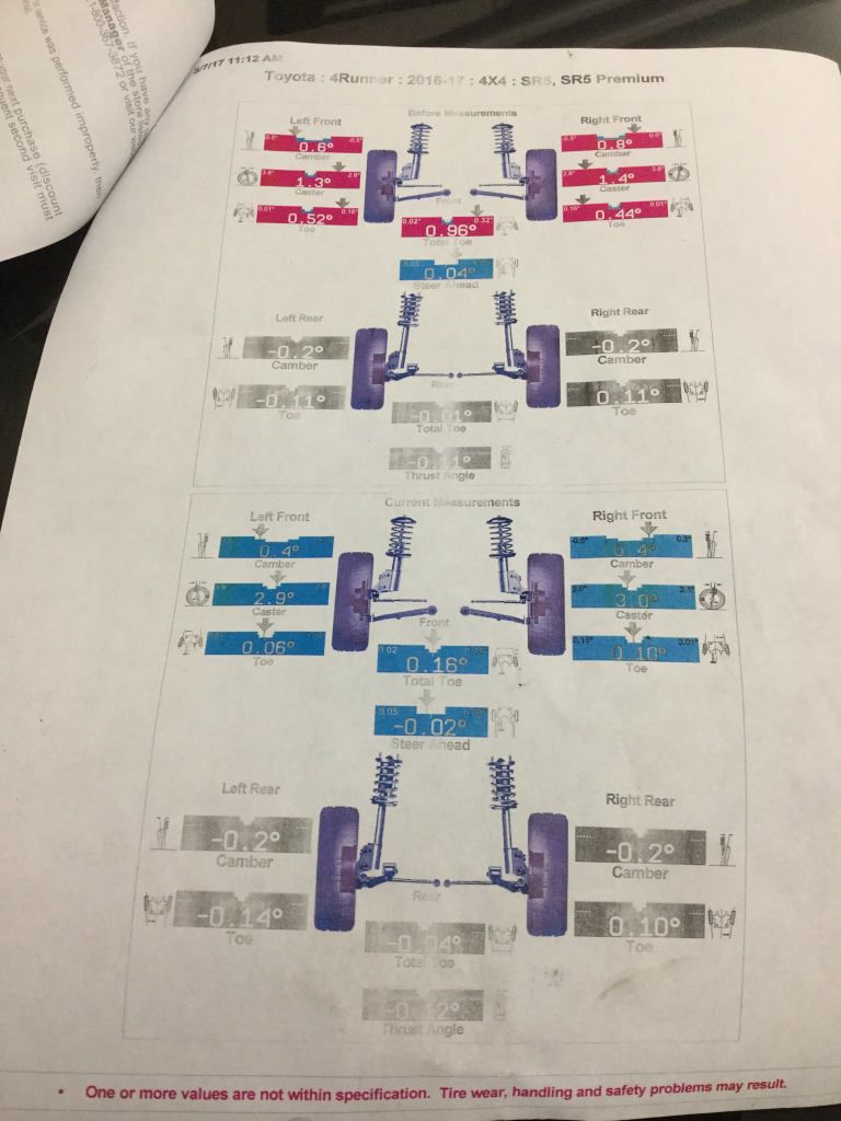

Pre & Post 3/4" spacer (1.5" lift) up front on a 2015 Trail KDSS. Came out almost exactly level, the rear being about an inch higher still. Measurements of body have it exactly level, no negative rake at all!

Living in Colorado I wanted a good AT and snow tire so I went with Duratrac 255/75/17 as a true 32-inch tire. They handle great on the road and during what little off road I have done this summer. No chop or trimming necessary and as they weigh the same as the OEM tires, no hit in mpg. Some complain that they will get noisy as they wear, but as they were almost half the price of KO2's I can just buy new ones at 30K miles if I don't like the noise.

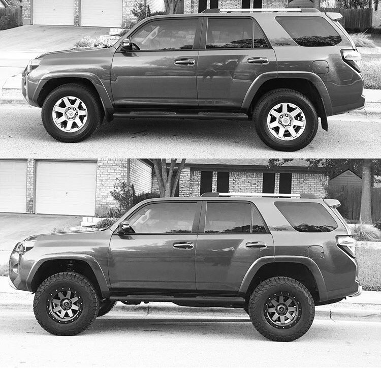

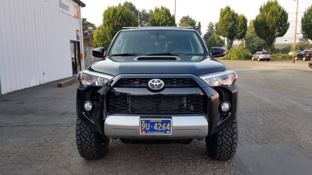

Just did this lift. Here's a before and after. Then another after. Really pleased with how it turned out...[emoji106]
Tire size? I got 285/70r17 with 17x9s. That looks good. I am buying a 2016 SR5 premium on the 26th, and it's going straight into the garage for parts same day!!
