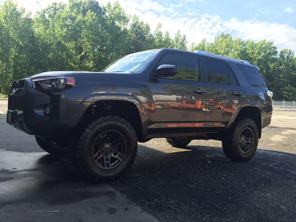

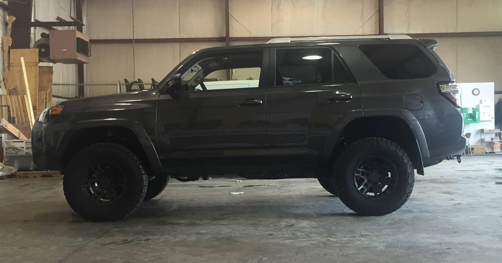

So looking to sell / trade my wheels and tires. Less than 6000 miles on the combo, zero issues, no plugs or patches, just looking for something different. Tires are BFG KO2 and are 285/70/17 Wheels are FN Wheels FX Pro 17x8 Must be local, not looking to ship. Howard County Maryland

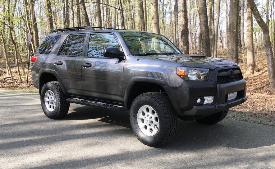

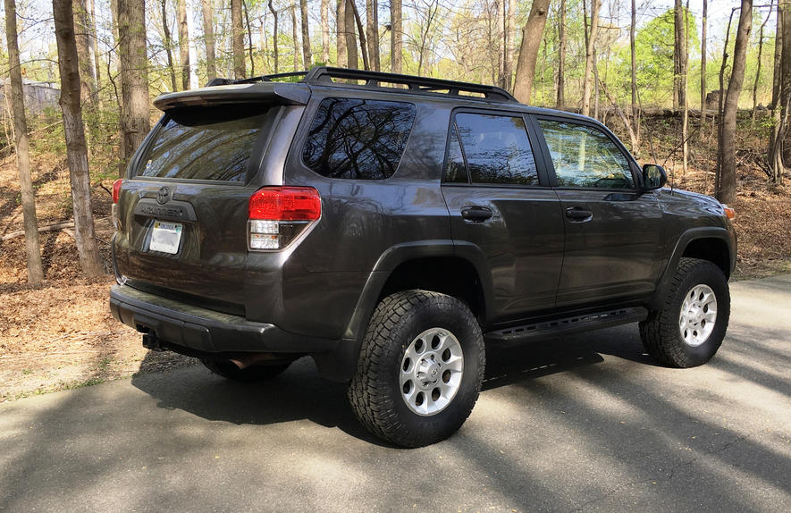

Well, it took me over four years to wear out my stocker 265s. Four years of obsessing over lift options and researching on this site. I finally went with the Toytec Ultimate, Spidertrax spacers, TC UCAs and 285 Toyo Open Country ATs.
Many thanks to everyone here who enabled my OCD :lmao: and helped me to make an educated choice. Thanks also to Scott and Shawn at GTPeace for making it happen!
Looks great Man! How is the ride, power afterwards and of course MPG.

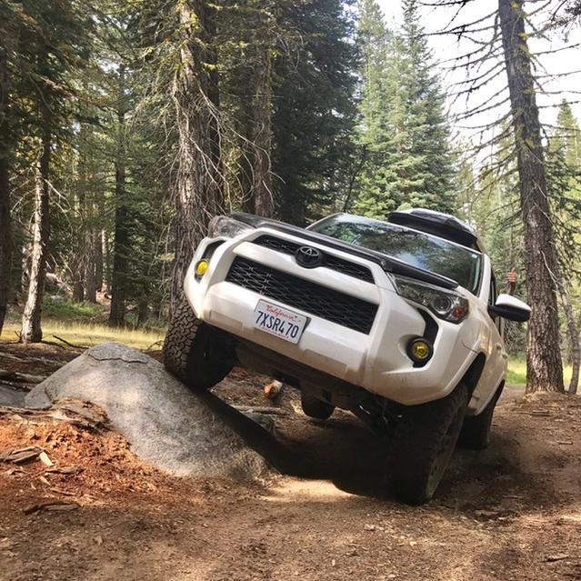

Not the tallest lift but I fit my 285's pretty nicely...

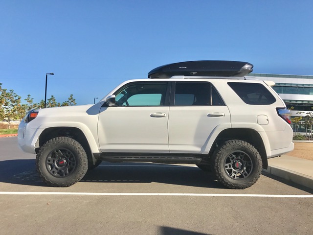

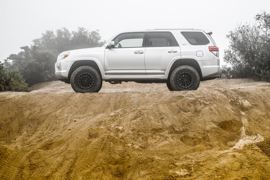

5100 with Toytec springs
Here is my lift spec:
-- Bilstein 5100 front and rear shocks (front shocks using bottom setting, 0 lift)
-- 521600 Toytec Front coils (2.5 inch lift)
-- Toytec "Super flex" rear coil springs (2 inch lift)
-- JBA UCA (caster set at 4)
-- Spidertrax 1.25" wheel spacers
-- Still on 265 K02 tires.
The ride is so better much than stock, it improves the nose dive and body roll, turn in feel sharper and remain close to stock ride quality. You do feel the bump on the road a little more, but not an issue for me.
Took me 8 hrs to install this setup with beer break, but worth every minutes. Highly recommend this setup.

Looks good! I've thought about going this route also, where did you order the 5100s from? Pricing? [MENTION=166021]jc0019[/MENTION]

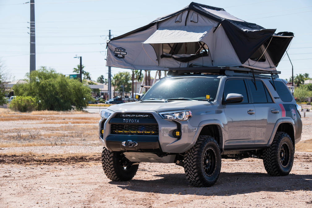

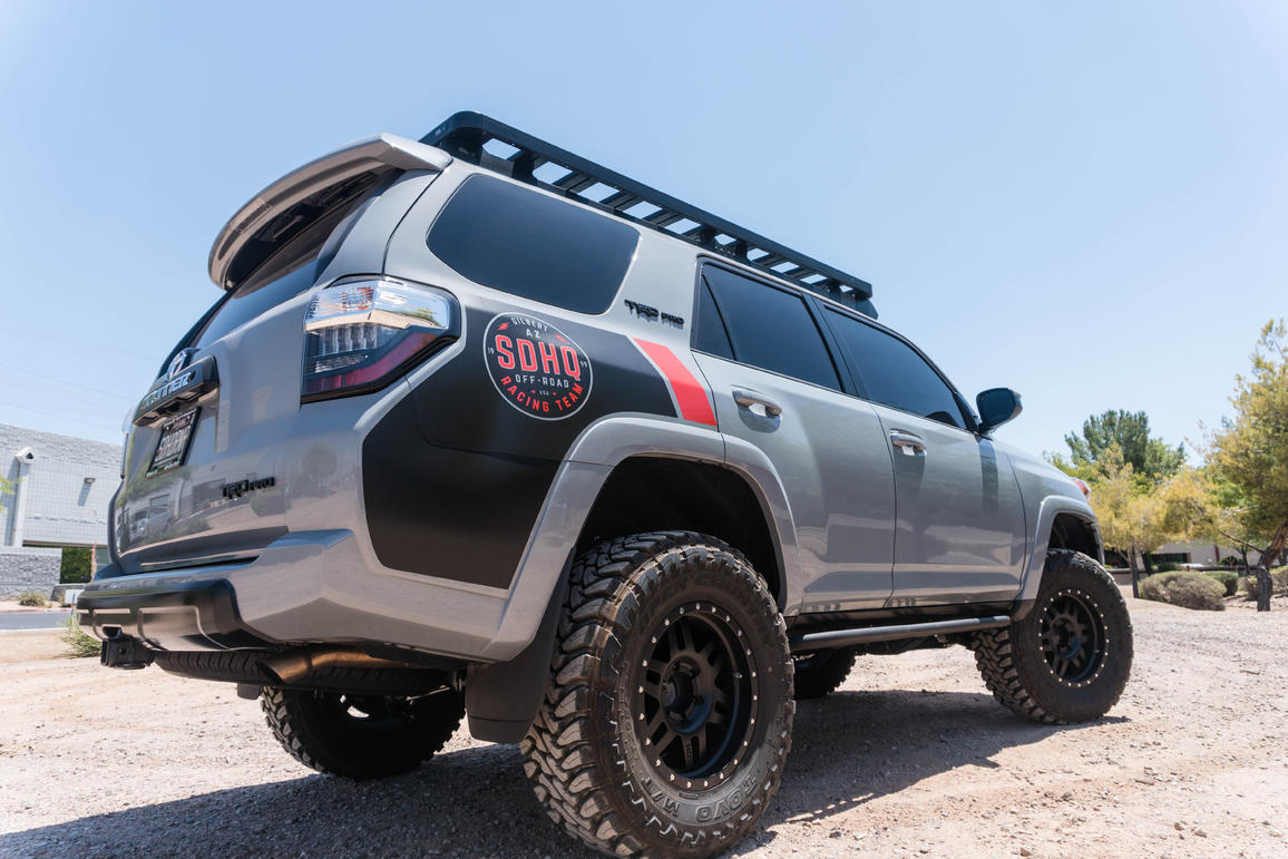

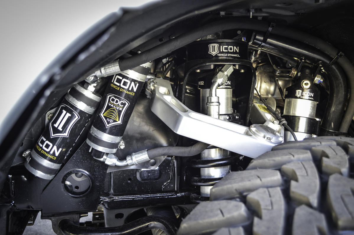

Icon Stage 8 w/ Stage 3 S2 setup
295/70/17 Toyo M/T

Love it! Just ordered my 295 Ridge Grapplers to replace my 285 KO2 tires. Can't wait!
Are you at the 3" mark? If so, did you have to trim or cut? My current wheels are 17x8 with 4.5 backspacing and 0 offset. Thinking about going up to a 17x9 with 4.5 backspacing and -12 offset for a wider more aggressive look but not sure yet.
