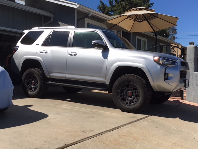

Bilstein 6112 5160 Falken AT3 285/70/17

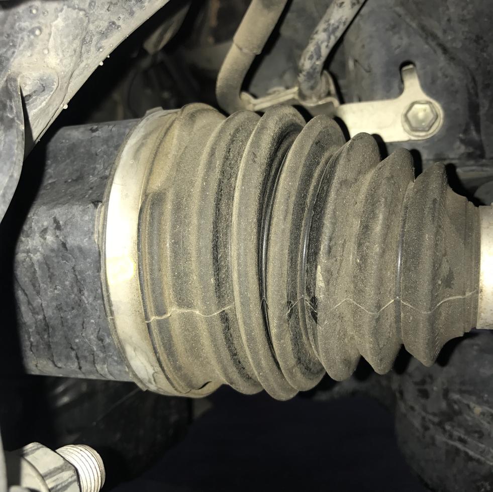

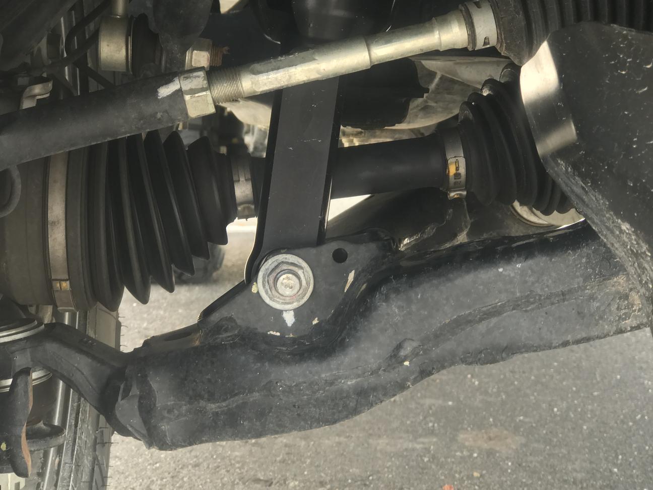

Word, yeah I hear ya, per a PM request heres a Snap of the CV at 4" lift (front) UCAs and Icon Extended Coilover.

That's very odd.... most CV's look worse than that with 2"-2.5" of lift. Yours look almost as if it was stock, yet you claim to have a 4" lift.
eh... its not a claim. I am sitting 4 inches taller than I was stock... Not really much more I can say except maybe my setup worked out well.
if additional measurements or pictures are needed from my factory ride height to now i can provide, but eh... is going to say the same thing yo.
i guess one thing to add is that when i had the coil spacer 4 inch lift with diff drop it was a piece of shit and the cvs would bind and buck at full droop. after the coil over no such issue with either bad looking angle or bind and buck.
I agree i'm at 3" and my CV's are sharper than that. Either way, angles look good. Uniballs IMO absolutely suck. Takes way to much to keep them quiet and they don't last. JBA arms are what i'll be swapping my arms out for in the near future.

I know they're a couple dollars more, but have you looked at the Icon UCA with delta joints? I installed some in my 4Runner and they're re greaseable both in the joint and bushings. Super quiet and got my alignment back into specs.

Can you post pictures of your diff drop kit and part number?

You are totally spot on with the ball joints though! The angles are less than ideal and way off parallel :wacko: have a look lol

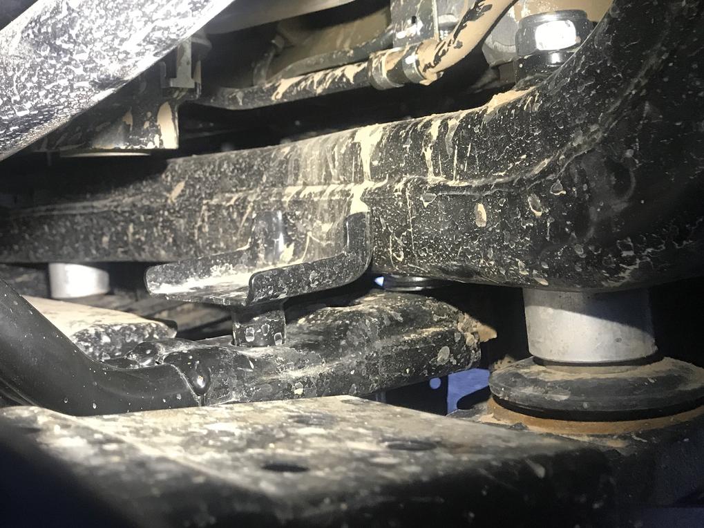

see those silver pucks..
Yeah what homie Shrub1 said lol
Part number. Tuff Country - S10105
I bought this TC 4 inch kit, installed the diff spacer and swapped all my struts to 5100's
After riding around like a tank, no articulation and mad vibrations I decided to take a chance and replace the entire spacer, strut and coil assembly with the icon ext travel. So I've mixed and matched setups which may be why I still have kick ass cv angles. Here is the link to the TC kit. Toyota 4Runner Lift Kits | Tuff Country EZ-Ride
And here is the pic from fromunda :zoom:
Also note the washers for the radiator support to clear the sway bar relo

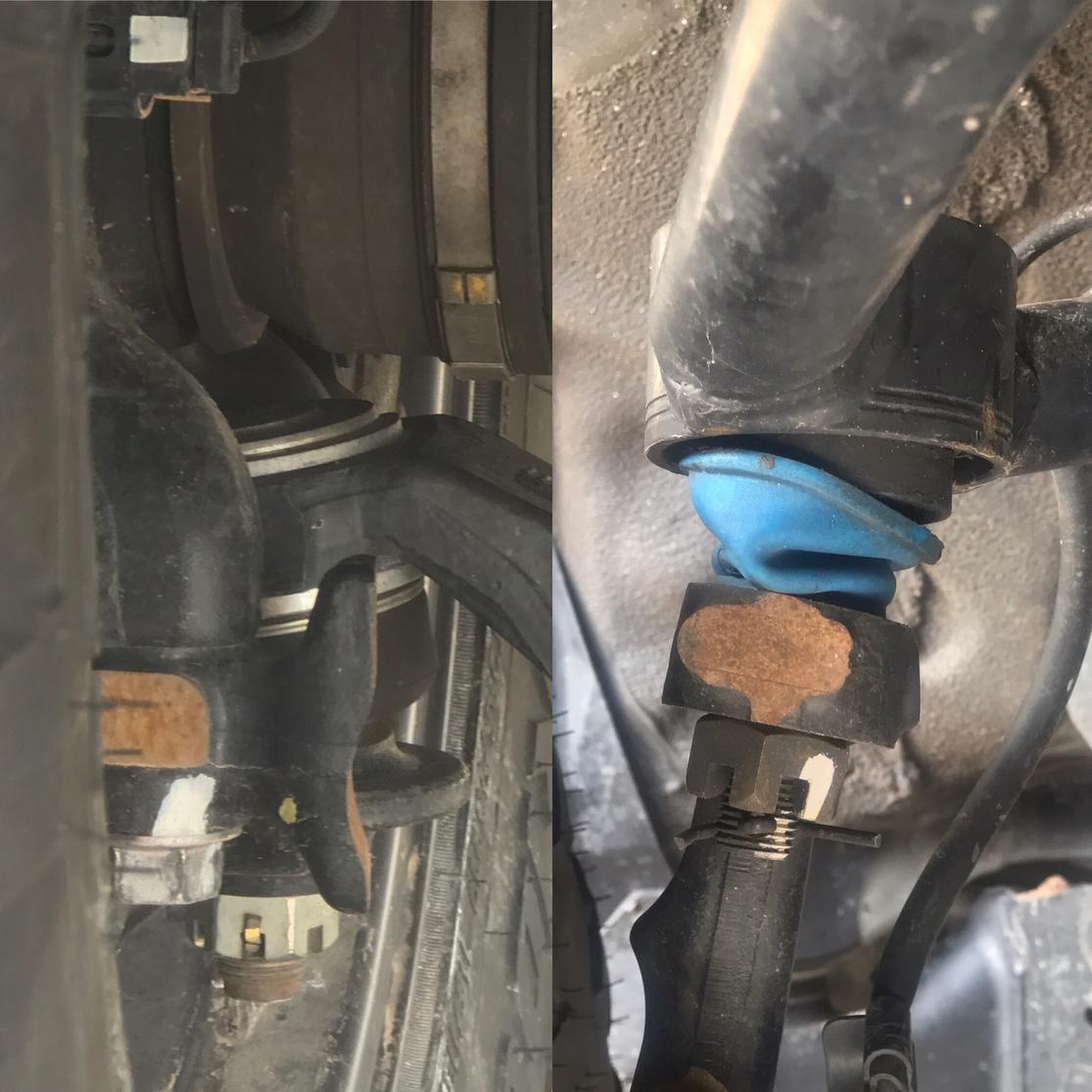

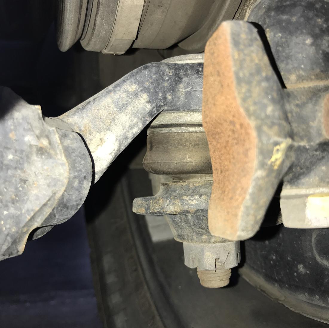

Here are pictures of my set up, I'm at 3 inches of lift and didn't use a diff drop kit. My ball joint boots look perfect and also my CV's. Also included a picture of the delta joints.
