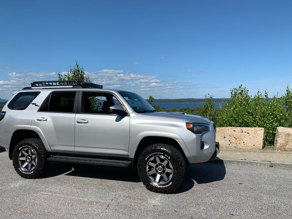

I’m running Dobinsons 2” Lift with Heavy springs up front on BFG KO2 285/70/17’s

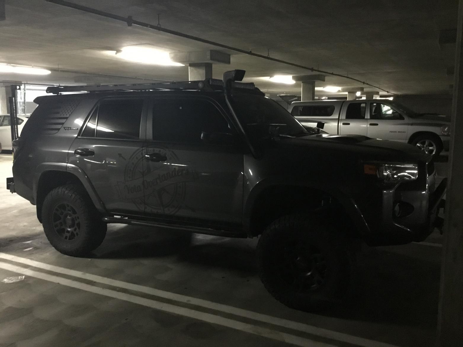

Anyone know how many inches you can go and still fit in a garage with the stock cross bars?
Yeah definitely depends on the garage. I'm lifted 3.5" and on bigger tires and I can drive into my garage WITH the rear gate open. My buddies house I cant even pull in without feeling like I'm gonna shave the paint off the roof (so I don't).
I think my garage door is 96"

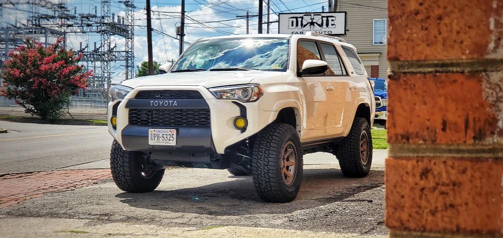

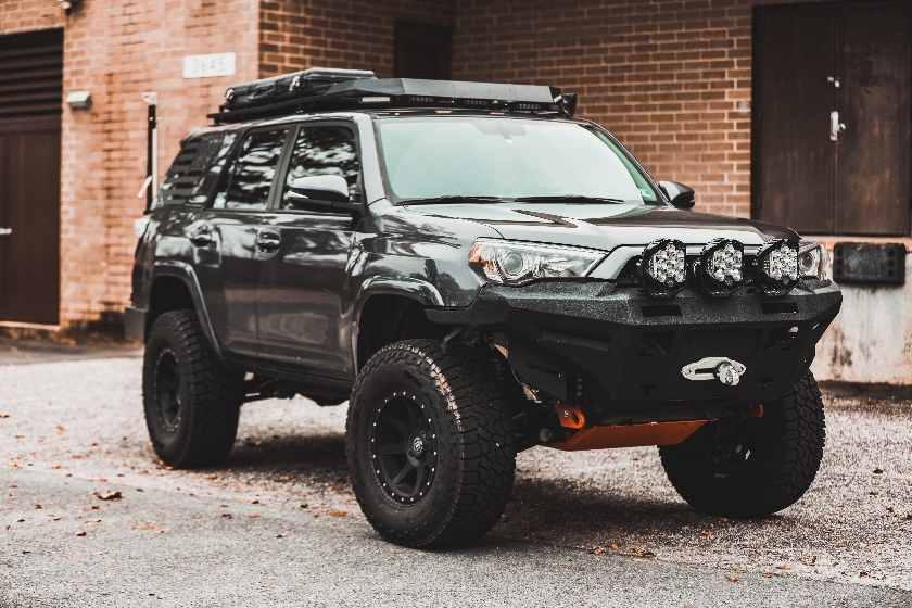

Not the greatest angle, and only 24hrs of settling time, but here's mine...
Dobinsons 300 Front Springs
Dobinsons 574 Long Travel Struts
Dobinsons 327 Rear Springs
Dobinsons 701 Rear Shocks
Diff drop, UCAs, and bumpstops as well; 265/70/17 Wildpeak A/T3Ws
Hey man, whats the red bracket up front? Is that some sort of aftermarket bolt on recovery point?? Who makes it if so? Thanks in advance.
It's the Apex Overland Front Recovery Points
I actually need to get around to cleaning them up and taking some pics as they are no longer on the truck (my Warn Slimline bumper's mounting points occupy the same space)
Awesome, thanks for the quick reply! I need to get something more secure for recovery than the tie downs up front until I get my Victory4x4 Slim bumper. The front loops will do in a pinch but I'm leery under any REAL pulling.

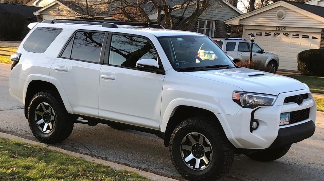

Finally able to post in this thread. Got the Bilstein 5100's on all 4 corners with Wheeler's T1 & T13 coils. Also used the top hat spacer and rear trim packer to level out d/s lean. Tires are 285 Falken Wildpeak. Rides and looks better than expected.

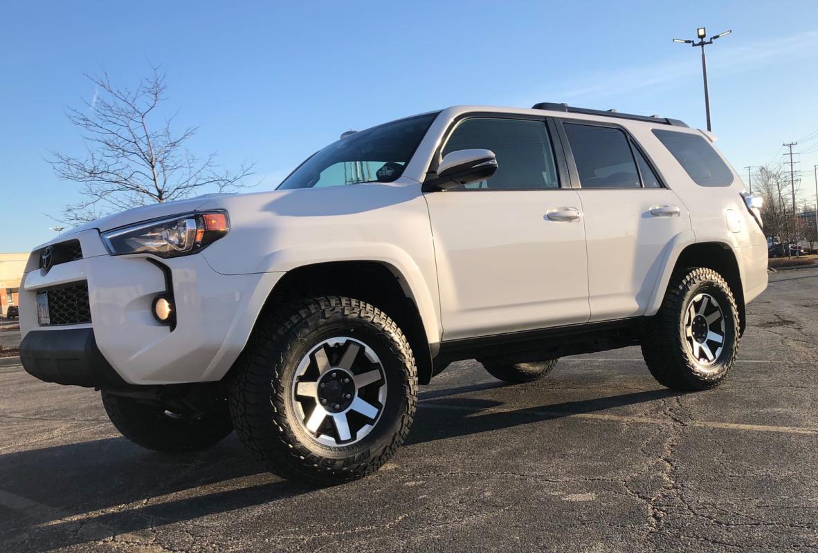

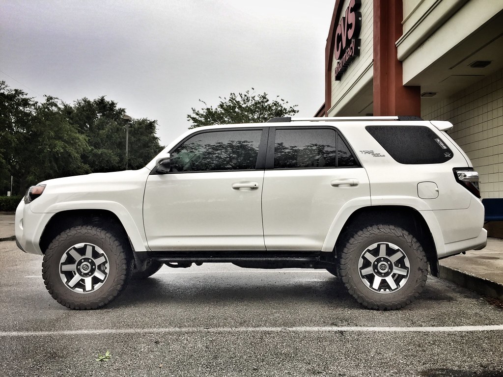

Front - Toytec 112-620 springs and TT TP14 1/4" spacer on drivers side.
Rear - Wheeler's T13 springs and 1/2" Cornfed spacer drivers side.
ETA: Since this is often used for a reference thread by those shopping, I thought I'd post more details...
Tires are 275/70 K02's. Also worth noting, the TT 112-620 front springs are listed as 1.6" for 2010+ T4R, but both I and my buddy (also has a '18 TRD OR) both seem to be getting greater than 2" with them. He's had his for a couple months, and they settled at 2 1/4" on passenger side and 2 1/8" driver side with the TT TP14 1/4" spacer. I expect things to settle out a bit, but here are my measurements...
Pre-lift
Driver F - 35"
Pass F - 35 1/4"
Driver R - 36 3/4"
Pass R - 37 1/8"
Post-lift
Driver F - 37 1/2"
Pass F - 37 3/8"
Driver R - 38 1/4"
Pass R - 38 3/8"
This is a great looking set-up for the OEM+ look!

Looks great. Qs: did you remove or black out the OEM center caps. Looks really good like that. Also which spacer/packer did you install. I've got a bad case of the lean, so looking at all possible solutions. TIA.

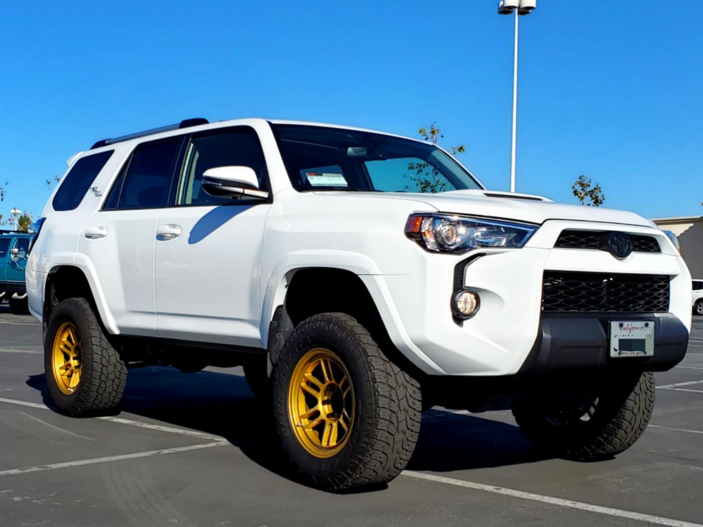

Got the icon Stage 6 installed today. I also ditched the black SCS wheels in place of a new set of Bronze SCS wheels.
For you Icon guys, how are you getting your trucks leveled? Front left and front right and near perfectly level, but my driver rear corner is a full inch lower than the passenger rear corner.
Icon suggested lowering the front passenger corner to bring the driver rear corner up, but 1" seems like a lot to balance that out.
