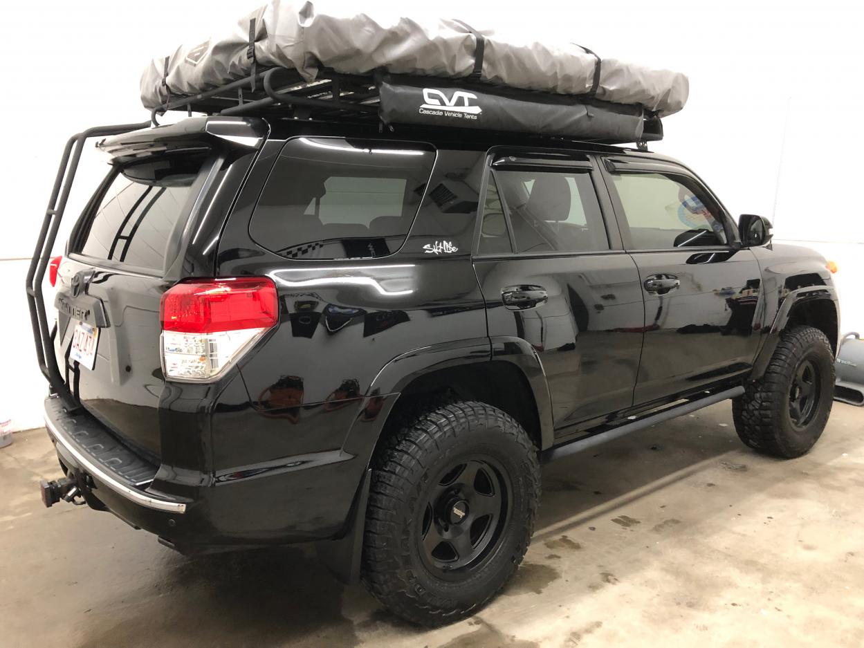

Love your ride. I rarely see that color around town, looks good with the snow and yellow fogs.
Thanks, just added a Prinsu rack and light-bar so it looks a little different now.
