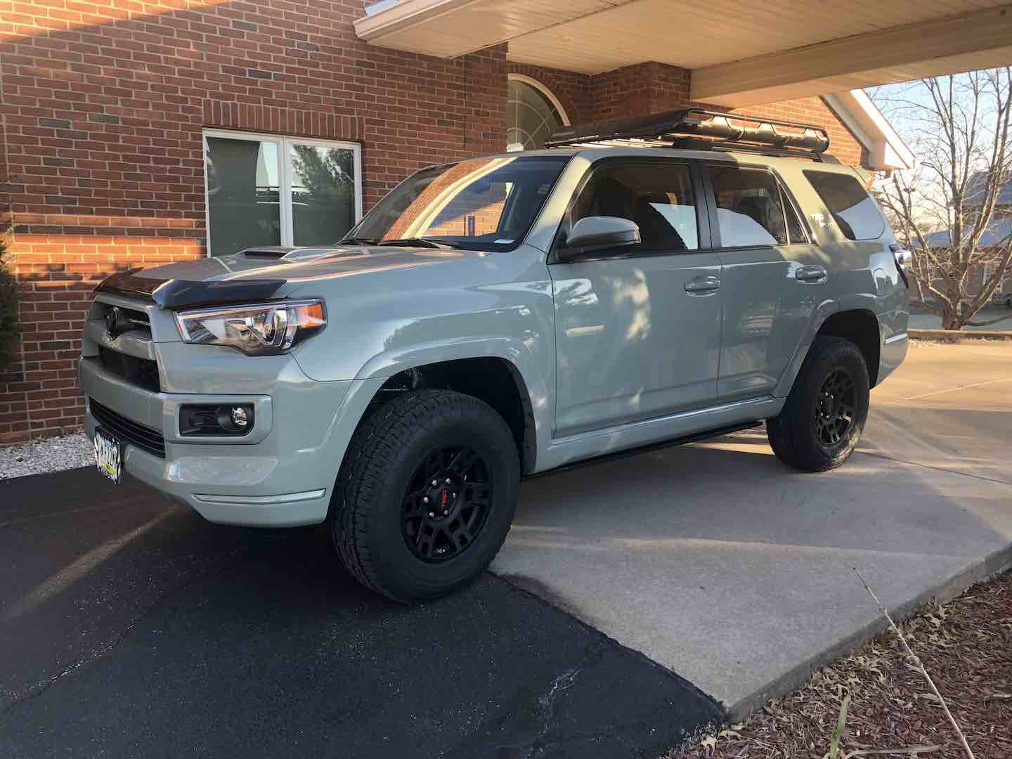

Just got my 2022 TRD Sport in Lunar Rock. Cornfed 1.5F/1R spacer lift; TRD Pro wheels; Bridgestone Dueler Revo2 AT tires (removed the grapplers as they were just too darn loud on the highway; the Duelers are nearly silent); Yakima Off-Grid rack. So far, very happy but I will admit going from AWD (2019 GX460) to the part time 4WD system in winter was a bit of a learning curve of the do's / do not's!

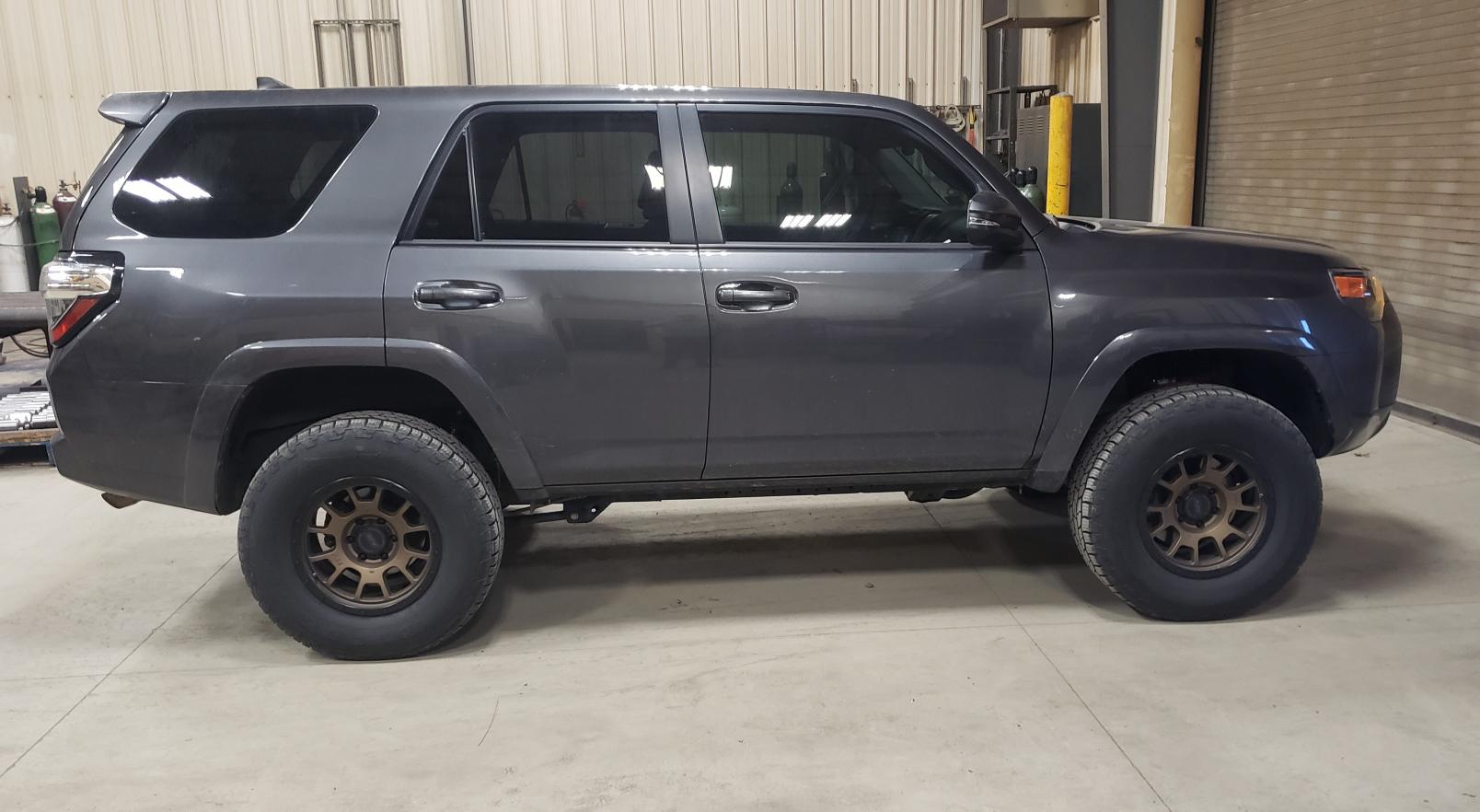

Eibach pro truck struts/shocks, dobinson c59-300 front coils, eibach rear coils, wheelers .25" and .5" top hat spacers, jba uca, superbumps. This lift netted just about 2.5" in the front and 1.25" rear.
This setup is great, rides amazing imo, firmed it up a little, still rides plush though. Nose drive and body roll is not nearly as noticeable now. I'm still debating about getting dobinson rear coils, the eibachs just seem a bit to soft. I'm excited to finish up the build and hit the trails

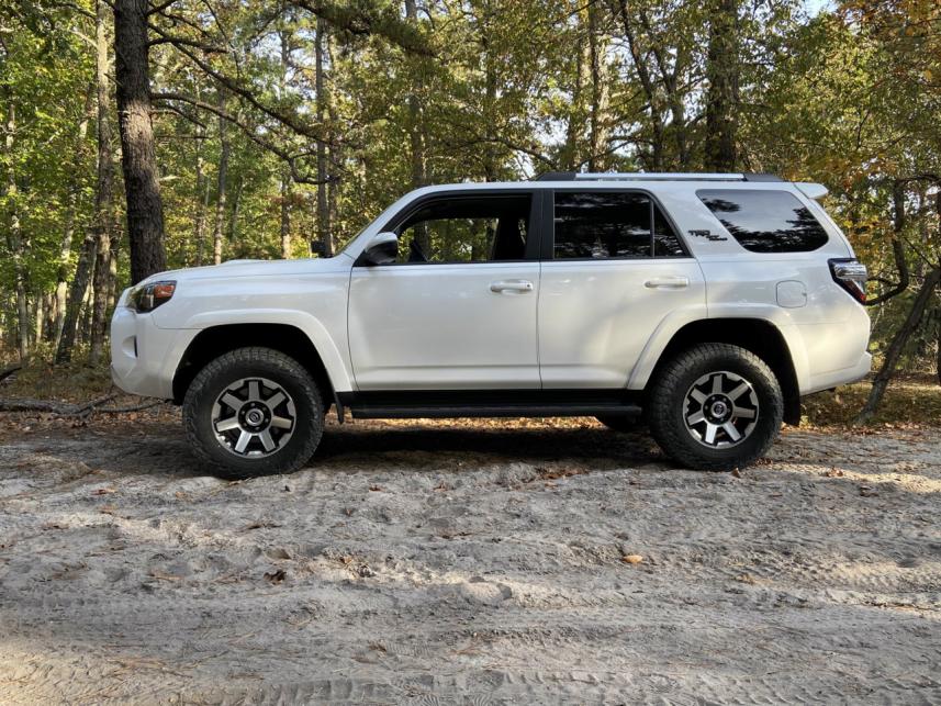

After 6 years I finally lifted my 2016 TEP. Bilstein 6112/5100's (3/2) with SPC's and Icon rear coils.

I’m planning on installing this same set up. Did you add spacers to get to 3 in the front Or are you at top setting on the 6112s? Also, what size tires do you have in this pic?
I am set to circlip #7 position on the 6112's. It rides well! The tires are 285/70R17's.

Why Dobinsons front coils and everything else Eibach?

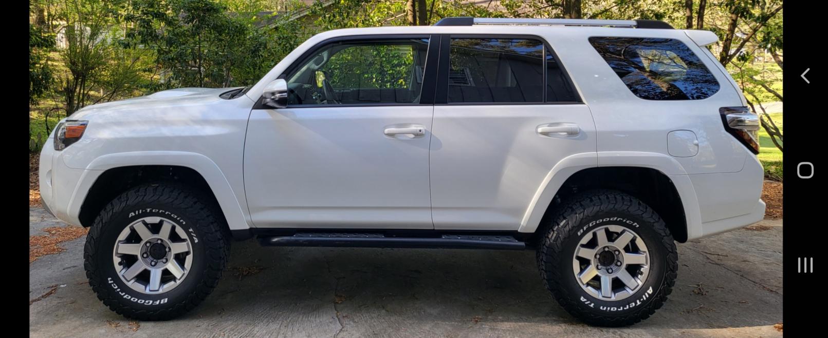

Bilstein 6112s at clip 6/4 and Bilstein 1.5" rear springs with 5100s. Cooper AT3 255/75

Eibach front coils are like 620lbs were the dobinsons are 585lbs. I don't plan on adding a winch and I wanted a softer ride. Just the opposite with the rear the dobisons are 220lb and the eibachs are 205lb. I emails pretty much every manufacturer to find a great setup for my build
