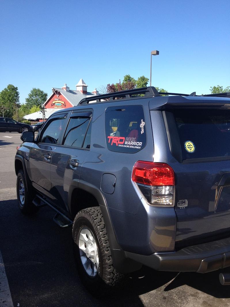

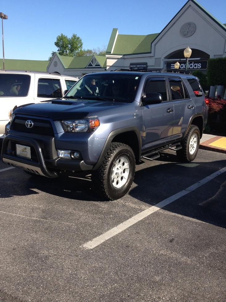

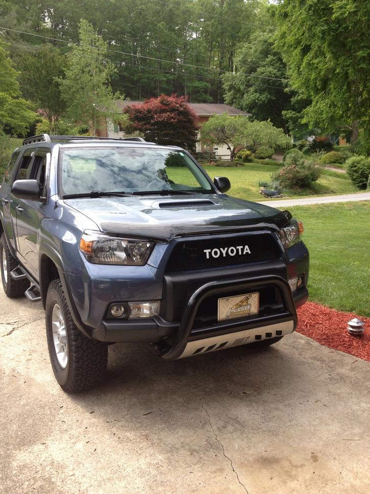

Bad pics, I know.... but thought I would upload anyway with new stubby antenna, front hood guard, and stubby antenna, also added TRD logo on rear windows..

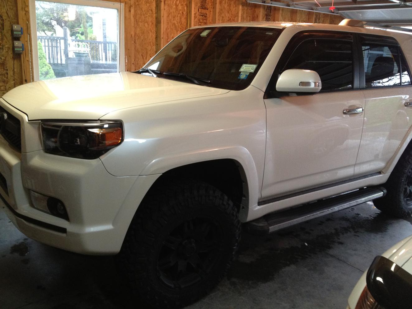

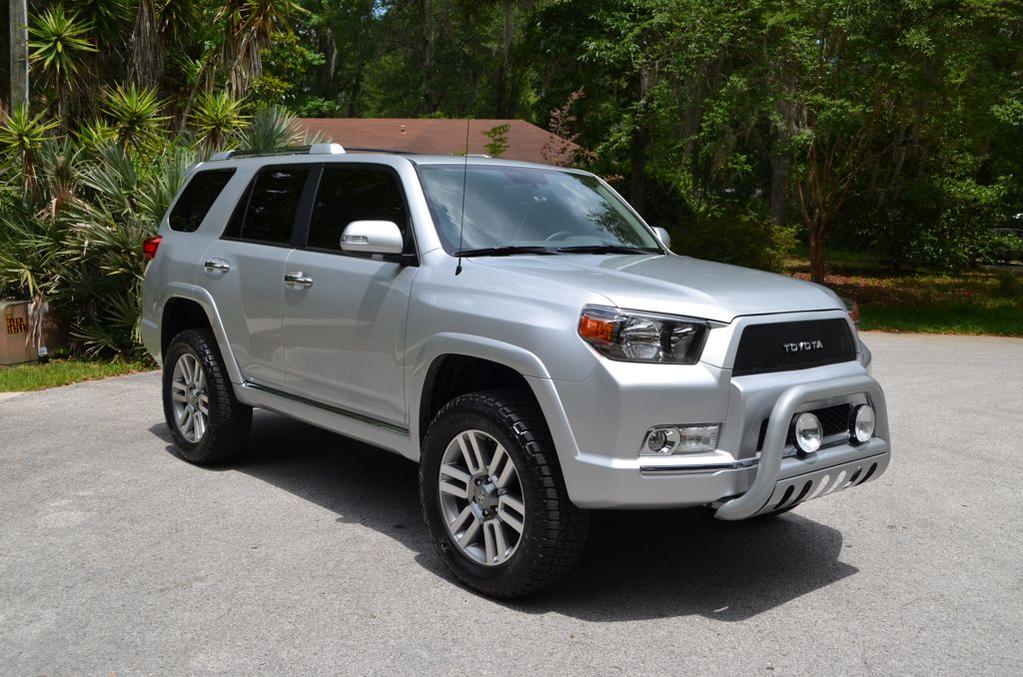

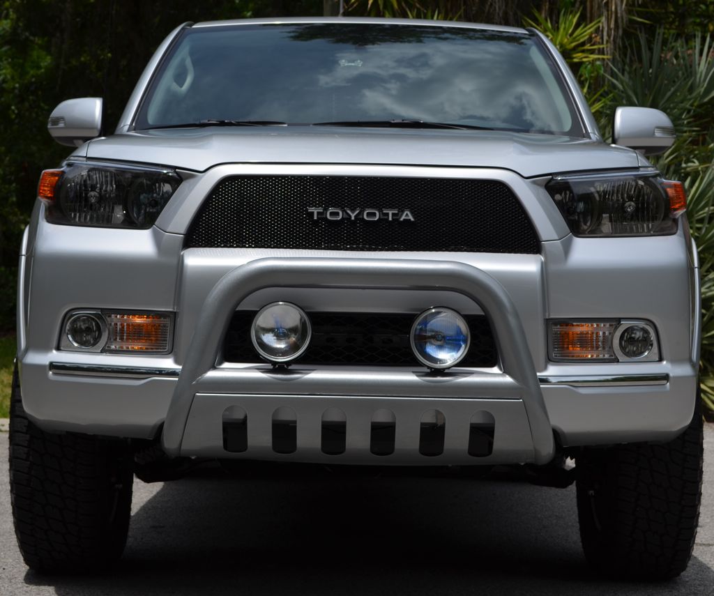

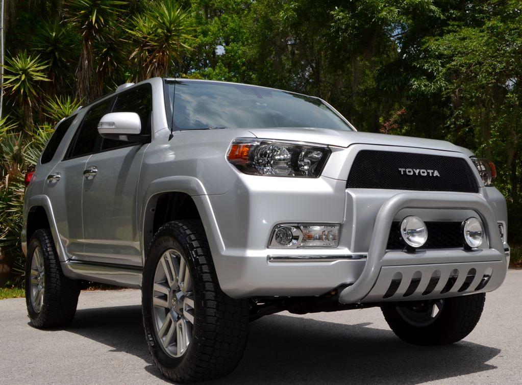

After looking at all your gorgeous lifted 4Runners I had to do mine. Here is my lifted Blizzard Pearl 2010 LE. It has a 3" Daystar spacer kit. 18x9 Ultra Guantlet wheels, Nitto Trails 285x65x18.
We took off the factory running boards (no they are not for sale) and also had to trim a fair amount of inner fenders for the tires to clear and the control arm is just about touching the tire but not quite. I did the spacer kit instead of a suspension lift because I use my truck mostly on paved roads and I like the mushy factory ride. I had done a suspension kit on my 4th gen and while it was awesome, I couldn't drink my coffee without wearing it! :beer:
Anyhoo, I hope you enjoy the pics and maybe inspire some of you to lift your Blizzard Pearls.

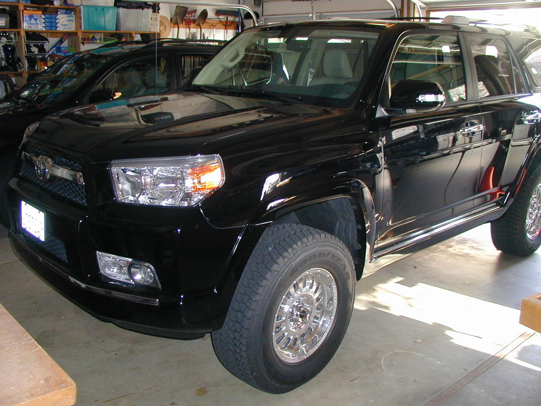

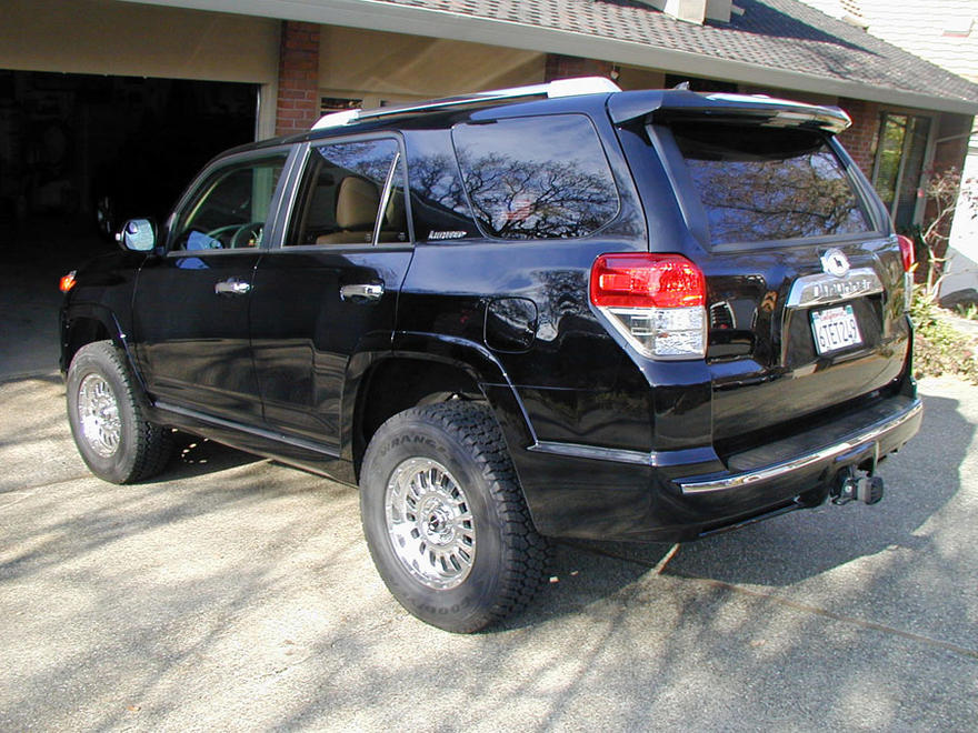

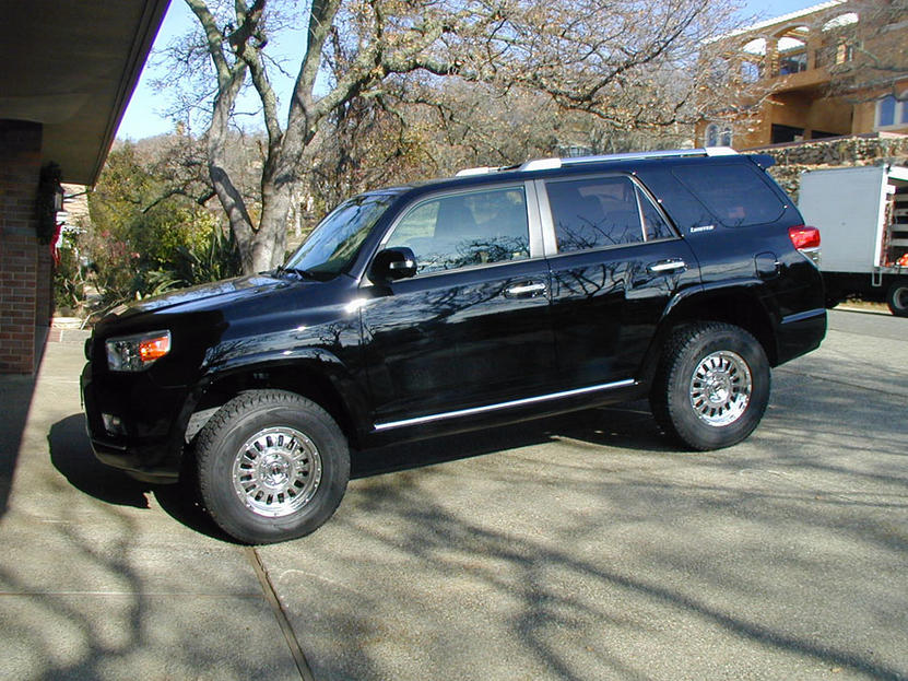

Daystar 2.5"/1" lift (#KT09134BK), Centerline 17"x8" Wolverine wheels, Goodyear Wrangler Silent Armour tires P275/70R17.

Looks great. I was think about BFG 285s in load D. But the 275 Es are better fit. Question I'd like to add front 5100 at 1.75. Is there a rear spacer 3/4 of an inch for rears our there?
I had cornfed make me a custom .75 inch spacer. He shipped it out the same day and I got it two days later. Great quality.

Hey Maintz I was looking to install the exact Daystar lift. How was the install? Did you do it yourself, bring it somewhere? Any advice post-lift? Thanks!! :thanks:

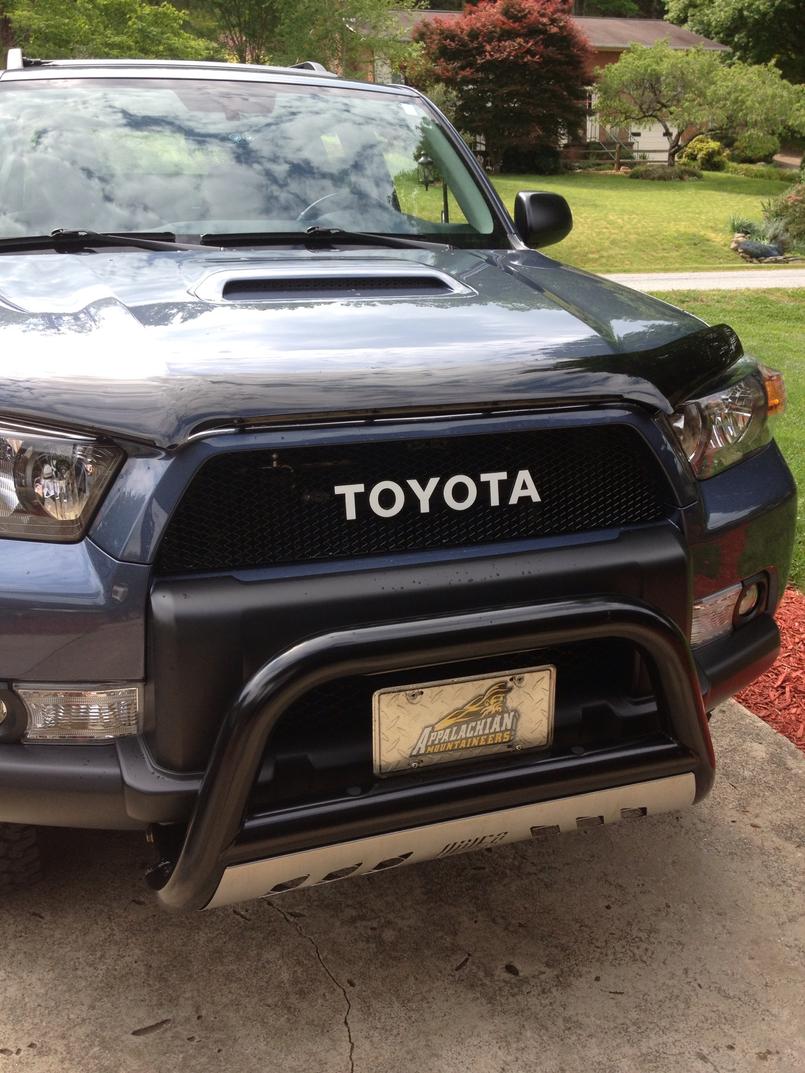

Satoshi Grille Mod Complete on Shoreline Blue '11 Trail Ed

I had my local BigOTires install,... they have a couple of good mechanics (and a lift). Be careful to NOT disconnect any component on the front shocks (XTreas system), as you will discharge the shocks and even the dealer can't recharge them! This is why I went with a spacer kit rather than a lift kit,... too expensive for a truck that probably won't see rough terrain.
I put on Centerline wheels, 17x8 (1" wider than stock), and in hindsight, should have changed the offset to move them out slightly. The tires are 275R70, and I do have a minor rub with a hard crank. I'll modify the wheelwell eventually.
I experience some soft "clunking" sounds on bumpy surfaces now and then, but I'm not sure if that was pre-existing or not.
I do like the looks with the lift, and I'm rid of the "gangsta" OEM 20" wheels and skinny tires.
Hope that helps!

UFG8R Runner: that looks great. i never liked those ltd. rims on the stock tires but with some bigger rubber on there they look damn good
