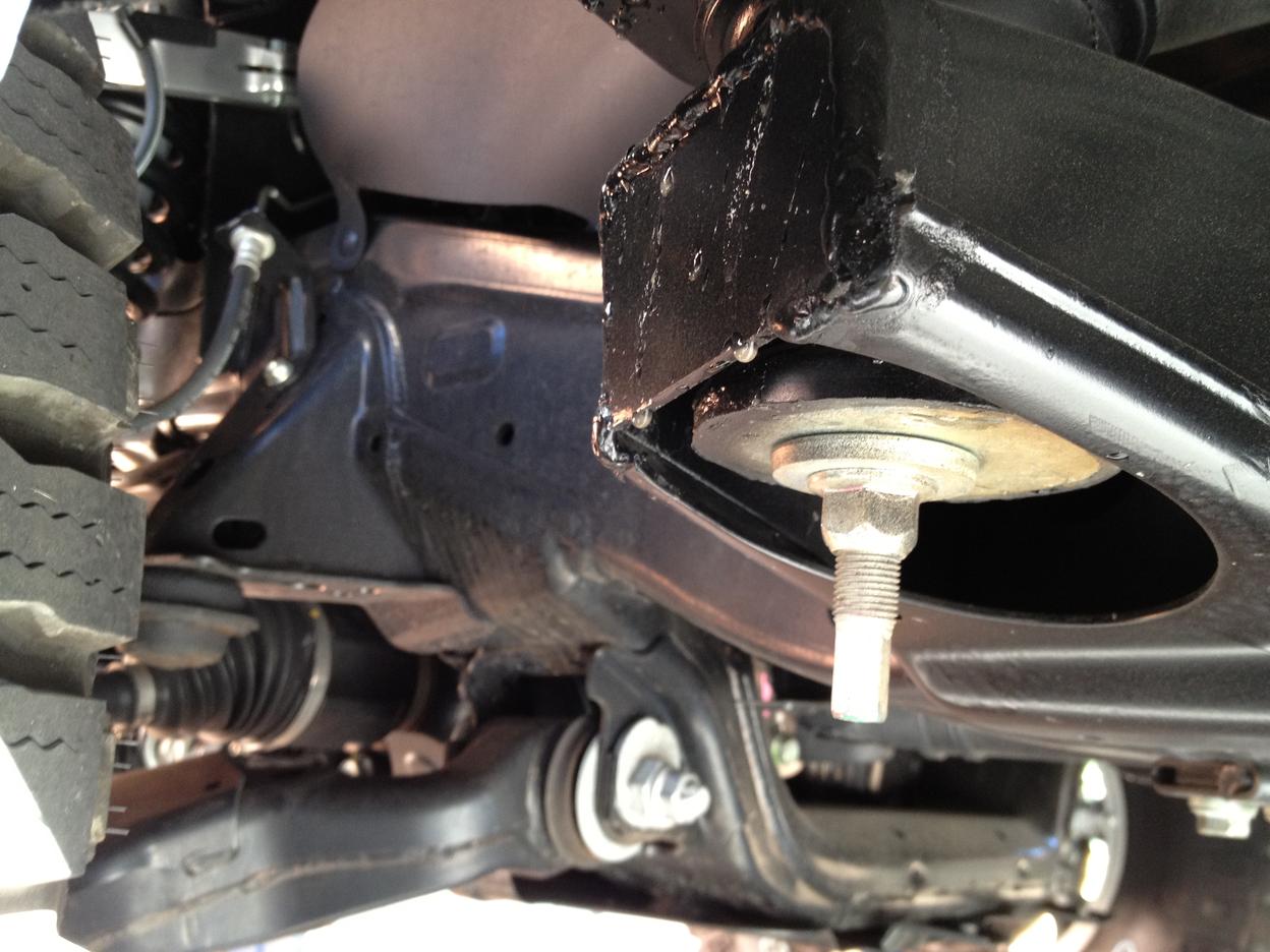

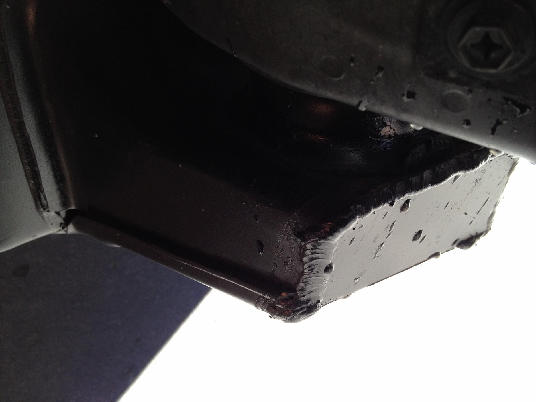

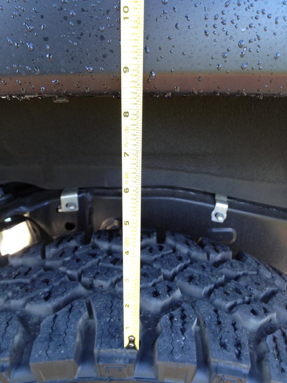

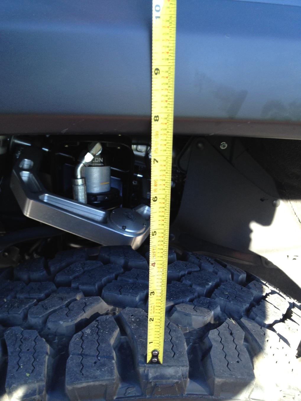

After looking for what appeared to be level ground, it looks like I achieved a little over 8 inches in the rear and 7.5 inches in the front. I am running LT285/70R17 Duratracs. I also trimmed back the body mounts as I was rubbing when fully chocked with some compression. Now I am far from ever rubbing no matter how hard I push it.
See the pics below

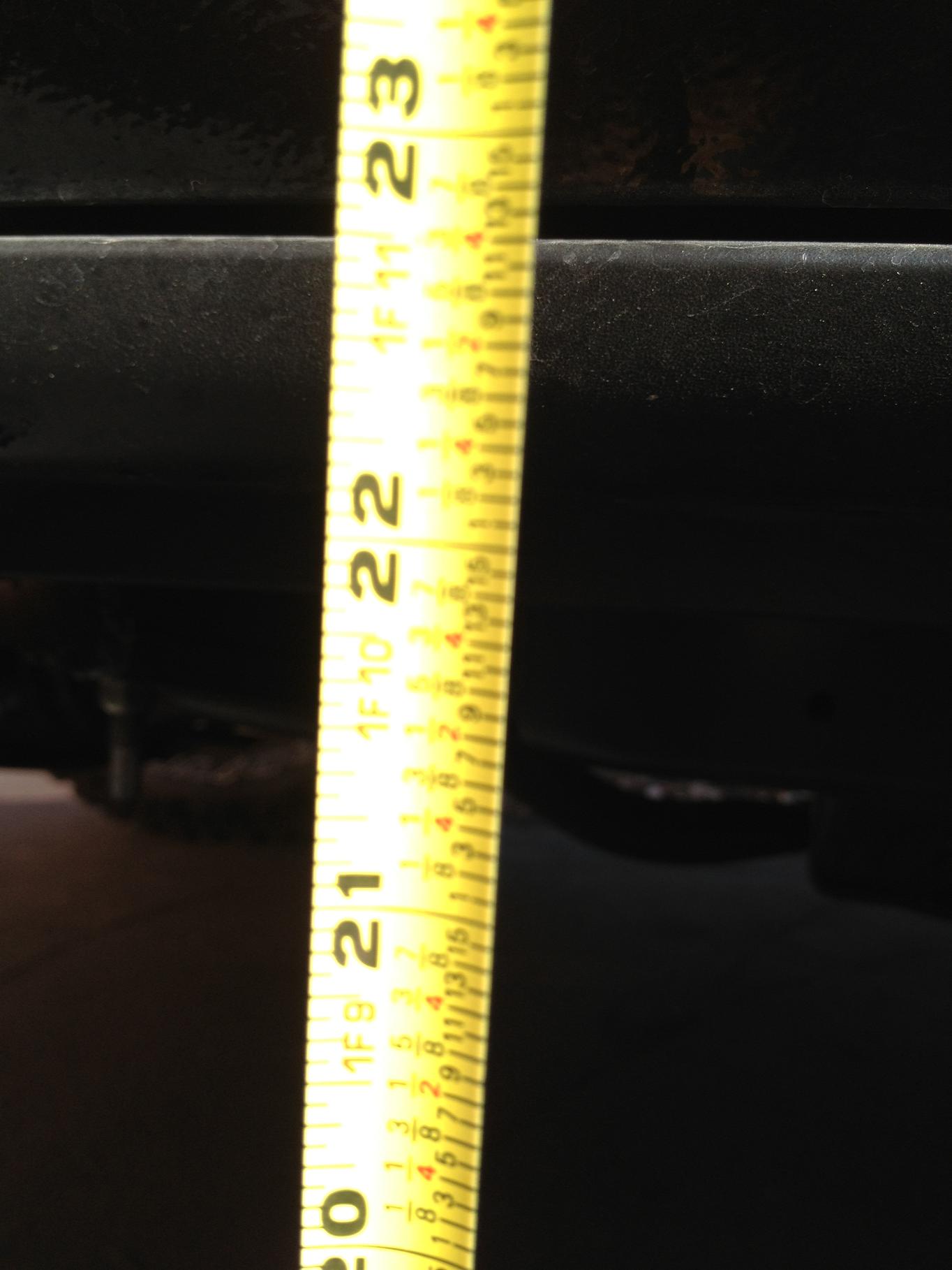

those measurements don't signify the amount of lift you achieved, just the space between your tire and the flare.
You should have measured from the ground to the center of the fender, pre-lift and then post-lift to see how much lift you achieved.

Yup pre & post lift from ground to fender is the way to measure. When you said you trimmed unnecessary body mount I guess you meant it :lmao:

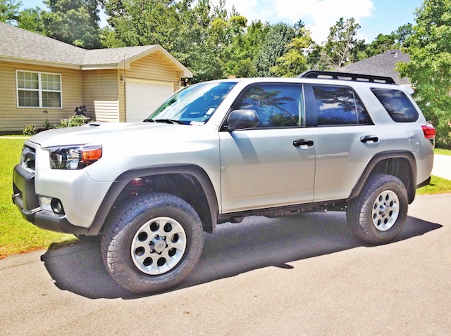

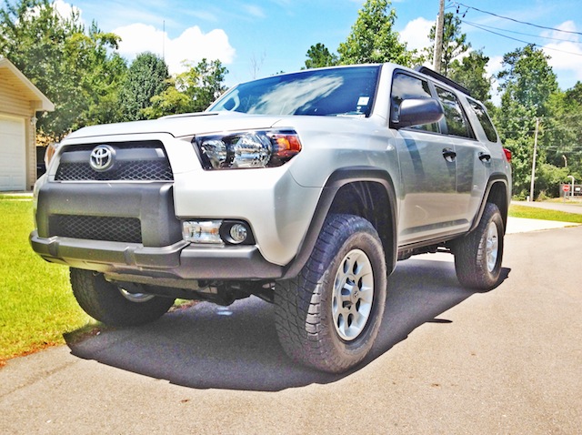

Its done. Staying with rims until I find something I really cant live without. Had to use some filters to dumb down the sun.

Looks good :thunb3:

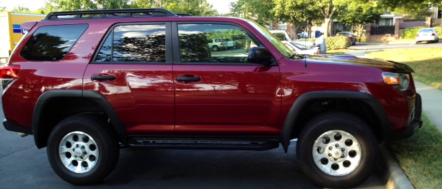

Just don't make fun of my tires
[email protected]" w/ OME 895E
Tires coming. Don't make fun of my Salsa Red shopping cart.
High-Tech Auto in Chantilly, VA was supremely helpful with advice, install, loaner vehicle, more advice. Many thanks to Bobby.

Salsa Red is an AWESOME color!! Wish they offered it on the Limited. Truck looks great.:thumb3:
Gonna tint the fronts??
