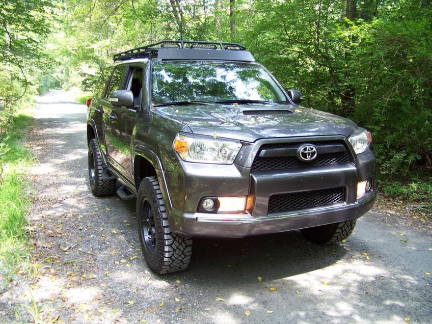

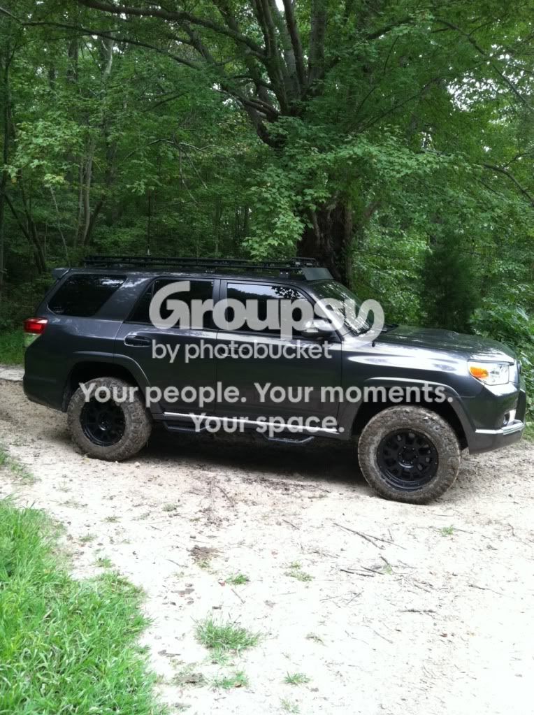

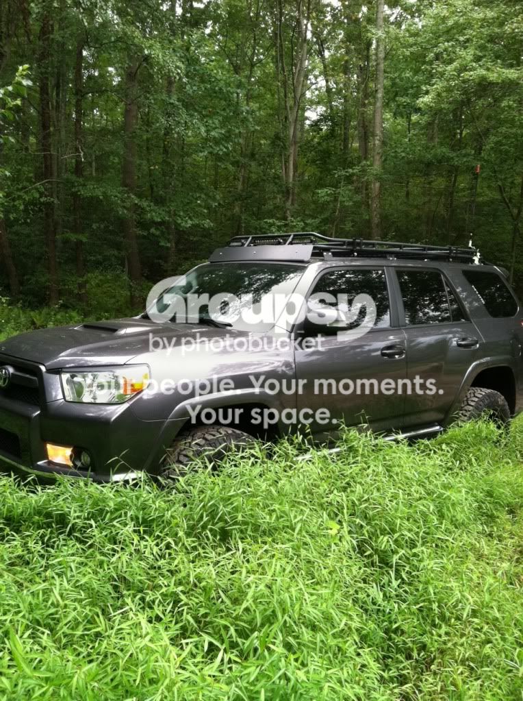

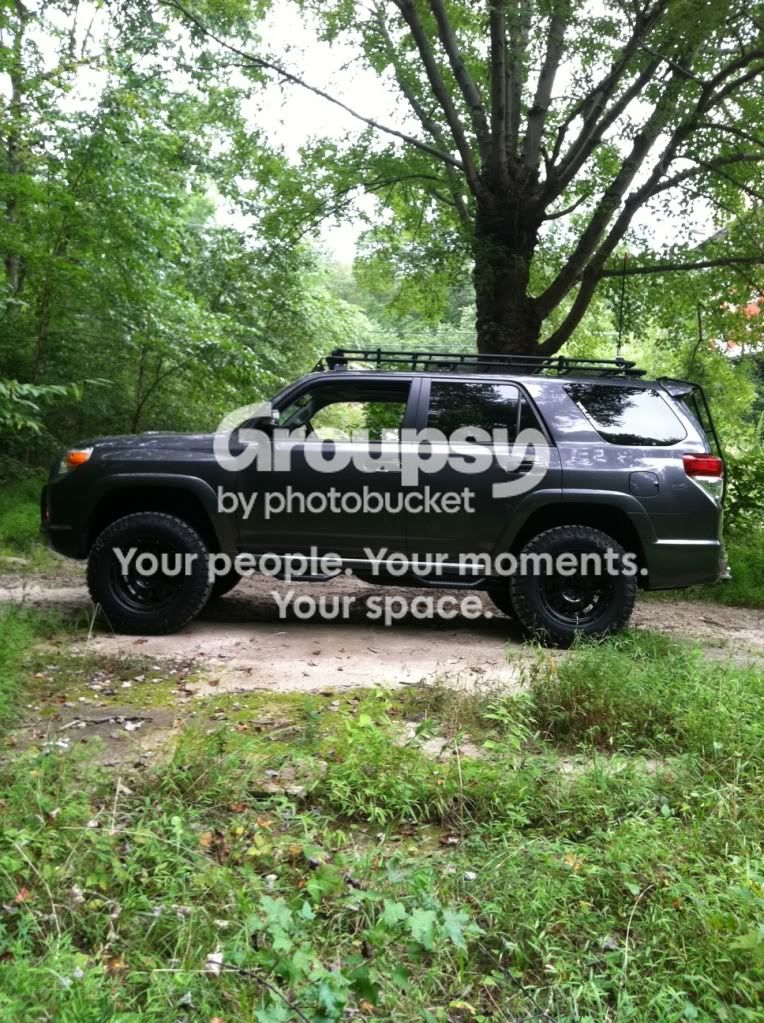

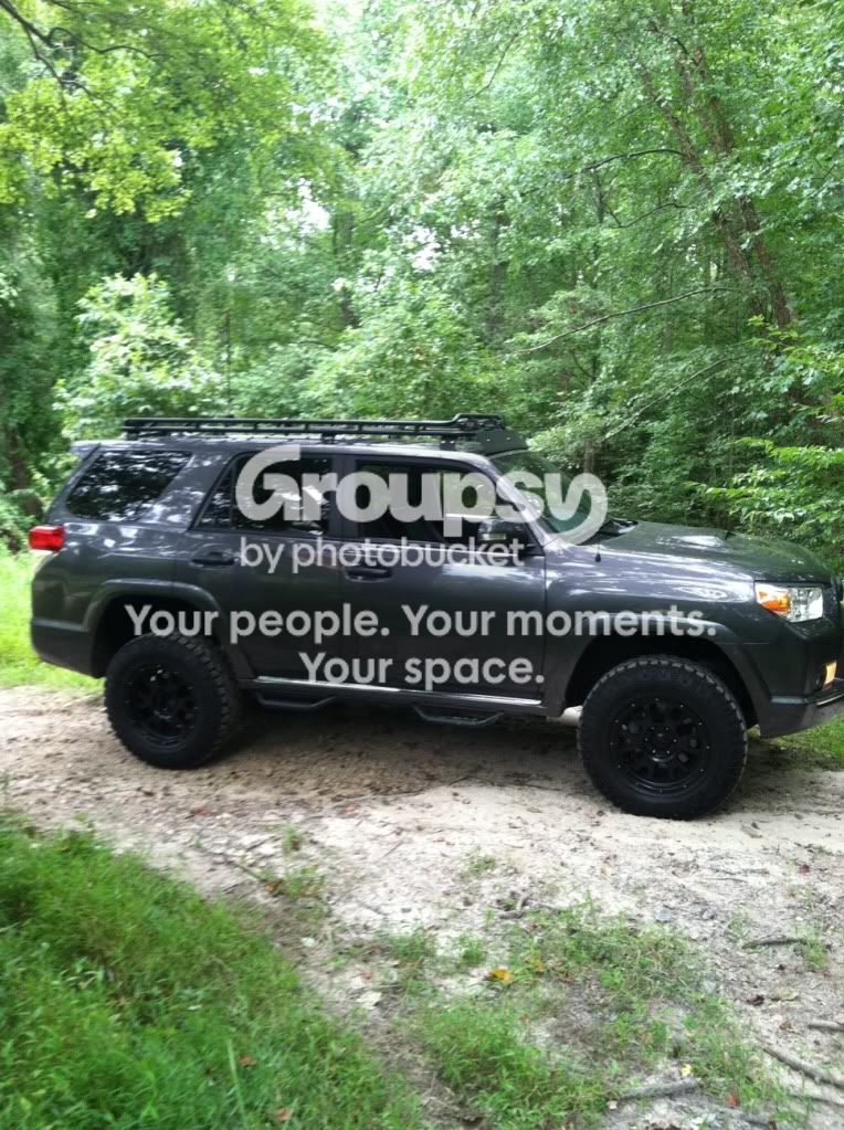

Looks like you didn't make it too far off the road, I think I spy a house in the upper right hand corner :redface:
So is it my eyes or does the back actually seem to be showing some reverse rake now that they've settled? Did you have a lot of junk in the trunk, lol.
LOL- It's just a little dirt road off the main I found on the way home from work...
There is no reverse rake, just the way it was sitting. The 'Runner now has a slight forward rake- just about the same stance it had with the front spacer, but now everything is higher up!

lol, yeah I just noticed that after looking at the other pictures. Looking at all your pictures is killing me, I CANNOT WAIT to get my damn lift on!! Just need my back to hurry up and stop hurting so I can get crackin' :(

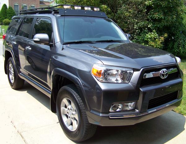

This won't help then...seems like just yesterday I thought this looked soooo good! LOL
P.S.= Good luck with the back buddy.

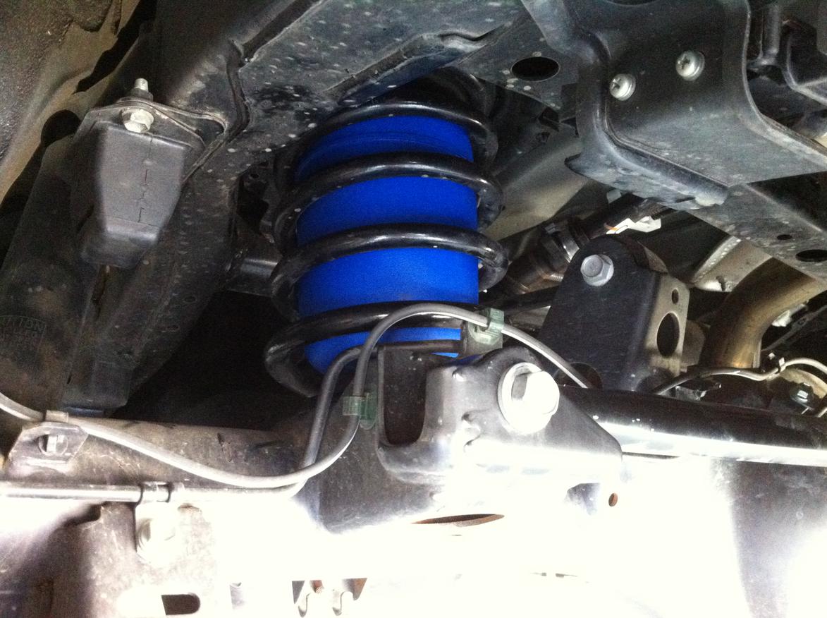

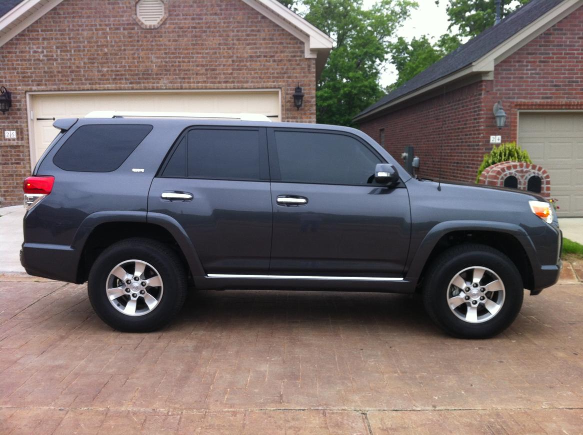

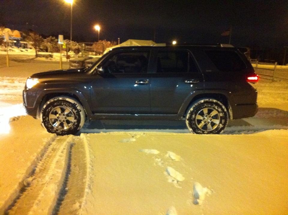

Not too much of a lift but I thought it was worth sharing just for the hell of it.
This is my wifes Mag Gray 2013 4runner SR5 premium 4wd.
I added the a toytec top spacer to get the nose up and firestone ride rite air bags for hauling whatever.
Couldn't go with the lift cuz the wife was preggers and she would have had a hard time getting in and out of it. She doesn't like running boards a whole lot.
But she loves the look of her 4runner. Now all she needs is some meatier tires and spidertraxx spacers and she will be happy.
snow is stock photo and the other side shot is after the spacer and bags.

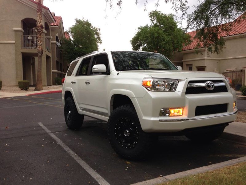

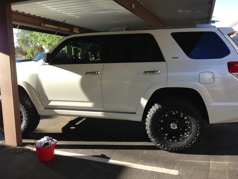

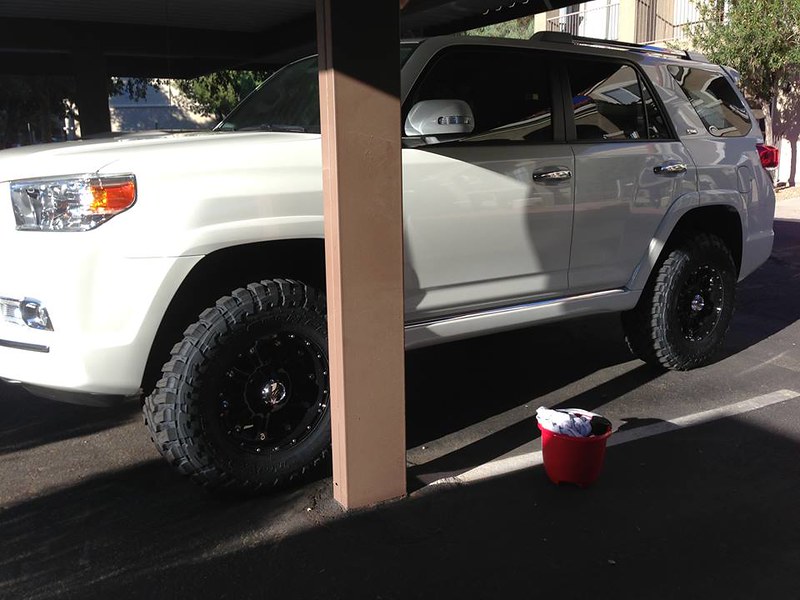

Bilstein 5100s all around. Icon coils in rear. Goodyear Duratrac 285 70 R17. Diff drop. Did NOT replace UCAs. Little high in the rear right now
Looks good! What setting did you go with on the fronts? I agree with Stiffy, bring the front up a notch. :boink:
not sure what happened with the pix. weird. up now I think. curious as to what the sr5 had to do here for mods fitting their rock sliders on.
The rear has settled a little over the last 2 weeks. I'm not sure about the settings in the front, but the shop owner (old college roommate) told me the lift is 2.25". He would not go higher and warrantee everything. He said any higher without replacing UCAs and other expensive components would result in CV and ball joint issues. Plus, I would not be able to get it aligned properly (having a hard enough time with that as it is...) Thanks for the props. Looking forward to more mods.
Constantly I read posts saying I set my Bilsteins 5100s at 2.25"... Am I wrong in thinking that the only settings on the front 5100s are 0.85", 0.75" & 2.5"?
