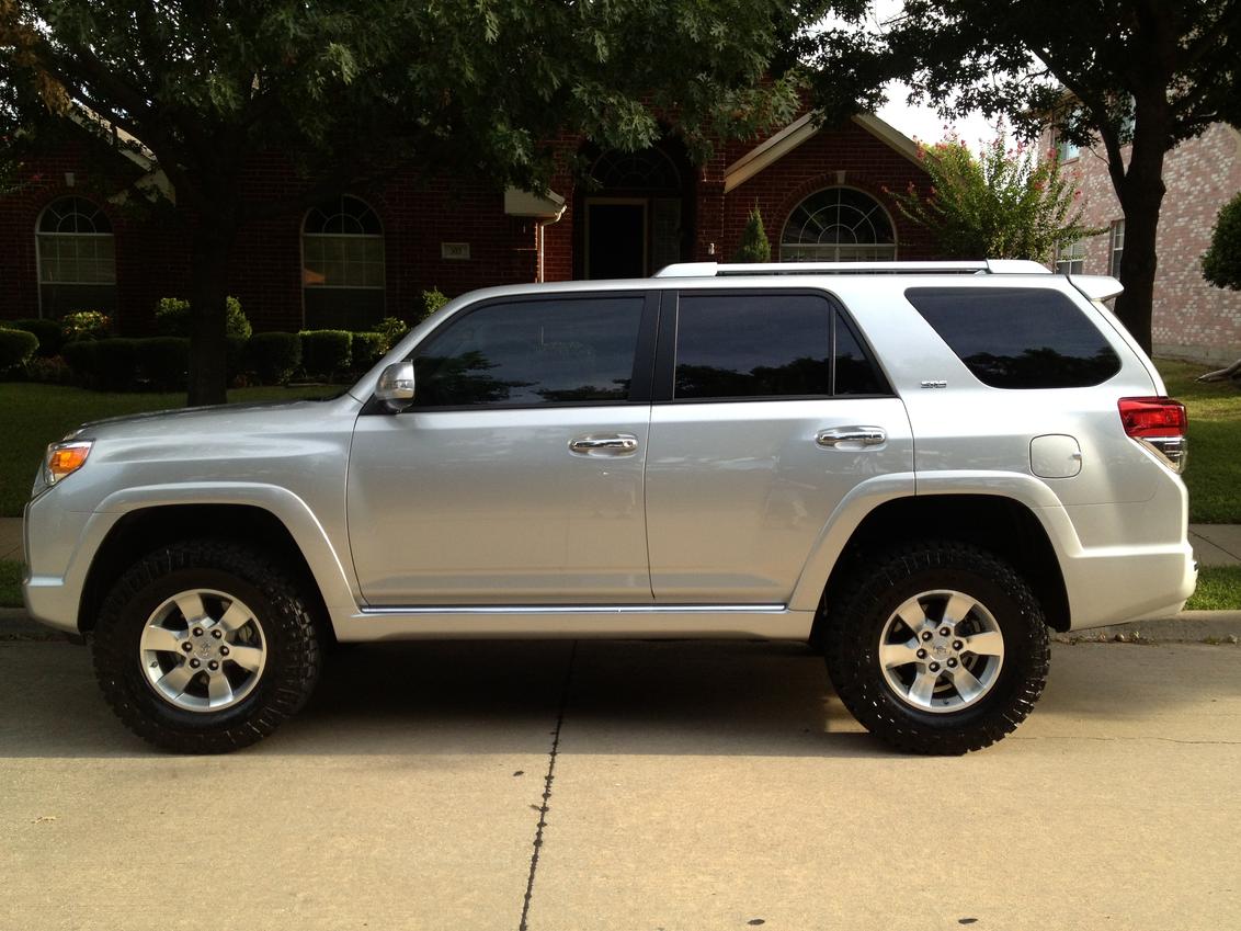

RevTek 3/2.5 lift 285/65/18 Trail Gapplers on Ultra Gauntlets

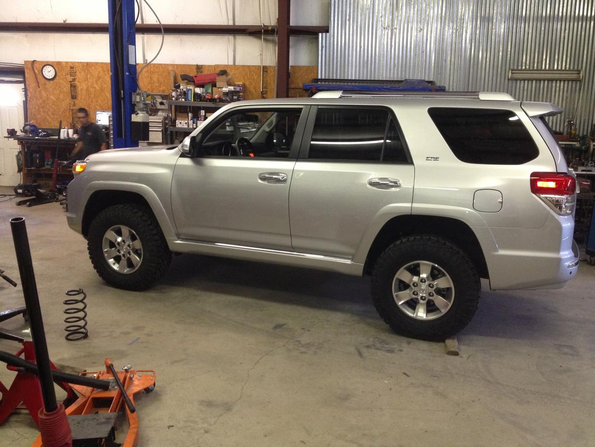

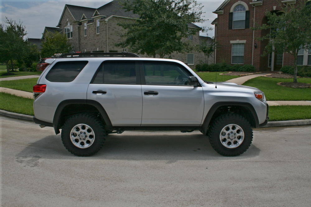

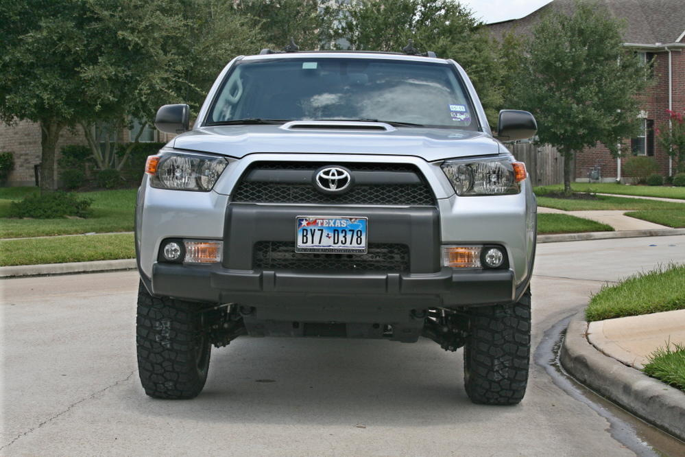

Bilstein 5100's front and rear. Front 5100 set to 2.5". SAW rear coils, Airlift 1000 rear airbags. LT265/70R/17 E Range Duratracs .:thumb3:
Guess I have to try this offroading thing now...:eek:
Thank you sir! Offset: +12mm BackSpacing: 5.43 inches
They also make it with a -12mm offset with a 4.5 backspace
I think I should have gone with the negative offset.

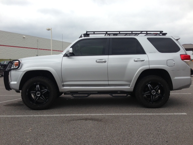

I got 295/65/18 with fender pushing forward and some trimming of the inside of the bumper and body mount chop no rubbing. My specs is 295/65/18 -12 offset which gives me 4.5 backspace and I don't know if you guys have adjustable upper control arms but with that my wheels are moved forward and no problem.

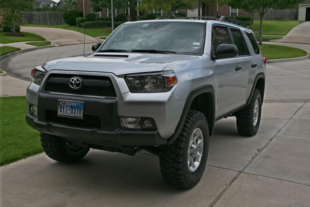

Lookin good Jeff. Any side pics?
Are you running spacers or is the offset strictly from the wheels?

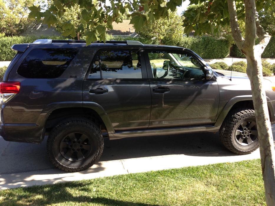

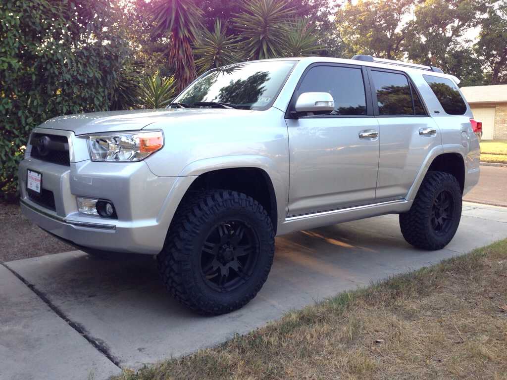

2013 SR5 4x4
Bilstein 5100s all around. Icon coils in rear. Goodyear Duratrac 285 70 R17. Diff drop. Did NOT replace UCAs. Little high in the rear right now
