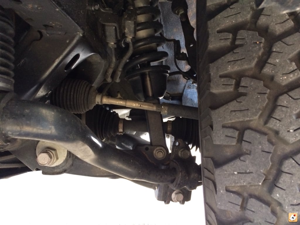

Well, finally got the lift. Toytec Boss with Light Racing UCAs. Took a few night shots of the setup, will take better daytime photos later.

Do you guys/gals think the angle is off? The fins are rubbing, but is it too much rubbing? I think I'll have to lower the front a bit, it sits level now, but I prefer the factory rake.
Edit: remembered a thread that was talking about cv angles, searched and found this http://www.toyota-4runner.org/5th-gen-t4rs/152119-post-lift-cv-angle.html I think his looks worse than mine?

Your angles are bad, you need to lower your coil overs. Fins touching is too much rubbing, there isn't an acceptable about of rubbing.

Have you measured to see the actual lift you gained? I remember when I just got done with my 883s up front only, it was pretty much level with the rear, and my CV angles were no where near as bad as your. Have you given it a quick drive around the block to see if it settles some?

The joint closest to the front diff just doesn't look like it's sitting right. Is it just me?
Thanks for replying David. The tech said he's done plenty of lifts and that looks okay, he's even seen it worse on some Tundras, yikes!? I had them put it down 1inch and hopefully that improves the angle much more. I'll report back tonight.

Was extremely busy so no before measurements. But there's definately a lift because I was having a harder time getting in and out, I am adjusting to it though. Drove 20 miles so iit settled. We shall see after the drop.
I did take measurements after lift. From center of hub to wheel well 24in both sides, per phone call to toyteclifts you want to be between 23-24 up front. So I am going with the lower end.
The tech is wrong. There's no maybe in the discussion. Your CV boots won't survive for more than a few thousand miles if they are rubbing. When the boots fail, joint failure will follow shortly.
2.5" is the max safe lift on a Toyota IFS. If you are looking for near factory reliability, that's it - no more. That is NOT the point where the boots are usually touching, that's just the max that's OK for the CV joints. 2.5" suspension lift + 0.5" from running 285/70R17's vs stock size and you have 3" lift, which is what most people are shooting for. The center hub to center of the fender measurement should be no more than 23" (more like 22.75", depends on the truck).
Lots of people push it past that point. Some do it because they don't know they have accelerated wear. Some do it because they are looking to maximize their Off Road potential and accept that breaking parts is part of the deal. It's impossible to say if you lift XXX amount your CV joints will fail in XXX miles, but it's pretty well accepted that once you go beyond 3" suspension lift (3.5" total w/ tires) you are living on borrowed time. Your center hub to top of fender measurement should be 23.5" max - even there, you may need to spread/secure your CV boots w/ hose clamps to keep the fins from touching.
Again, if the fins are touching, they are rubbing w/ every revolution of the wheel. That rubber will NOT stand up to that wear. It will fail and your CV joints will fail shortly after that.
My advice would be to drop it a full inch to 23" in the front, bare minimum a 1/2" drop to 23.5" and check your boots. The "look" isn't worth the expense in my book.

Measured from center of hub to fender on both sides, have 23inches. However, this was in the driveway with a slight incline, I will have to measure again on a flat surface.
Here are the pics in the order of, toytec default setting sitting at 24inches from center of hub to fender, then down to 23in at the dealership, then still at 23in when I drove home, about 20 miles.

It looks a lot better to me, is it in the "acceptable" range now, or at the very least "better than before range", David?

That looks a lot better! The inner CV boot looks like you've still got some minor touching/rubbing. You can see in the last pictures on each side the dark "clean" rub rings on the interior cv boots - that's where they were rubbing before.
Certainly where you are now, a lot of people drive for a long time and ignore w/ few problems. If it was mine, I would drive it for a few days and see if it settles more. If it doesn't, I would probably look at getting it dropped another 0.25", followed up w/ another 0.25" drop if needed to get the boots not to touch. I'm pretty conservative though, and I'm sure there are lots of people driving around w/ boots like yours are now w/ no problems.
