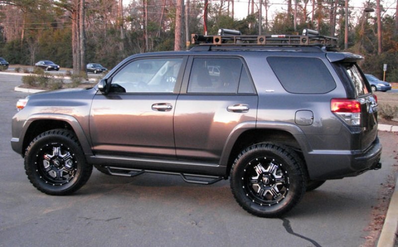

This is my 2014 Trail Premium KDSS Remote Start (it's a work in progress with lots more to come) but this thread is about lifts, and the lift is done; so here's the lift, before & after:

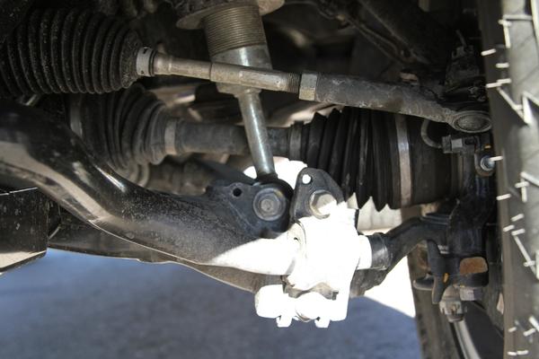

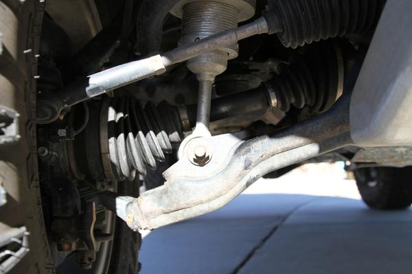

Here are the angles of the CVs on my 2007 4Runner with 76,000 miles on it, this has been lifted over 3" in the front since I bought it in 2008 with 20 something thousand miles on it. CV axles and boots are OE.
This is my new 2014 Trail with 1000 miles on it. It is just under 3" lift in the front, need to crank it up to 3.
Not posting for your evaluation, you already stated that your not an expert. Just posting information others may find helpful.
Ah I see my rude friend.
Your boots look just like [MENTION=75517]whodat[/MENTION] 's after pictures - after he had them adjusted down from where the Toyota tech originally set them.
This is what I had to say about that:
That looks a lot better! The inner CV boot looks like you've still got some minor touching/rubbing. You can see in the last pictures on each side the dark "clean" rub rings on the interior cv boots - that's where they were rubbing before.
Certainly where you are now, a lot of people drive for a long time and ignore w/ few problems. If it was mine, I would drive it for a few days and see if it settles more. If it doesn't, I would probably look at getting it dropped another 0.25", followed up w/ another 0.25" drop if needed to get the boots not to touch. I'm pretty conservative though, and I'm sure there are lots of people driving around w/ boots like yours are now w/ no problems.

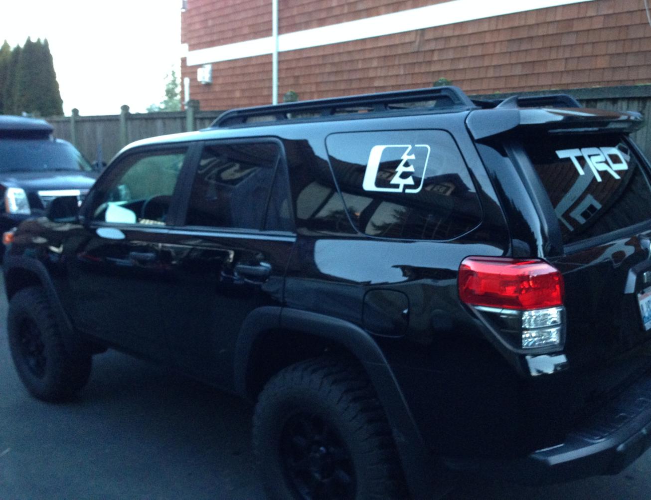

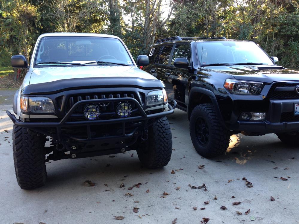

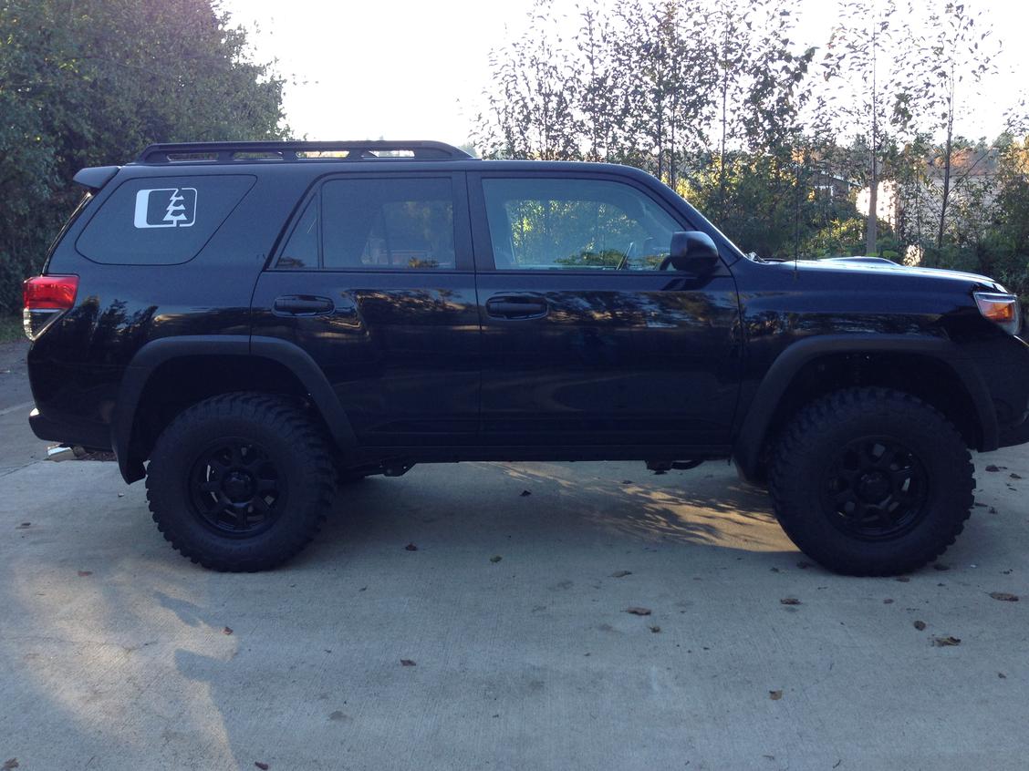

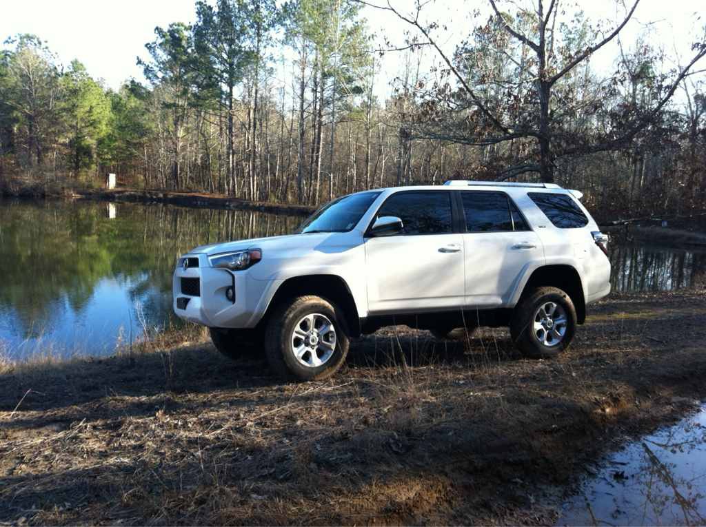

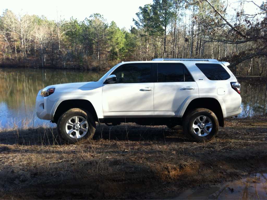

Been lurking here for awhile. Here is mine.
