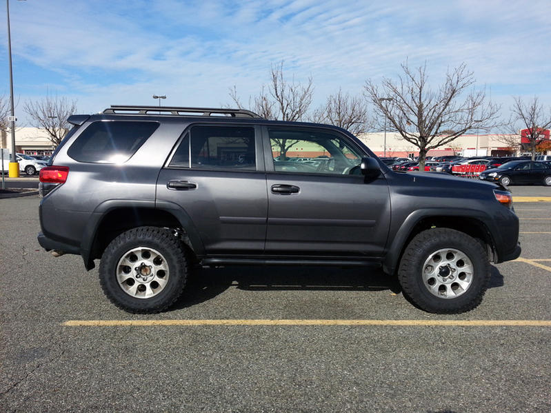

5100's @ 1.75 Rear Cornfed 1"
Finally pulled the toytec spacer and put in 5100's - why didn't i do this sooner.

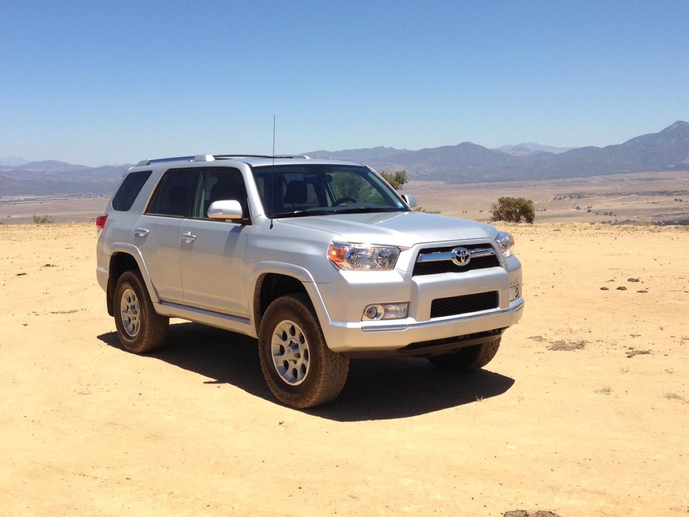

Saw it on the Toytec fb page. I searched like mad on this forum and I don't think the owner of this '14 is a member. Anyways, I think it's pretty bad ass. The lift and wheels definitely take away from the akwardness of the new front end.
Agreed completely! As others have pointed out the new front end looks a lot more pronounced in the lighter coloured make-ups. That lift makes a big difference!

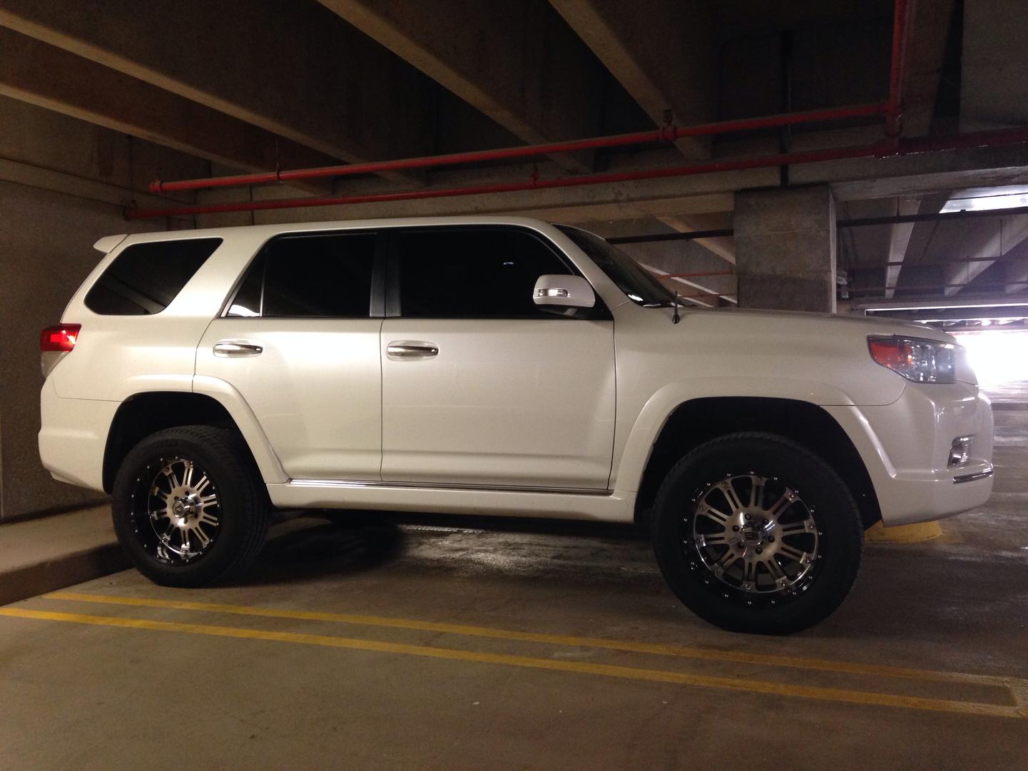

Toytec lift with TE wheels and 285s
I don't think I ever posted after my suspension changes.
Toytec Ultimate lift kit, with the 5100 adjustable coilovers in front, and the kit Bilsteins with 1 1/2" spacers in the rear. I first tried the kit springs in the rear, but it was a little higher than I wanted.
The actual ride height change from the suspension is 2 1/2" higher than stock in the front and 1 3/4" higher in the rear. Overall ride height is an additional 1/2" more than those numbers due to larger tires.
The tires are Bridgestone Dueler AT Revo in P285/70 R17. Great tires, decent look with outstanding ride, firm but not harsh handling, and they are very quiet.
The ride and handling is noticeably better with the Toytec kit than with the stock x-reas suspension.
I tried aftermarket wheels and decided to go back to stock sized wheels, so I picked up some TE wheels from one of the guys on the forum. I wanted a pretty stock appearance, so I'm happy with the overall look and performance and don't plan to mess with it any more. To me it looks like it should have when I picked it up from the dealer. Thought I would throw this out there for anyone considering going the conservative route.

Are you getting any rubbing? Looks great!
David

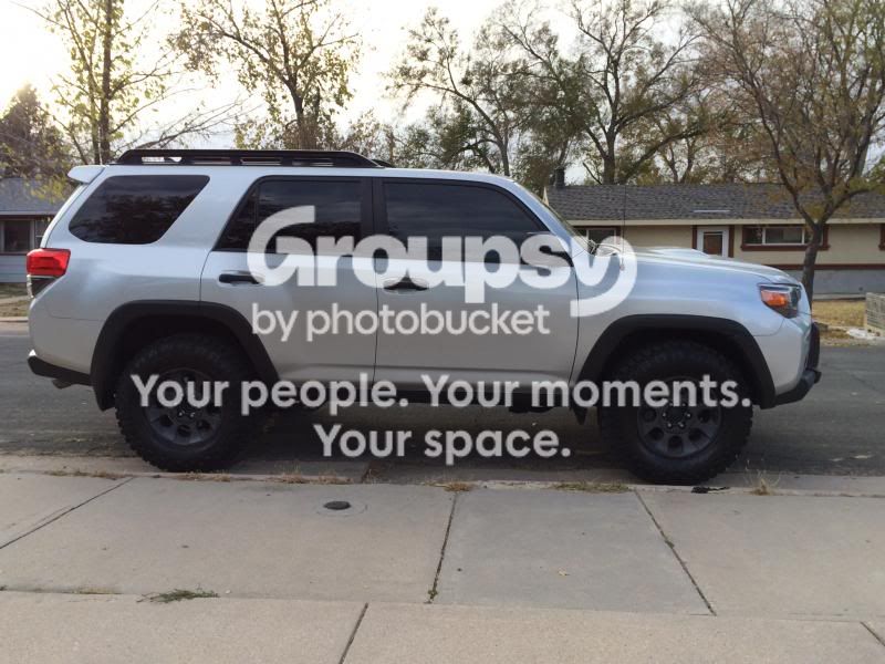

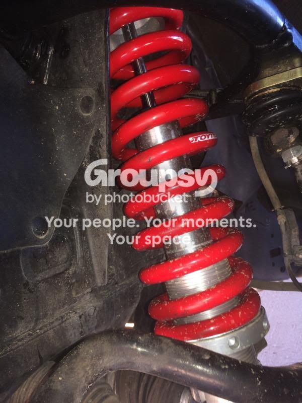

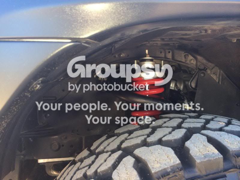

Well, I can finally post in my specs in this thread....
Toytec Ultimate, LR UCA's, Bilstien 5160s for the rear. Tires are Duratracs 285 70 17. I am still rubbing full lock so I'll have to do some trimming.
I am either going to go with new wheel or get spacers to keep from rubbing the UCA's.
Before:
After:
Few more:
Some Close up:
-J

Good choice going w/ the 5160's in the rear. I have them and really like the way they feel.
