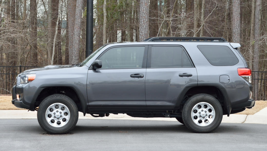

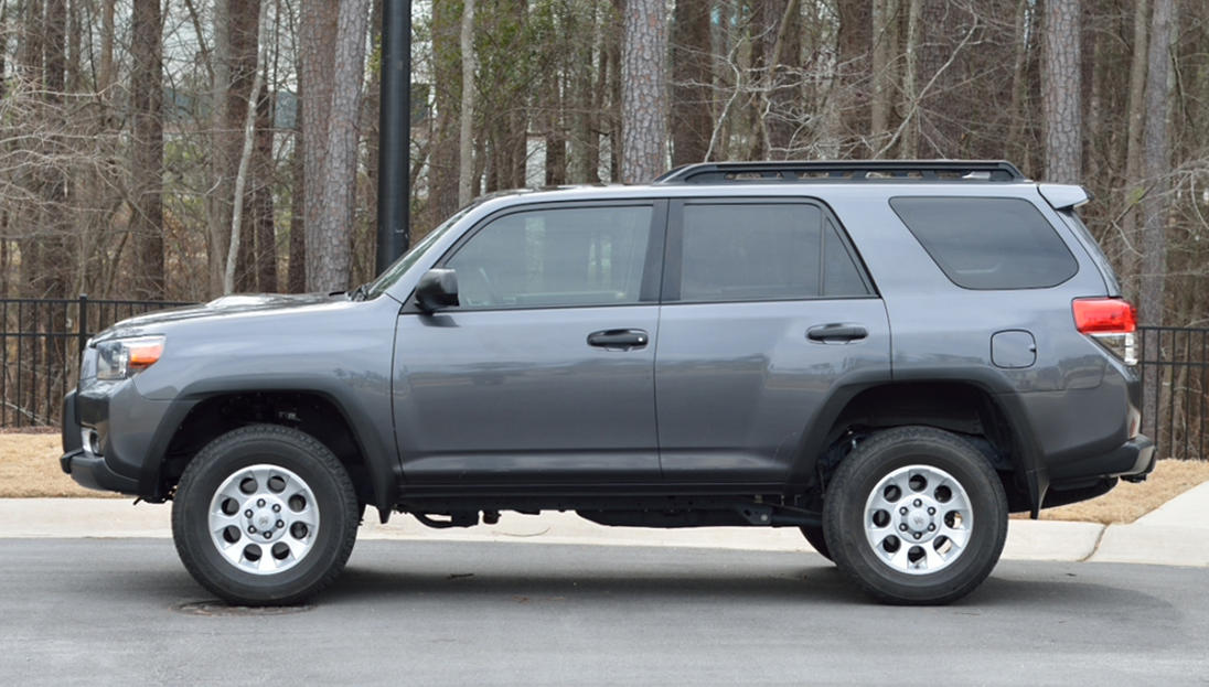

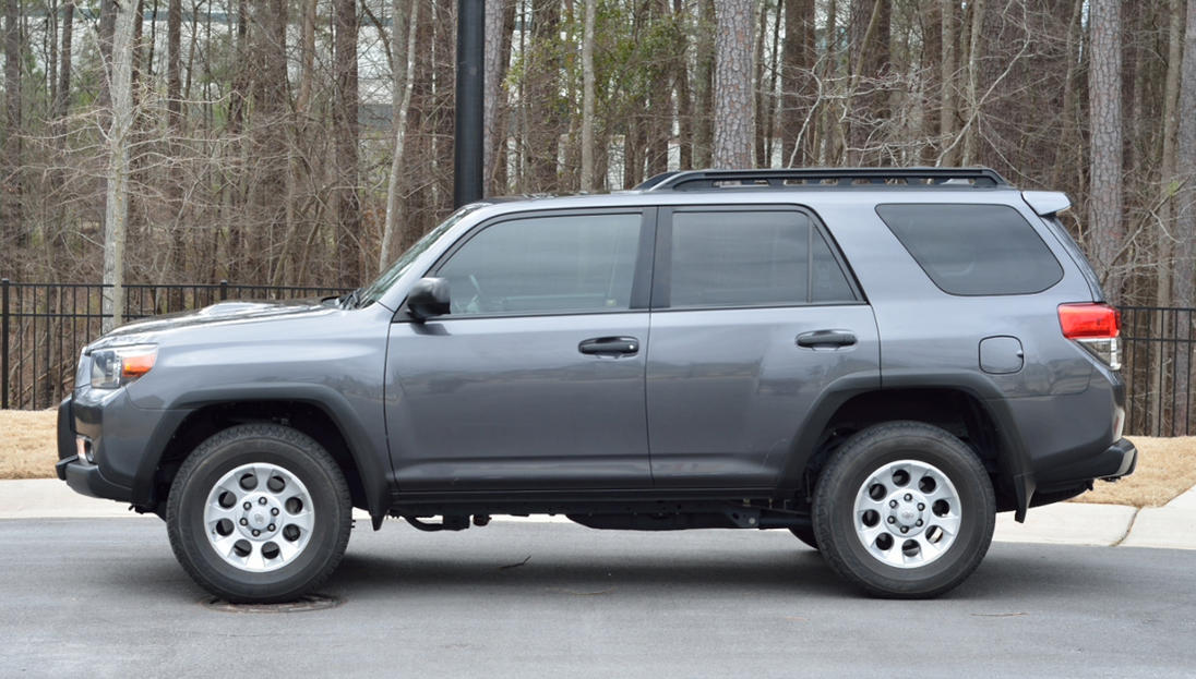

First post here on T4R, some hopefully helpful before/after shots of my lift. Went with new bilsteins all around (set at 1.75" in the front) and 1.5" toytec rear spacers. Love the new ride. less dive under heavy braking, less lean in the corners, less "rock and roll" going over obstacles, and very smooth riding on the road. Better looking stance and better handling, is really a 2 birds with one stone kind of thing. Installed by myself in a day with floorjacks and minimal cussing.
set at 1.75", it definitely still has some rake. I think the 2.5" setting would've leveled it perfectly, but I wanted to avoid getting saggy in the rear under load.
Tried to get these photos from the same angle, so that you can 'toggle' back and forth with a photo viewer and see the changes in an 'apples to apples' kind of way..
Shown with no lift/front lift installed/front&rear lift installed

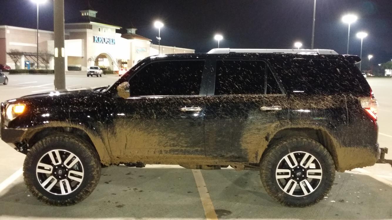

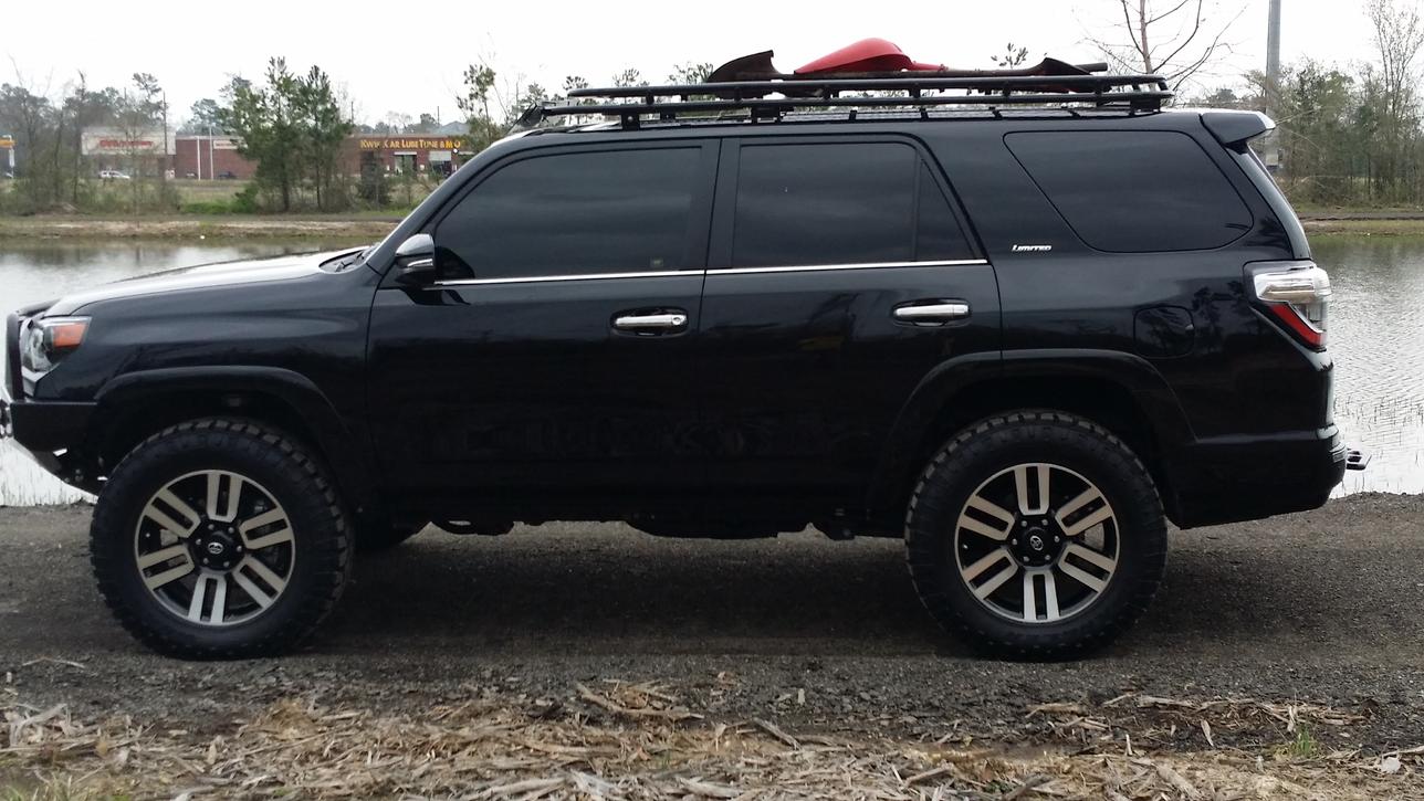

Looks perfect! Just need some better tires!
Lifted Pics

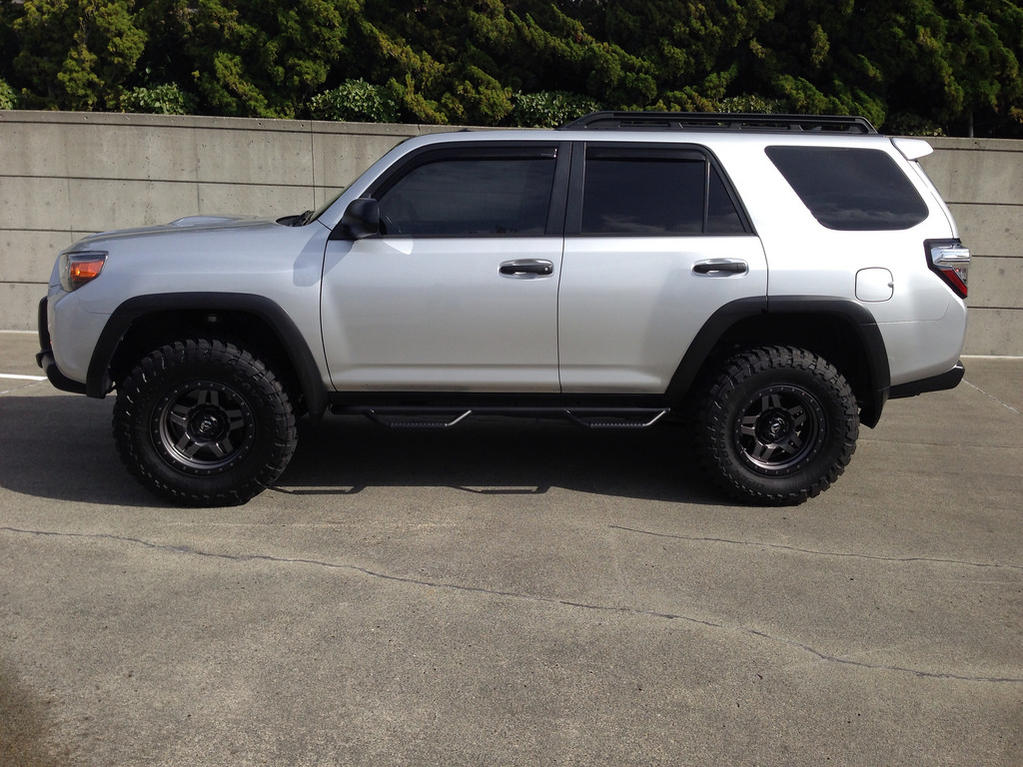

2010 TE with ToyTec Spacer Lift

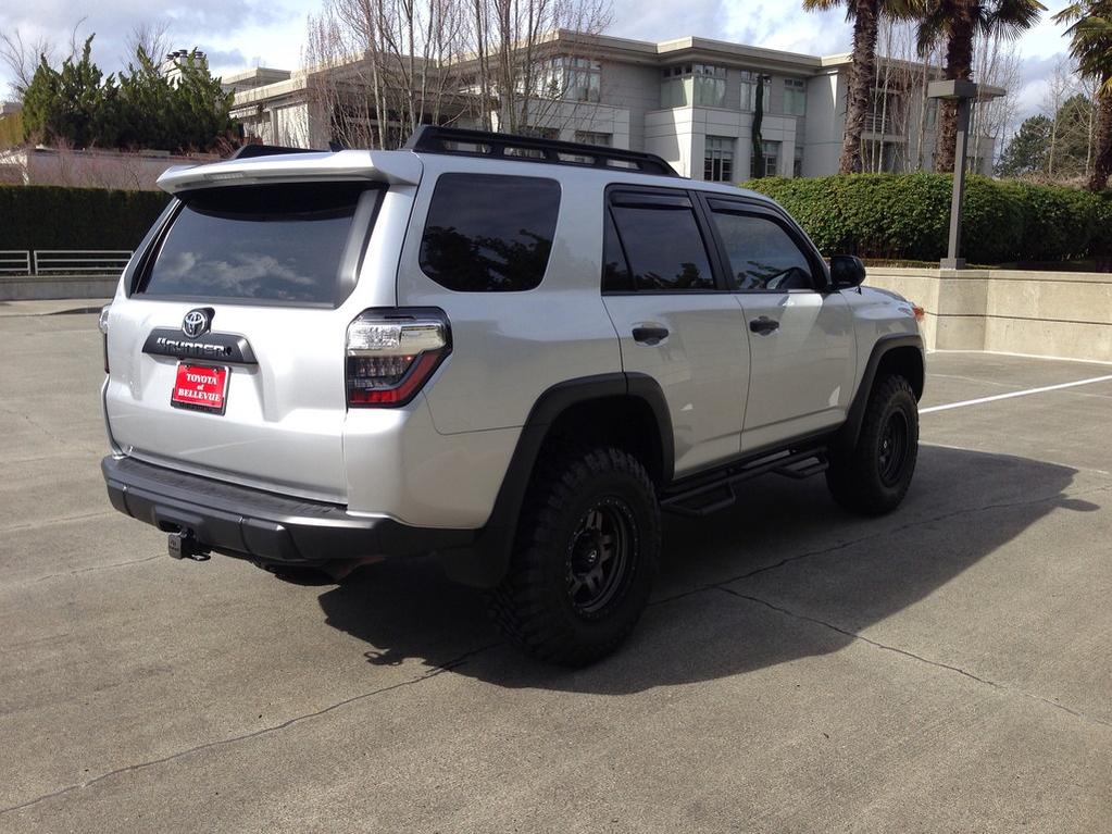

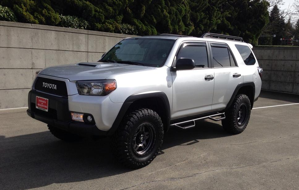

Lifted with ToyTec 3"/2" spacer kit by previous (original owner) but wheels,tires,stepbars,Satoshi,LED TailLights, window deflectors are my personal touches...along with Katzkin leather interior TBD. Is a GREAT vehicle with only 41K miles and a nice step up from my lifted Tacoma that I loved as well, but traded for this
Wheels - Fuel Anza 17"
Tires - Toyo Open Country M/T 285/70R17
StepBars - N-FAB (4wheelsonline.com)
Satoshi - Grill Craft plus TOYOTA emblem
LED Tail Lights - OEM from Toyota of Dallas (best deal)
Window Deflectors - Weather Tech (autoanything.com)
Katzkin TBD - thru dealer and local installer ($2100 w TRD logos, perf)

What brand are those rock sliders?

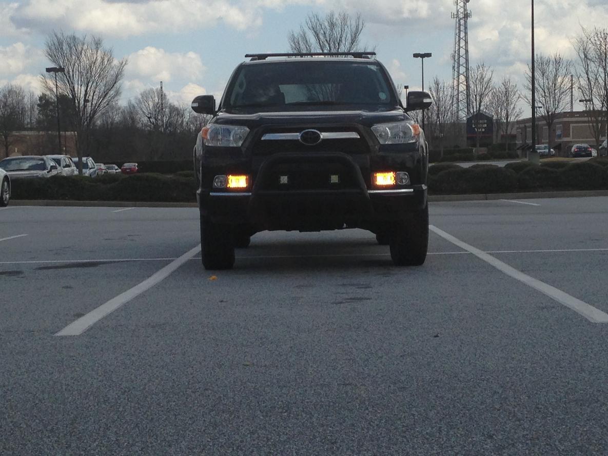

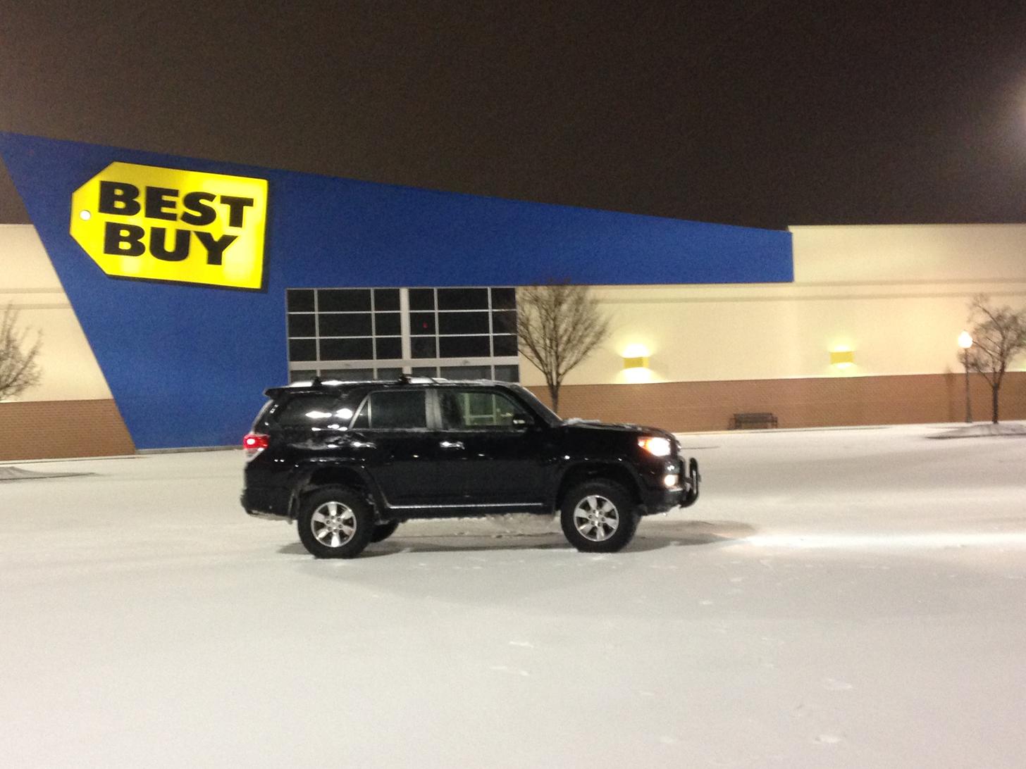

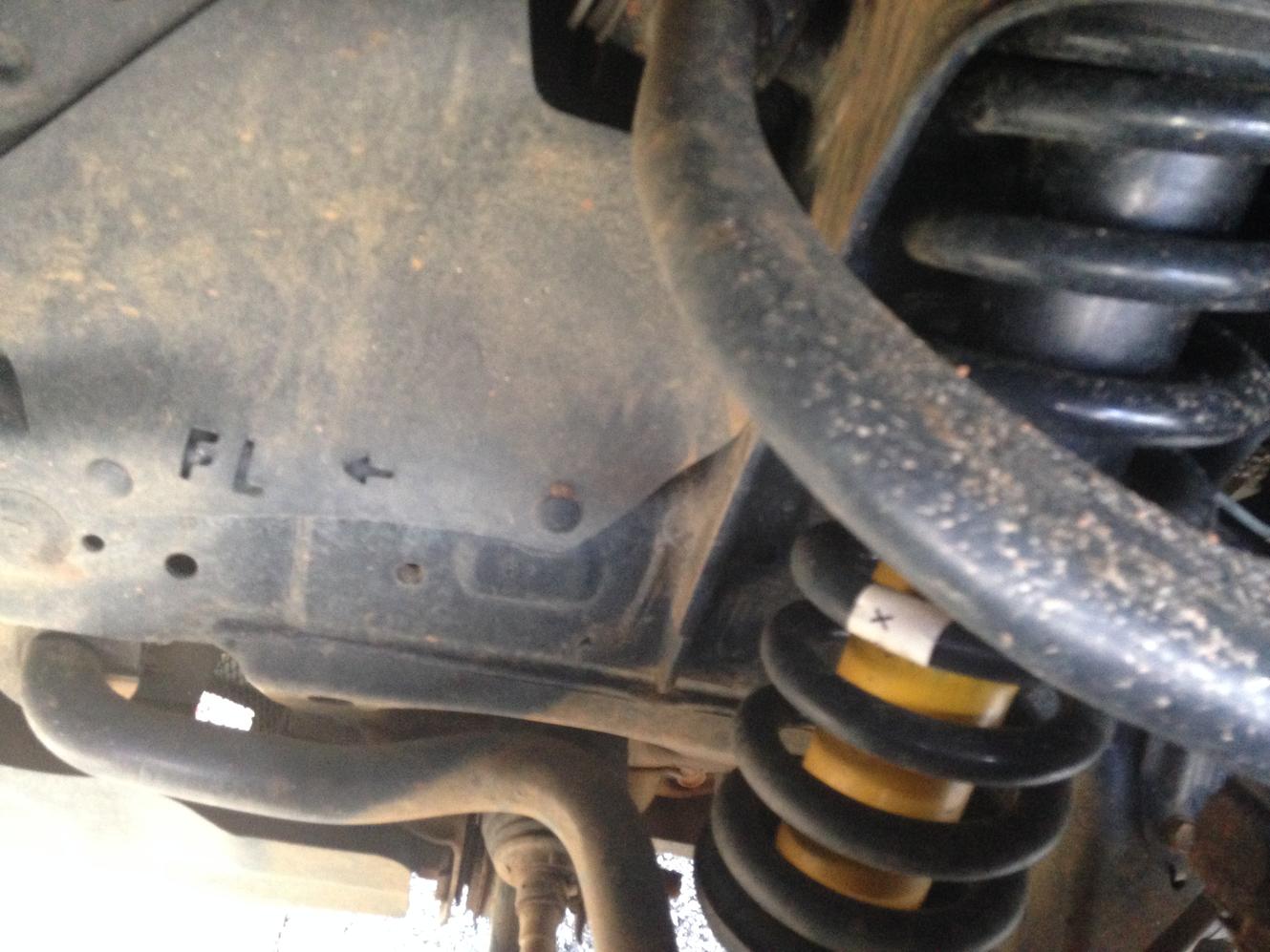

2011 sr5
3'' OME (Medium coils) 265/70/R17 BFG A/T
