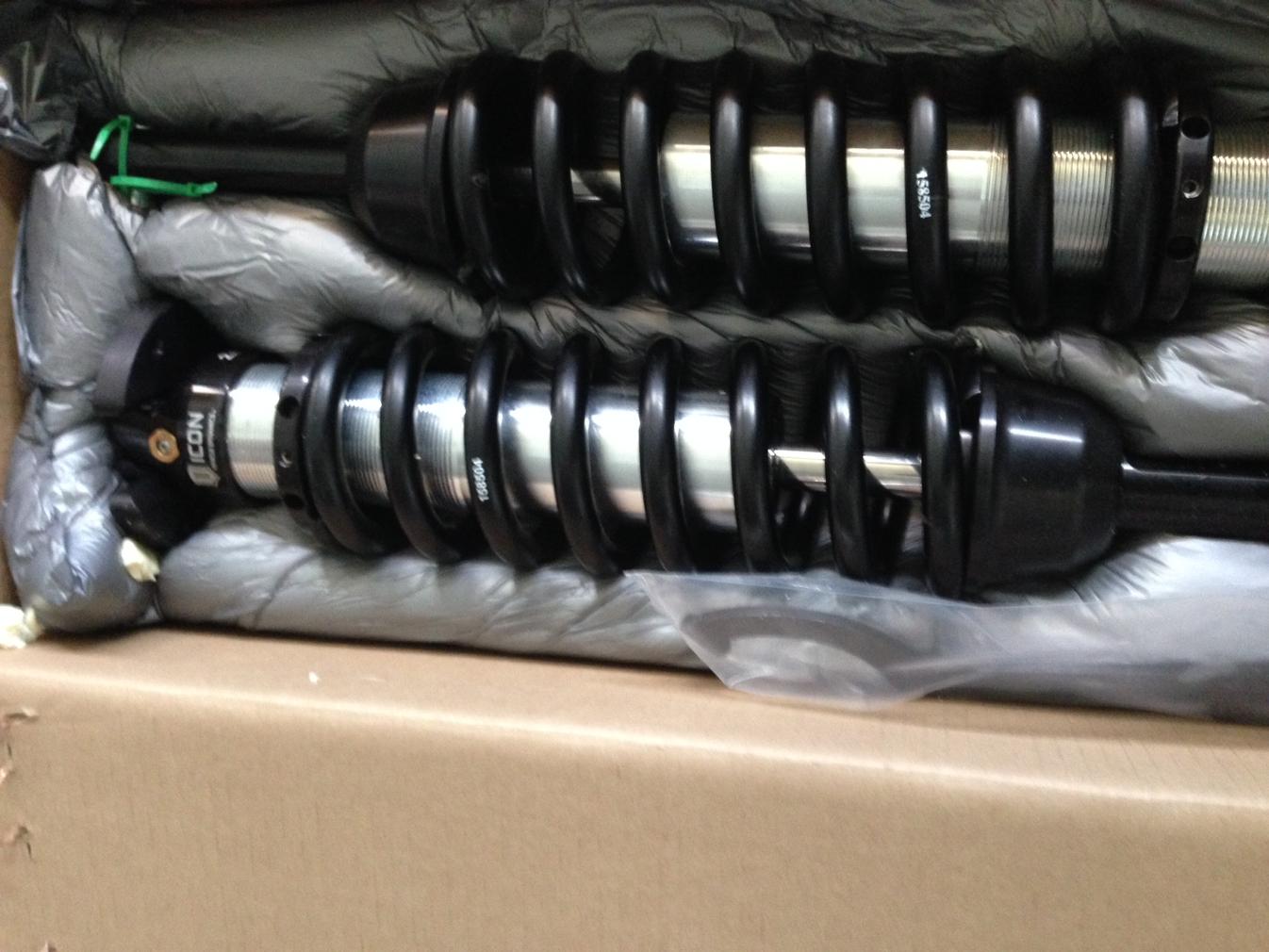

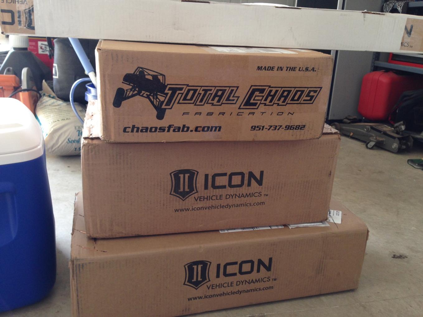

Icon Stage 2 on it's way with Total Chaos UCA's
Should be here by Friday and then I need to find the time to install
Pictures to come!
Oh snap! UPS came today

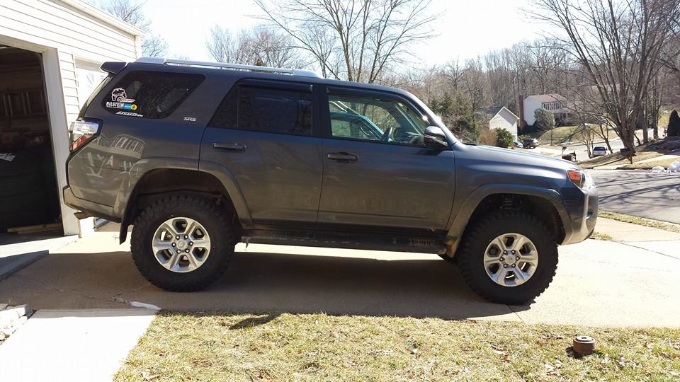

2014 SR5 BOSS lifted on 33's
Anyone else have an issue with leveling the front pass side with drivers side with this BOSS kit? The coilovers initially put it up about 4 inches (after settling). The rear coils raised the truck up 3" in the rear (was supposed to be 2"?)
Those coils are known to give about 2.5" after settling. That's about what mine are.
Throw about 500lbs in the back for a week and they'll get broken in.
It'll settle down some.
That pic has the BOSS kit installed. I've put 500 miles on it since the kit and she's still the same in the rears. The drivers side coilover in the front was easy to adjust. The passenger side... well. I've lowered it by a few whole turns over the course of a few days making sure to settle the suspension between adjustments. Hasn't lowered the height a bit! According to toytec a quarter turn = .5". This is probably a topic for another thread. I'm happy that I can drive over stuff and not drag the skids.
This might be a stupid question, there are two collars on the bottom, are you turning the upper collar? And counter-clockwise to go up, clockwise to go down. That's what Toytec told me over the phone when I called them. Hope that helped.
Yup. No offense taken. Not my first set of coilovers as i installed the lift and UCAs myself. Very strange that I've taken a lot of load out of the spring on the passenger side and ride height hasn't changed. Not sitting on a bump stop obviously. Not sure toytec is aware that the 2014 may be a touch different than the previous model year. I'll figure it out eventually.
Just give it some time. It should relax at some point. I honestly don't believe a quarter of a turn on a collar is going to give you a half inch of drop/lift. You'll need to turn it a few times around. But if Toytec says so...
No offense but, are you sure you read the instructions right? Usually a 1/4" change in coil height = ~1/2" lift. Not sure how far your coil over threads are spaced but I would imagine a 1/4 turn would change your ride height by a tiny amount. I've never touched a pair of Toytec coil overs before, so I can very well be wrong. Maybe you should call Toytec and just confirm instead of moving perch down at a snail's pace :)

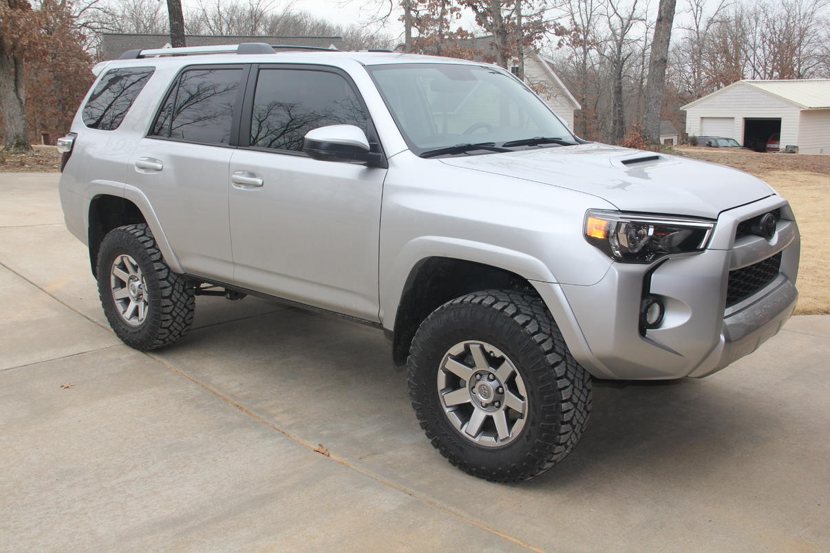

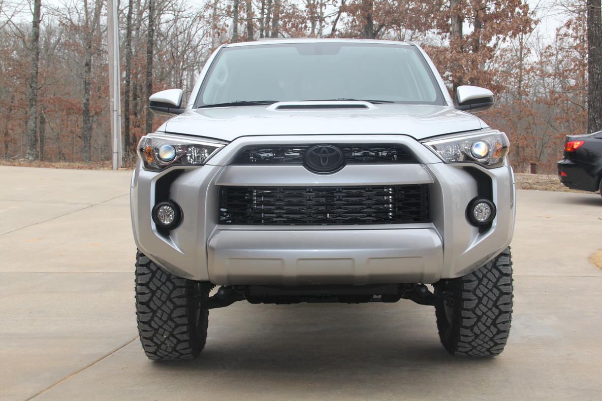

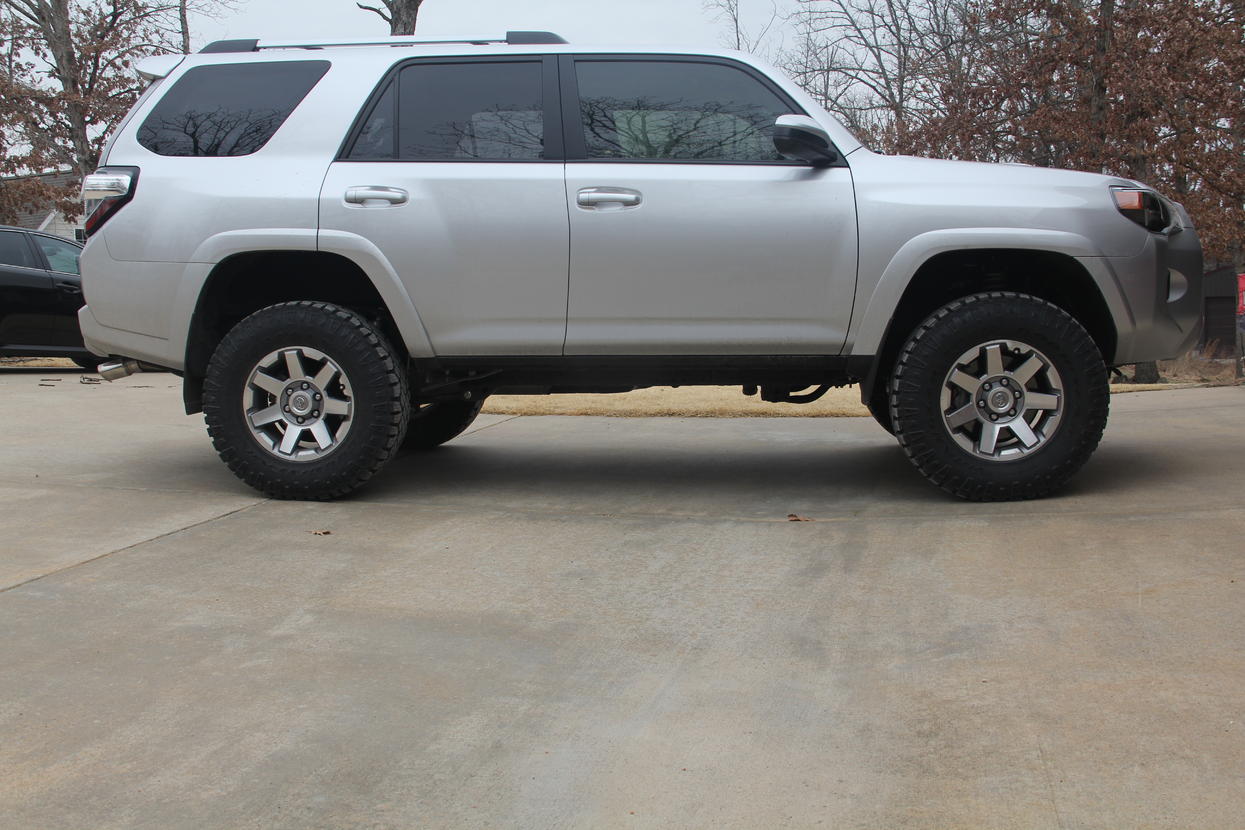

2014 Trail Edition - Work in progress
Finally finished installing my lift and new tires. Nfab rock sliders are ordered. Not sure what is next. Thinking about a magnaflow muffler and maybe a cold air intake...
