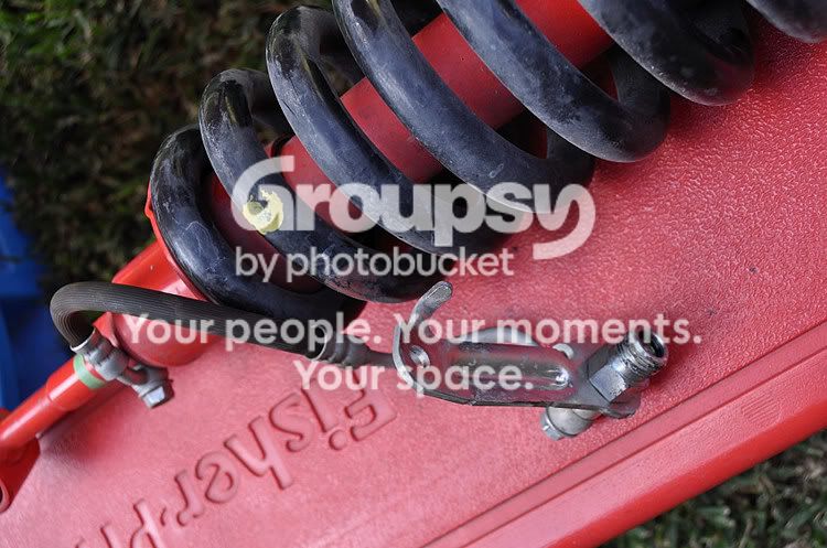

For future reference....Connectors ,for each XREAS shock are at the frame and only disconnect with pressure off(all 4 wheels in the air)and look like this....Never disconnect them at the shock body or anyplace else.
Picture037-1.jpg~original

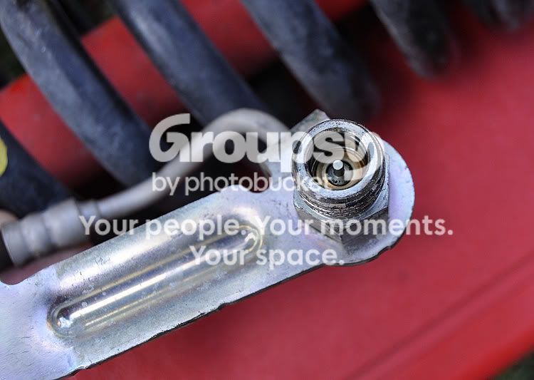

What the check valve that prevents fluid loss looks like...
Picture036-1.jpg~original

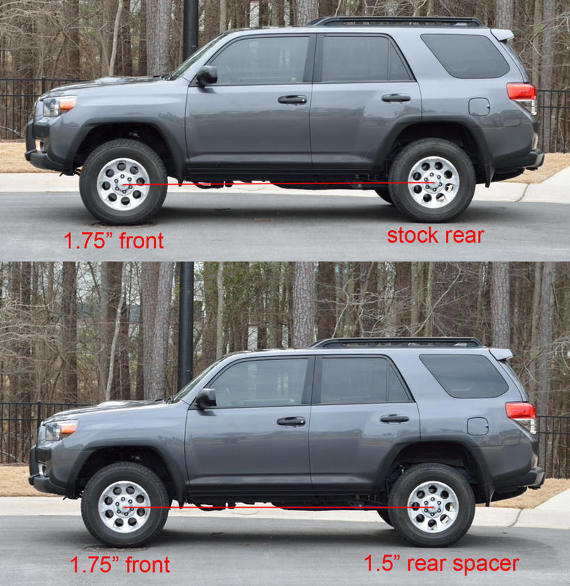

put this images of my lift results together for someone looking for information on "leveling" the 4runner, and thought it might be helpful in this thread as well. The red line is drawn between wheel centers, and helps visualize how much rake there is....
