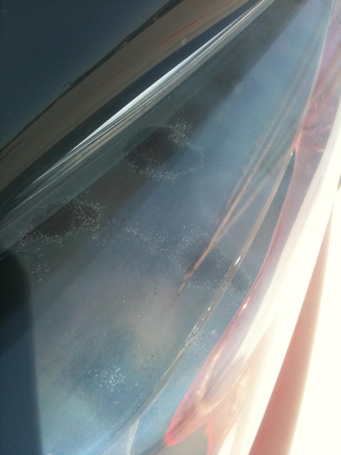

S**T ! :dammit: Now mine are starting to haze on the outside too. Has anyone gotten wind of a TSB on this issue? Or had theirs replaced under warranty yet? This is my passenger side assembly on a '10 Trail

Took my SR5 in for a service (10,000 mile service). Explained the issue and service manager stated they'd look into it. He asked if I was using any spray wax. Told him I was not, and that when I did wax my truck I was extra careful around all plastics (including headlights). They called me back telling me they'd be ordering some new headlights. They've replaced them since. I haven't noticed it anymore......"yet", I'm at 15,000.
