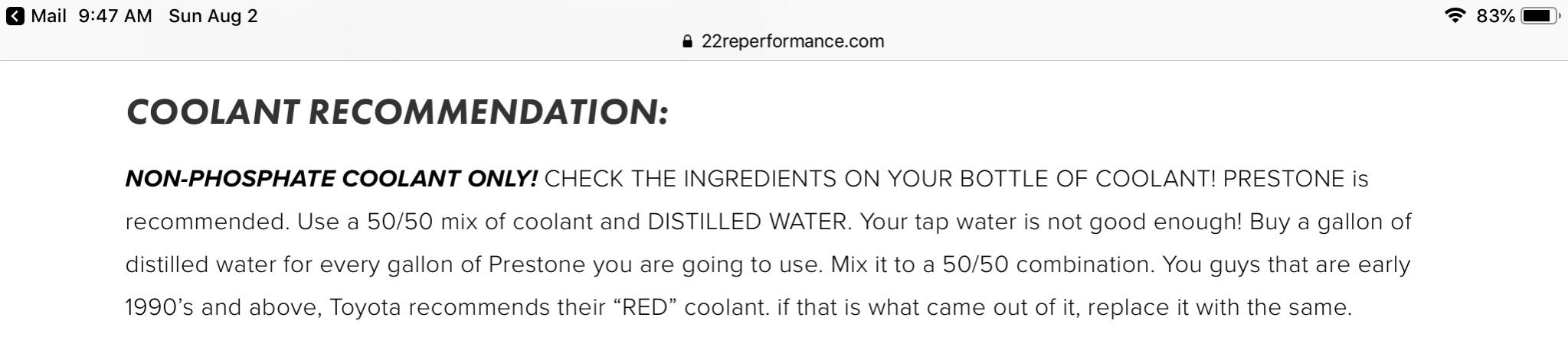

Found this on 22RE Performance website. With years of experience and a solid reputation rebuilding 22R series motors I most definitely value their opinion as well.
