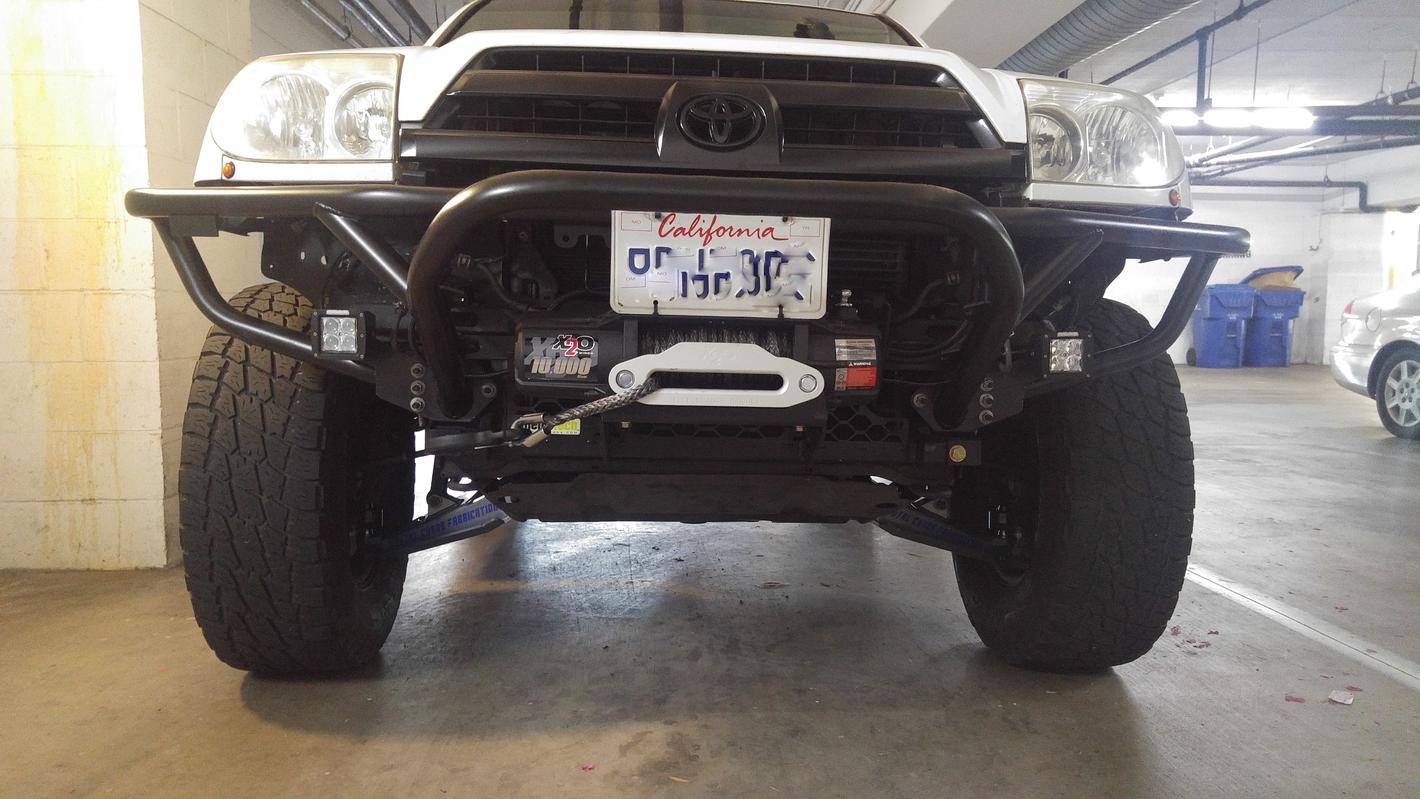

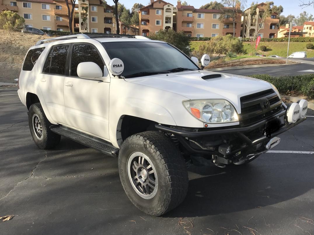

Been building my 2wd 2005 Sport 4.7 for awhile now. Lots of work done.
-Total Chaos upper control arms.
-Total Chaos lower control arms
-Total Chaos3.5 lift spindles
-Total Chaos CHROMOLY ADJUSTABLE REAR LINKS
-Fox extended coil overs with Wheelers 700lb springs.
-Fox rear 2.0 shocks.
-Front sway bar removed.
-Skyjacker Suspensions SBE702 - Skyjacker Extended Sway Bar End Links and
-Addco 2301 rear Anti-Sway Bar Kit
-MT LT rear HD springs
-Icon rear air bump stops.
-Spintech exhaust.
-AFE CAI

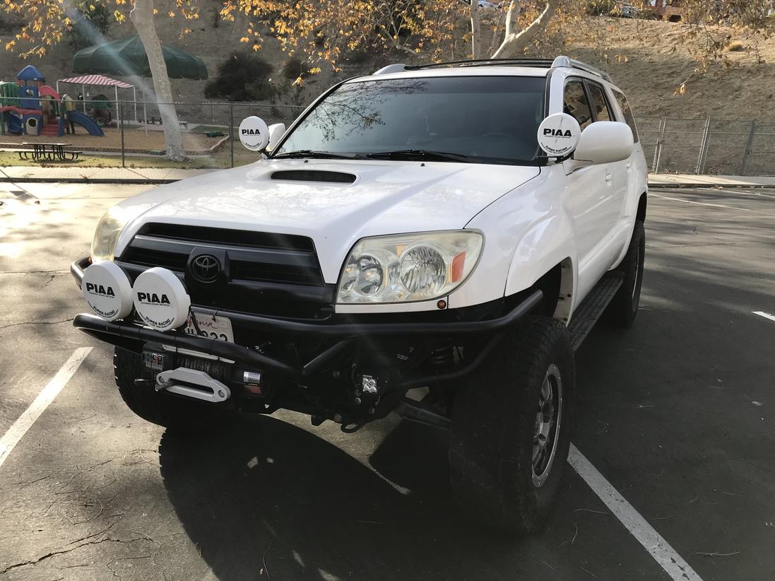

-Metaltech front tube bumper.
-10,000 super winch. Syn. rope.
-Piaa spot and flood lights.
-Method 17x9 wheels.
-12 volt mod for both plugs
-LED driving lights
-Tinted windows
-ARB 50qt frig.
-140000 Pull Pal
-Smoker kit
-Drilled/slotted Max brakes
-Console safe
-Tuffy storage box
-Alu-cab fridge tilt slider
-315/70/17 BFG All Terrains
-488's and Tru Trac

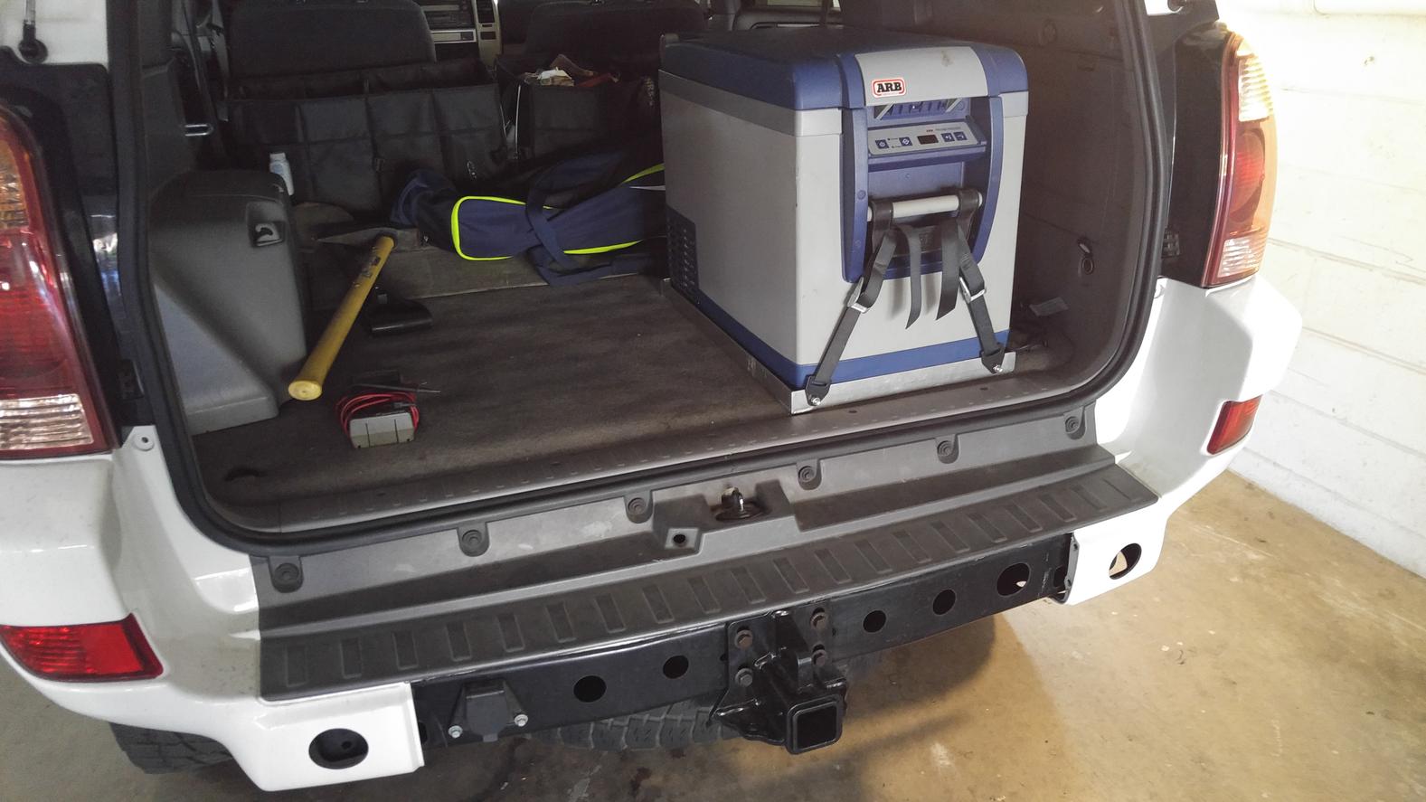

20160922_131526.jpgScored a ARB frig. and 14000 Pull Pal for 700 bucks today:dancin:

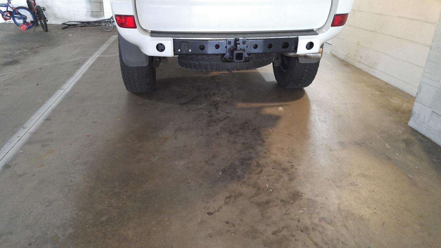

Moved the plug in for towing. Got a 295/70/17 to fit. Added a ARB hitch

Wow! what a differences driving. Nice and tight and goes straight down the road. Thanks ORW,Wheelers and Total Chaos

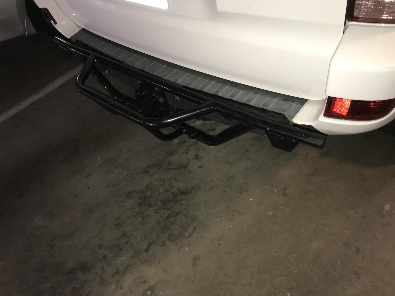

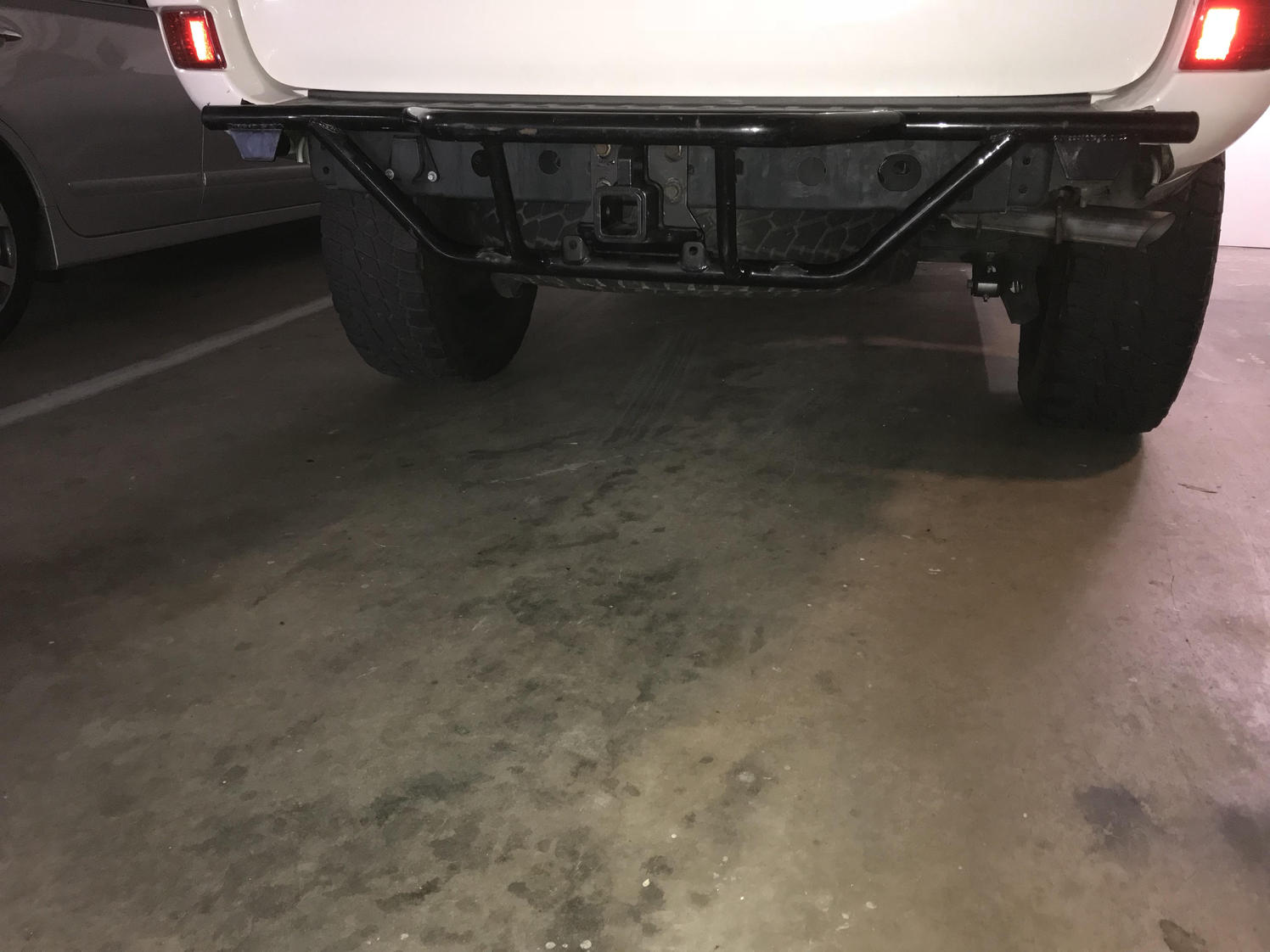

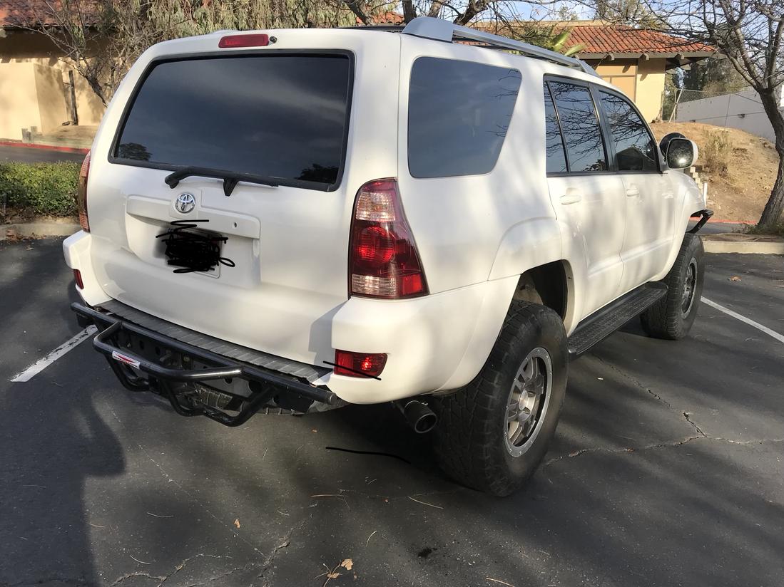

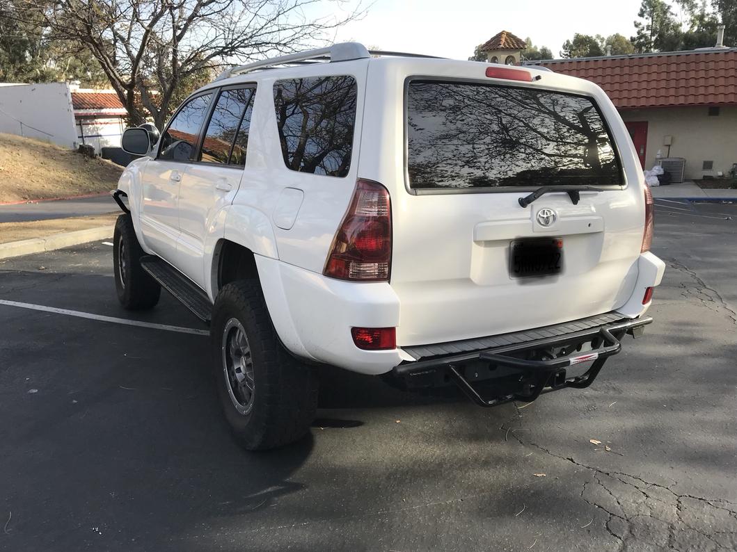

Made this with an ARB hitch and a N-Fab rear bumper
