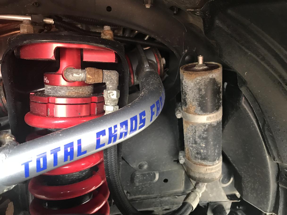

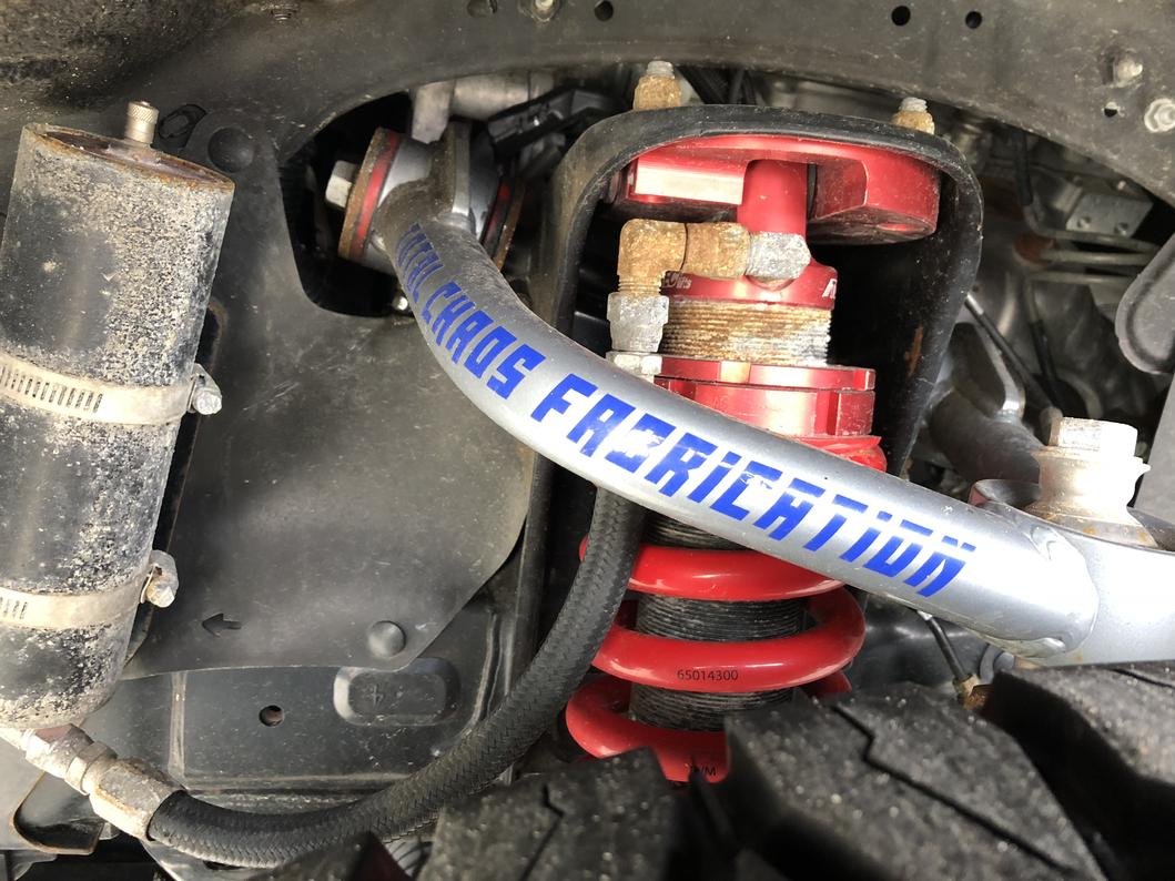

I installed these Toytec top of the line ($1850) coilovers last summer. They were rusting out pretty bad by December, and even worse now. I do live where there is snow but I rinse the vehicle weekly, very thoroughly. It’s never seen mud beyond a gravel road or driveway.
Here’s a couple pictures. Seems to be way worse than what I would consider acceptable. I saved hard to buy my 2017 4Runner and it’s an otherwise nearly mint vehicle and I’ve put a lot into it.
The condition of this suspension is a bit embarrassing to me. Toytec stated this is normal and will not do anything about it. If I knew this was to be expected after 9 months I would’ve gone another route.

For 1800 that is a lot of corrosion. I don't think the corrosion will affect performance, but it is pretty crappy quality.

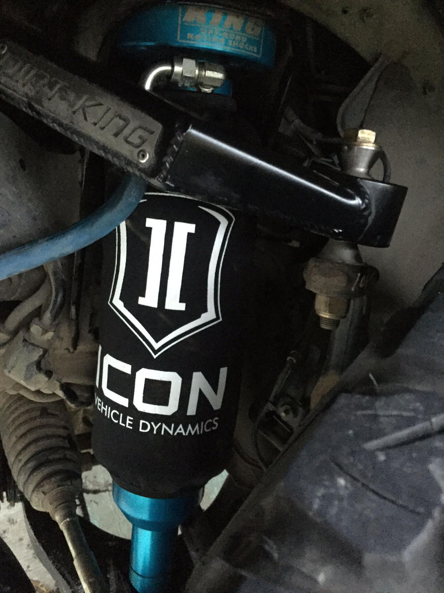

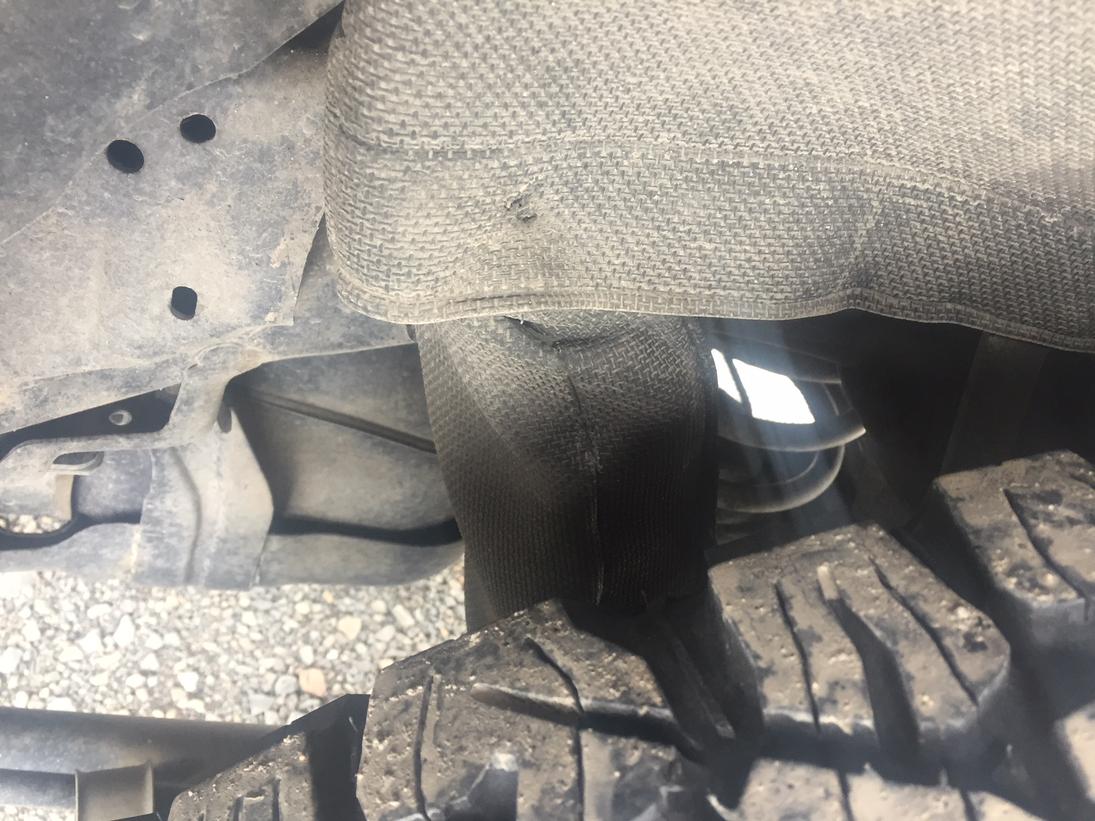

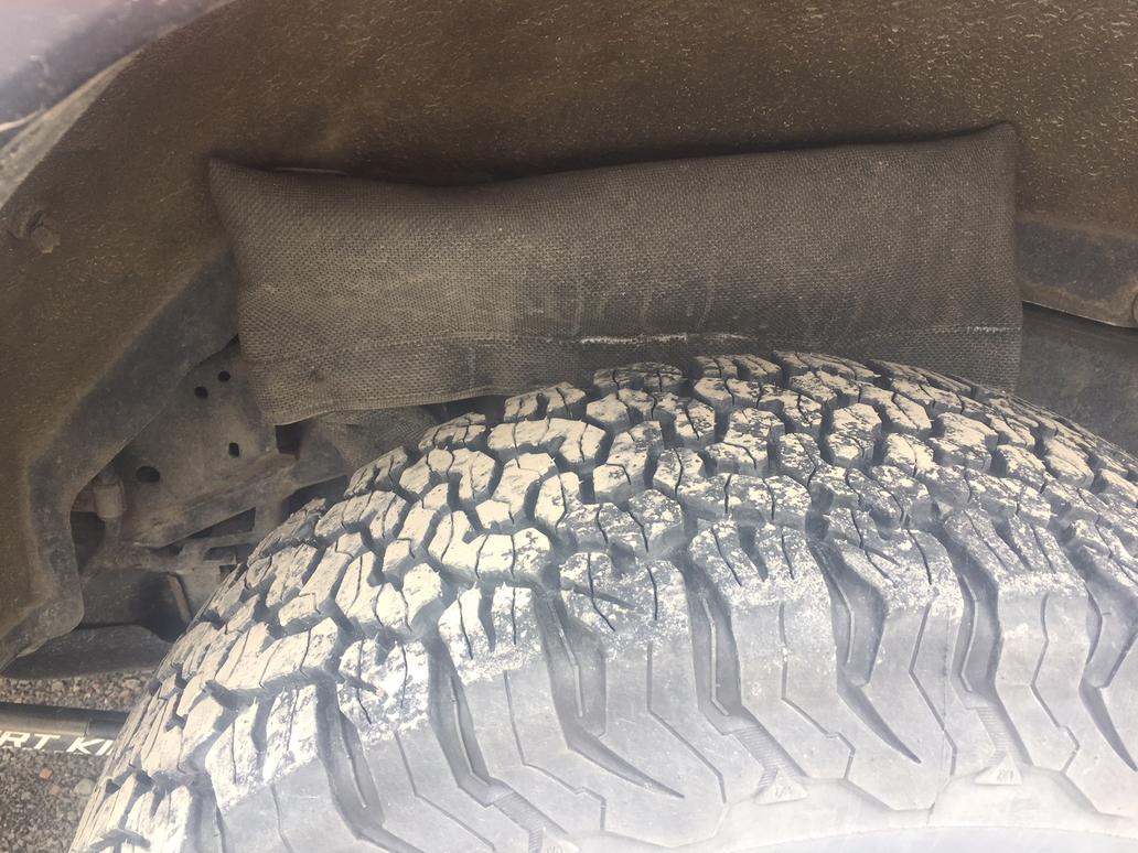

I went apeshit on my shocks and coilovers. The rear shocks are covered by shock wraps made by PRP seats, both the shock and the reservoir. For the coilovers, I use icon's coilover wraps in the wintertime. They actually do a great job. I take them off once or twice a winter and I wash them and apply a water repellent soak to them (revivex)
For thing exposed (fittings) I hose them down with boeshield every time I wash in the winter, which is almost weekly. I use one can of boeshield in a winter ($30 or so).
King shocks use aluminium reservoirs, so I have zero corrosion on them. The shock and coilover bodies, as well as fittings, have a nice thick layer of boeshield on them that cleans off with....... more boeshield!

when it's time to take them off and rebuild, you can clean the corrosion up and apply some silver paint or clearcoat. The threads on the coilover body will take some work. You you will likely remove what's left of the zinc plating on the fittings in this manner, and they will rust MUCH more quickly, so you will need to seal those as well. Clear enamel works well.
I'm guessing your lower and upper spherical bearings on the COs are probably in rough shape....?

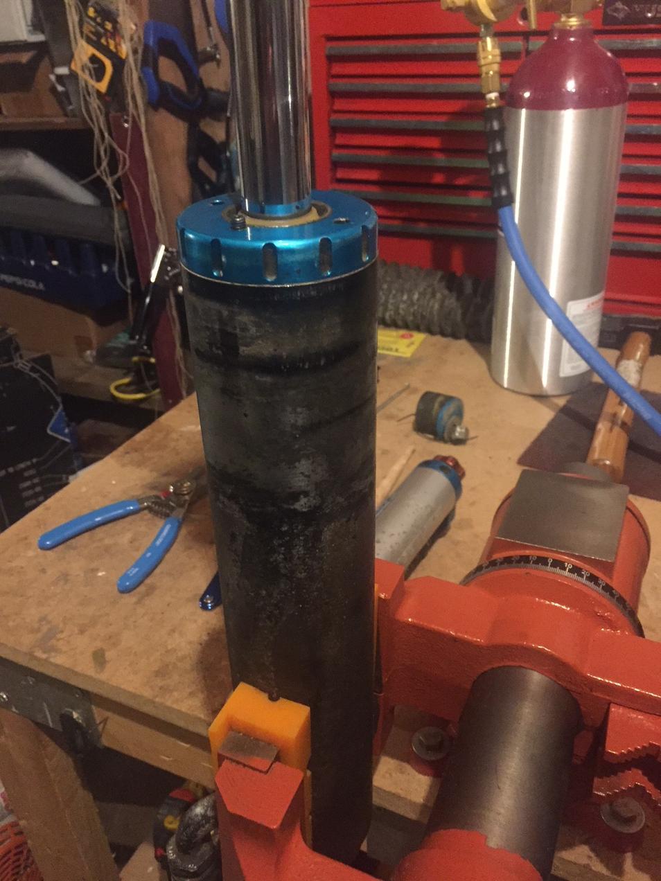

corrosion is manageable with proper materials. Here's my "war on rust" kit... a little bit of work in the spring and fall, and some ongoing maintenance in the winter has kept my king shocks looks great with a nice patina, and no rust.
icon coilover wraps and rear shock wraps protection.
The shock in the vise shows a full winter of reapplication of boeshield. I'll soak that shock body in boeshield overnight, and the pressure washer will get rid of most of that black.
Of course every time I go to toyota they tell me that my shocks are leaking because they're covered in oil....

There's a lot of very unhappy ford raptor owners because the fox shocks they use rust like a demon in short order. I'm not aware of any shock manufacturers that will provide support for corrosion. Anything exposed in the wheel well will get a nasty salt bath and rust very quickly. The zinc plating to inhibit rust gets sandblasted off very quickly because of the location.
Wow that's pretty sh!tty. Although not unexpected, at least for the hose fittings, the casings though I would hope they have a little better resistance than that.

Surface rust on raw steel, what do you expect? The resi canisters I would have expected to have held up better but nothing a little paint can't handle. Why aren't you blasting TC? Your control arms are rusted also........... Rust prevention is your responsibility, period. Reason I get under my truck at least twice a year to clean and paint everything.

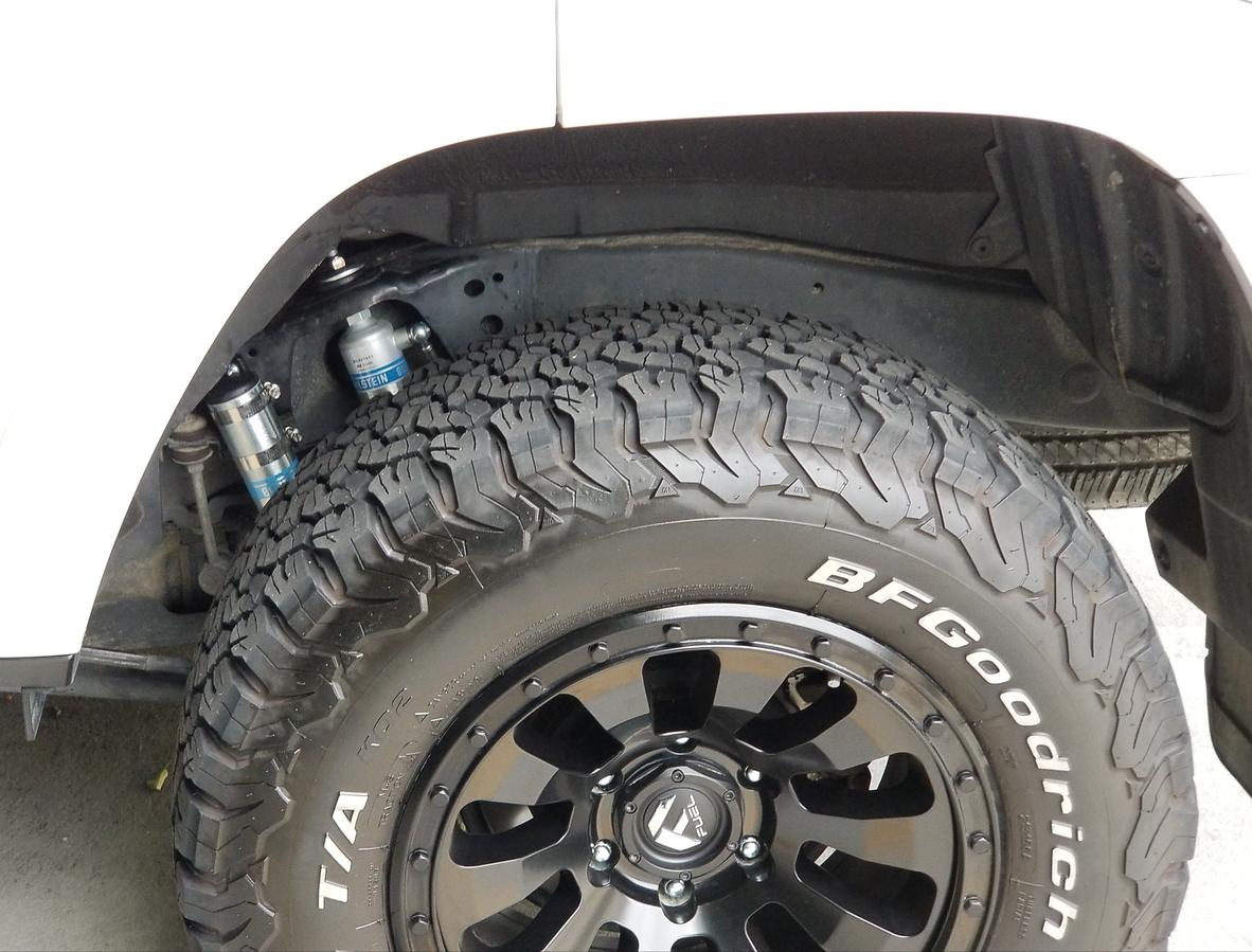

That Amsoil stuff seems like it would help out a lot. Does it really leave an amber'ish color on the shocks though?? Just slapped these 5160's on and I would like to keep them as fresh as possible for as long as possible...
