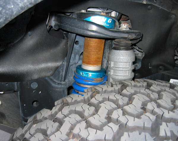

Pretty disappointed in how rusted my Toytec Ultimate Suspension is
Hi everyone,
It is up to the end user to maintain and protect their aftermarket parts. Toytec cannot be held liable for corrosion. If you look harder you can see the Total Chaos STAINLESS STEEL uni-ball has rust and pitting on it.
Water by itself does not corrode our parts in that short amount of time - plain and simple.
If anyone has any questions or concerns, please email me directly
[email protected]
This happens on ALL brands FYI.

FWIW - I've found that a lot of raw steel I've bought in the last couple years from chinese origins has rusted at an abnormally fast rate. I'm not sure what they're selling as A36, but it isn't the same as what comes from Japan or USA factories. My bet is that the raw product is some alloy that's prone to corrosion. Hell, some Japanese and European mild steel is more corrosion resistant than Chinese "stainless" steel products. Mostly it's just outright fraud in labeling a product as something it's not.
Every piece of raw steel sold in the US should come with an MTR (Mill Test Report), detailing the chemical composition of the steel and the steel should have a heat number correlating a particular piece of steel to it's MTR.
What is the Toytec suggestion?
Is it that the OP has been regularly driving the truck on the SC beaches and into the salt water?
That's the only explanation I can imagine that would be OPs fault. I guess beach driving could do that... but not positive.
OP, you been playing at the beach and forgot to tell us maybe?

No one has any clue whatsoever what those shocks you have sent have been through. I know EXACTLY what mine have been through and I posted it on here. I said when I was in snow I washed it a lot, and you blamed it on the car wash chemicals. Well, then I mentioned by “wash” I rinse with water, not car wash chemicals as my accessories don’t allow me to do drive thrus most places.
Again - obviously you consider this normal as you won’t stand by your product. That’s fine, I can promise that you’ve already lost 10x more business by off road personnel seeing these pictures and knowing you’ll do nothing about it, vs giving me a reasonable partial refund or a discounted replacement.
Mine were at the beach ONCE (June 10th, same day my dog of 13 years died) and then in some snow up north, but not the whole winter, and again, rinsed 1-2x per week.
Products are garbage, and it is clear I’m not the only one here that finds this unacceptable.
The partial refund probably still would’ve been less than your profit margin, but will now be far outdone by the sales lost. Good business practices.

I haven't spent one lick of extra time maintaining my Bilstein 6112 and 5100 shocks and 2-3 years later they actually look pretty dang good.
My Bilsteins on my Ford F250 were as well and they were way older and treated way worse.

The So CA guys remark, yeah mine look good.
....... you have no rain, snow, road salt, road gravel mixed with salt, mud, etc.
For those same reasons, guys down there can run UCA with Uni-balls no problem. But in the rain /salt states its just one winter away from junk.
Spray with silicone, couple times a winter, and thank yourself later.
Sure... I like how you just make assumptions about SoCal people. Ya its sunny here, but we also have it all. But just looking at a location in a post doesn’t tell you anything about me.
My 4Runner lived in Oregon for 4-5 years before we brought it back down here. On top of that, I live in a beach city where I drive on the beach, including desert and mountains for snowboarding.
Add a bunch of winter road trips to the middle of the country and back…
Again, no maintenance, no worries, no rust. At least nothing like the OP. That said, I would not object to silicone spray for maintenance...

While I do agree that under no circumstances should your $1800 suspension be rusting like that after 9 months...why are the ucas rusting as well? You can see in the pic the castle nut and the washers are rusting. There must be something going on with your roads

You didn't maintain your parts. They got rusty. Are you contacting Total Chaos about the uni-ball?
You live approximately 130 miles or so from the ocean, do you not?
