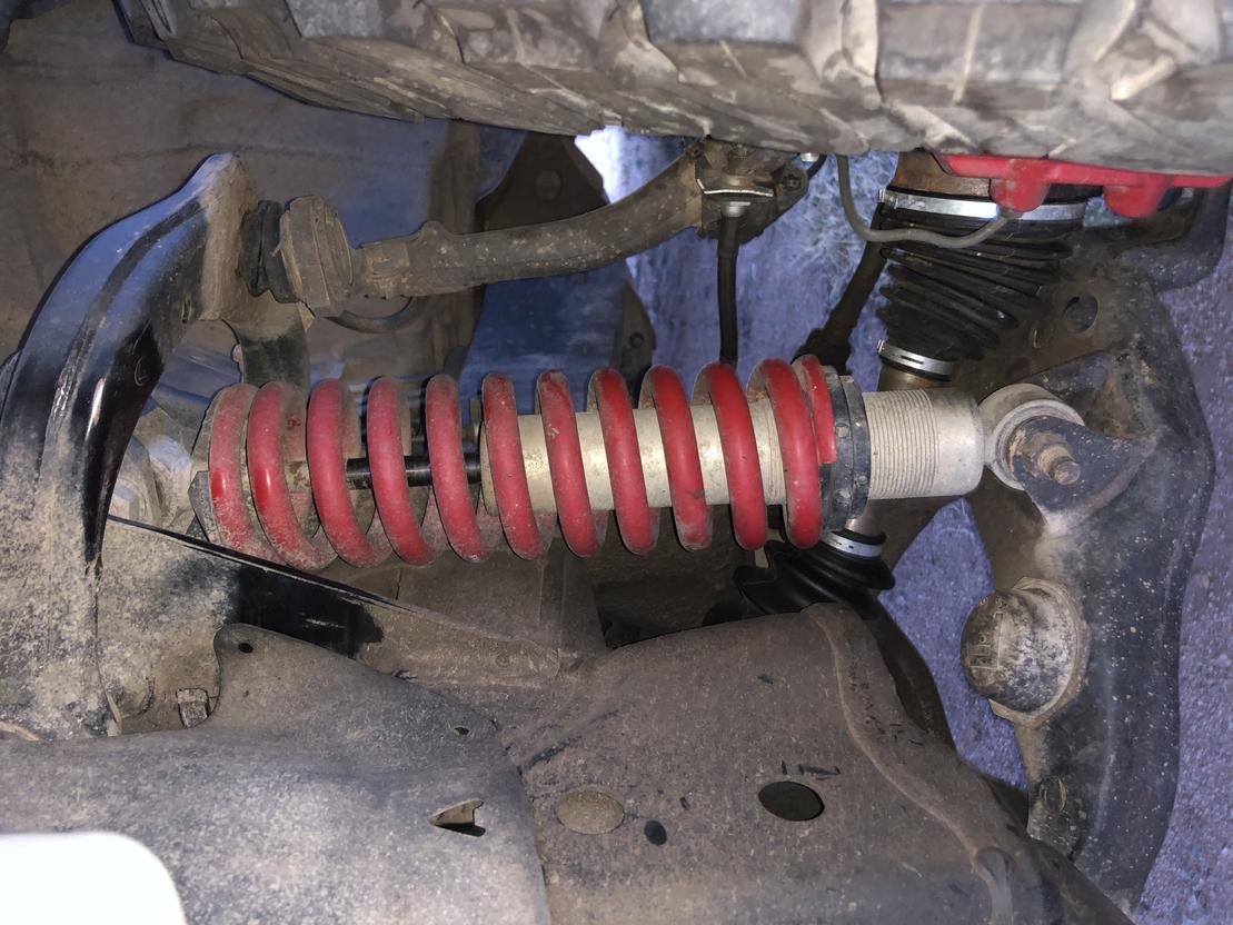

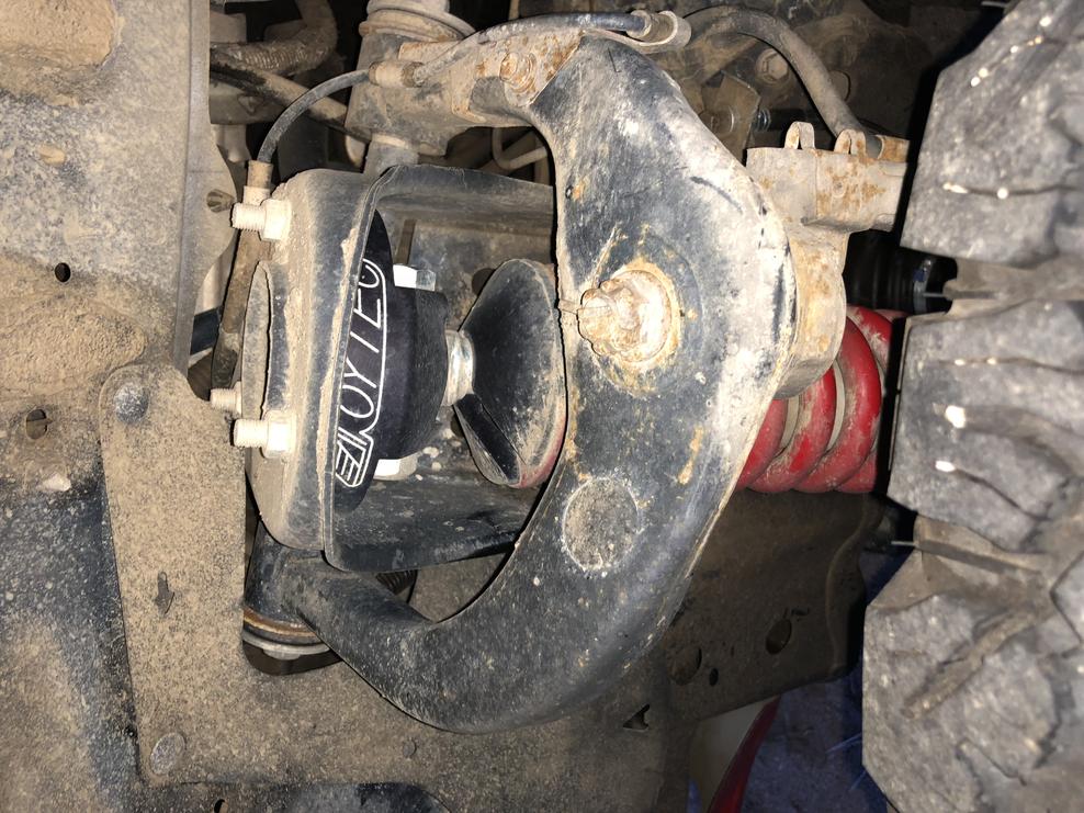

These are my 2 year old BOSS CO’s on my 3rd gen. 2 Colorado winters and I haven’t been the best at cleaning them.

Good luck ever being able to adjust the ride height on those. It’s damn difficult on my icons and they are only three months old and have no rust
