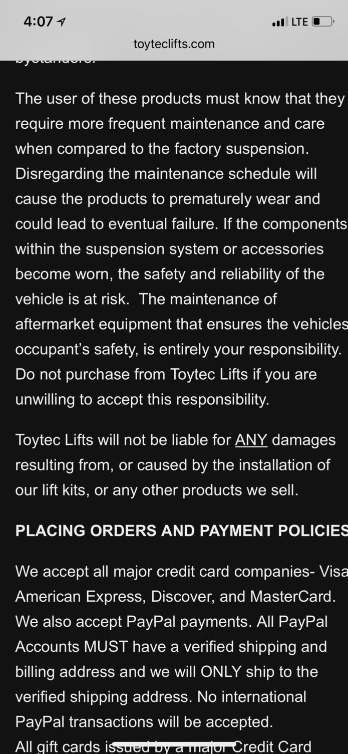

Interestingly, nowhere on Toytecs instructions: https://www.toyteclifts.com/images/stories/pdf_files/10upfj4r.pdf
Or anywhere on their site (granted I only spent 5 minutes looking in obvious locations) do I see ANYTHING related to necessary maintenance to keep the suspension from looking like garbage in a short period.
Yet, they have no problem coming in here discussing how “obvious and important” additional maintenance to prevent insanely excessive rust should be.
If it’s so important and seemingly obvious? Why not give some direction to their customers to perform this maintenance and the importance of it?
Edit* found something under their warranty section. Gives absolutely no specifics or direction though lol.
