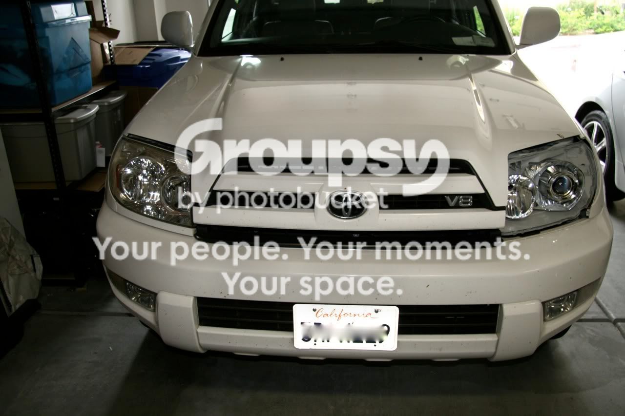

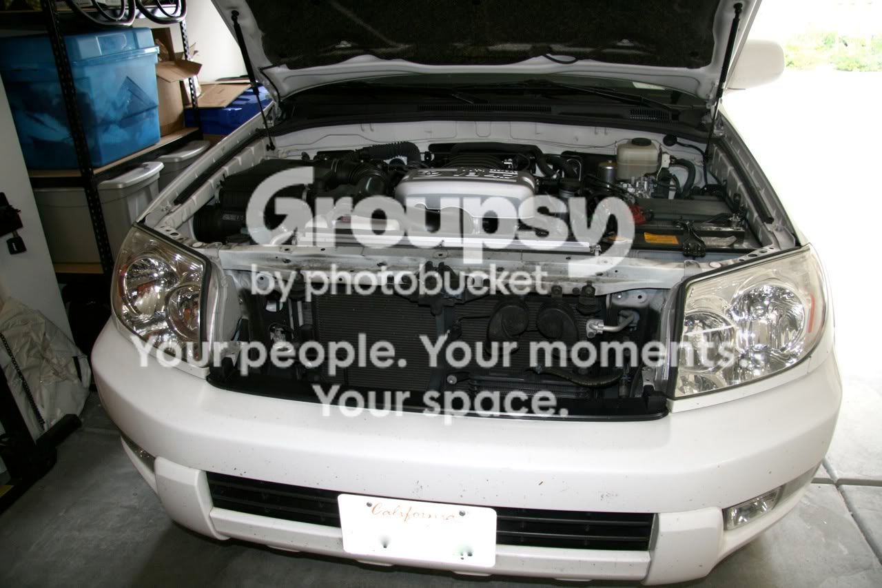

temp fit on driver side...old headlight on passenger side
HIDSet1-4.jpg~original
<p>

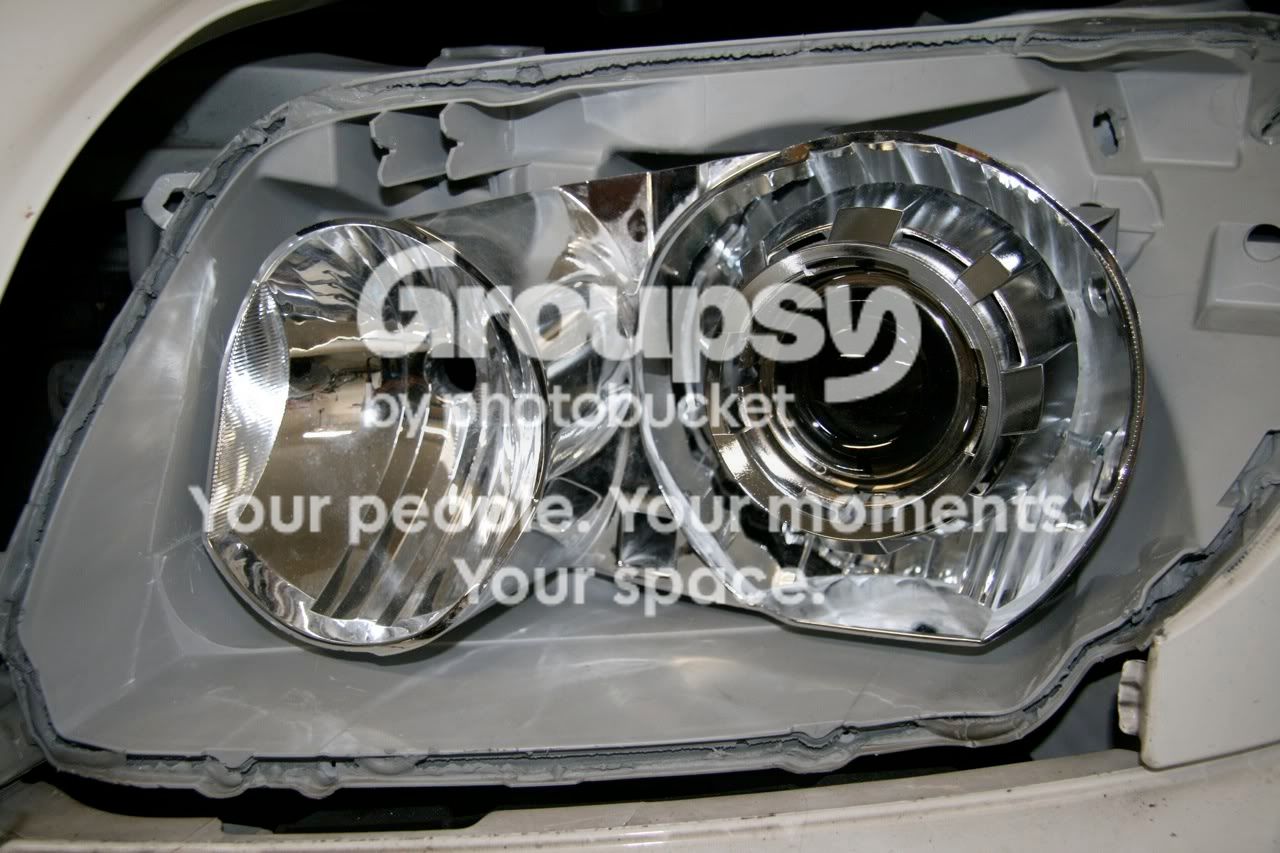

up close of temp fit
HIDSet1-5.jpg~original

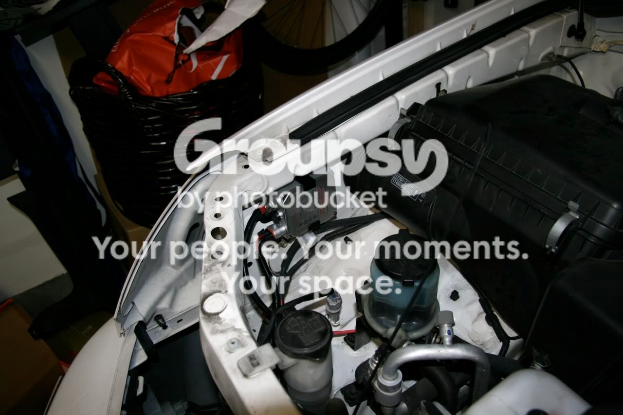

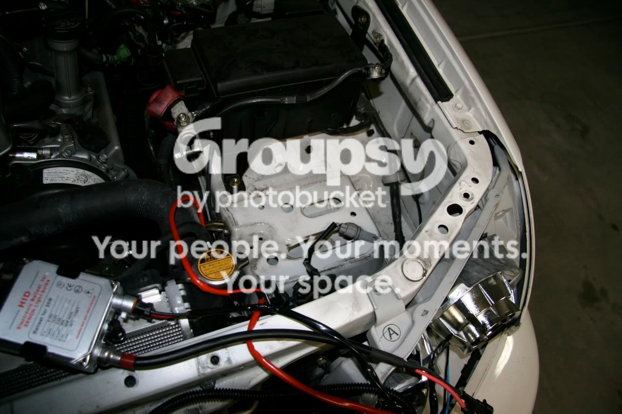

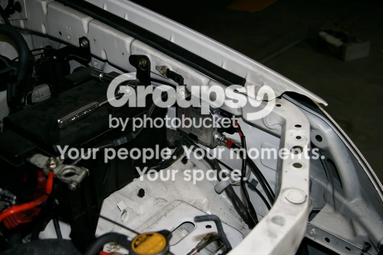

looking for a places to mount the ballast
HIDSet1-6.jpg~original

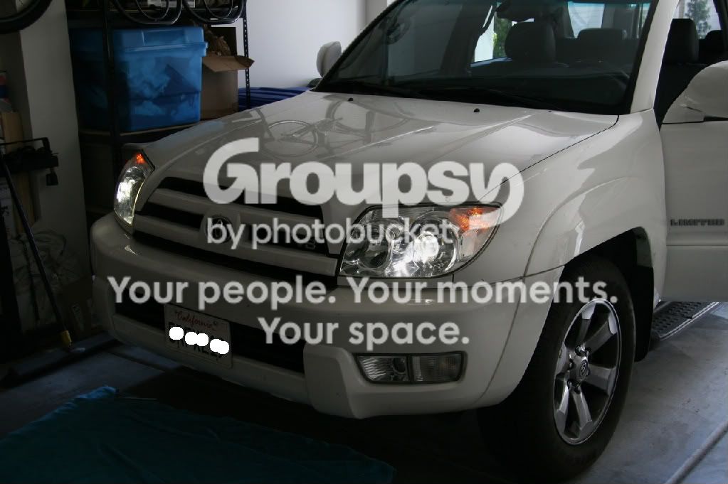

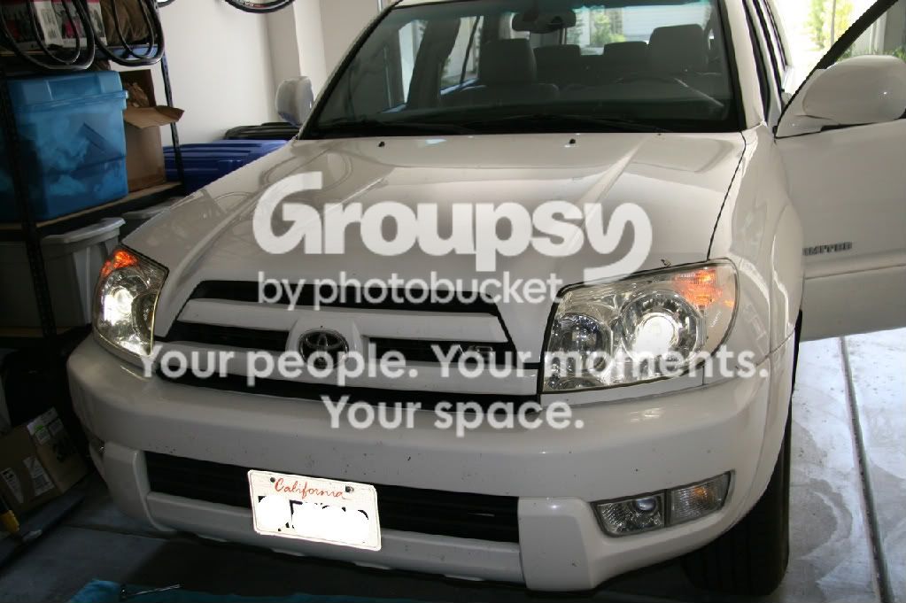

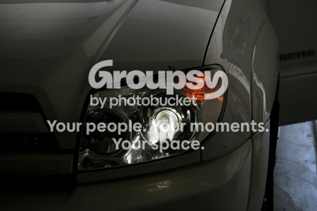

and they are in!
HIDSet3-1.jpg~original
<p>
HIDSet3-3.jpg~original
<p>
HIDSet3-4.jpg~original
<p>
