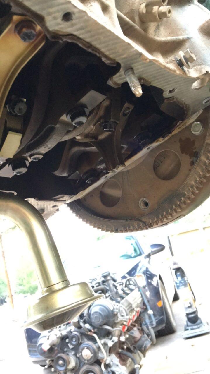

Incase anyone was curious, I have the original motor yanked and will be receiving new motor towards the end of this week. Wasn't near as bad as I expected, but still have a lot to go. TONS of wiring to be put back correctly.
Where did you get your motor from?
Had to pull the oil pan off to get access all the torque converter bolts... I think I found the problem with the motor....
I don't know how this didn't make any noise when the motor initially stalled out. The motor went from running to off as if I turned the key..
I probably could of replaced the rod and potentially had a working engine for much cheaper rather than buying a whole new one.. but now I have duplicates of everything and shaved some miles off...

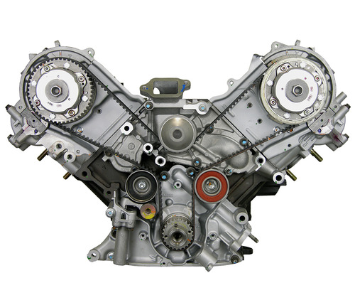

Now is great time to change or at least inspect the timing belt and water pump and exhaust manifolds!
I had a really hard time changing my timing belt. My pulleys for the valves look nothing like the ones on ANY of the write ups or the one you have pictured. Mine had no notches on the pulleys themselves. I made A LOT of marks with a paint marker on the belt and the pulleys. Then transferred the marks from the original belt to the new one with the teeth lined up exactly.. It should be good but I'm still extremely nervous because I didn't have the reassurance of having the notches
Mine is like the ne pictured
Marks are still on these pulley's, they're just harder to see. Yours look different because yours has VVTI. You need to be 100% sure that the timing belt is installed correctly, and also DO NOT let these camshafts spin on their own when the timing belt is removed, or you can just about guarantee that some of the valves will bend. I don't know this one by personal experience, but have witnessed it firsthand by an old coworker. My question is though, do the pulley's on the old engine and on the new engine look the same? If not, the new engine isn't going to work in your vehicle.
Pretty sure that the reason the FSM says to rotate the engine 50deg BTDC is so if those camshafts spin it won't damage the valves. My blown motor cam pulley's moved and if they hit, pretty sure you would know it. However I haven't pulled off the heads yet to look at them. So we will see what happens!
