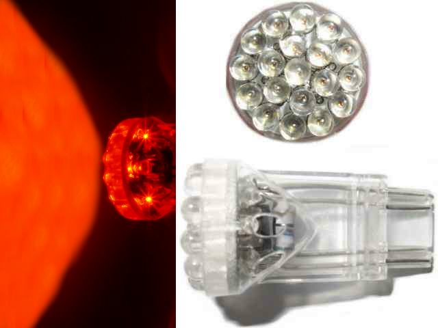

Pennywise, I used 4157 LED bulb. Its 25 LED pre-made bulbs from www.autolumination.com.
I contact ground to the upper fixing bolt of my taillights. First I contact it to the lower, because it was easier, but then figured out that it has bad ground, so I reconnect my ground to the upper one.
Here is the image of 4157 LED bulb:

The leds run very cool, almost no heat is generated. The resistors used to limit the current will get hot after a while, depending on the current draw and the resistance value.
If you buy the premade bulbs, they are a simple plug and play. If you make your own led bulbs, you would need to do a little homework to determine the resistor that you would need to limit the current to a safe operating range for the leds.

I didn't put any resistors. As Pennywise said, I used plug-and-Play version. So it works fine as is.
The LEDs I got are red. These ones will perform better then white. Its Optical Physics, red light-filter will let only red spectrum pass. Red LED produce red spectrum, white one - all spectrum, so the white one will be divided to different colors and only red will pass. Sorry, it's a little bit complicated, so I tried to explain it as easy as possible.

1. Yes, its 25LED bulb and it's actually very bright. If you look from the back it

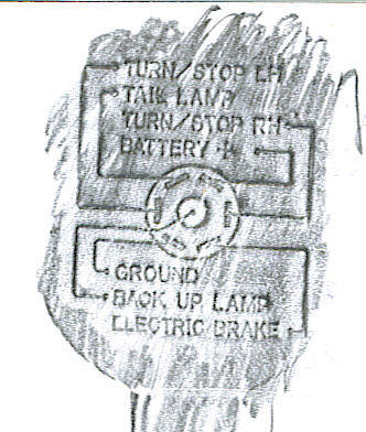

Tow Lights
All of you might have this already, but I thought it woun't hurt to post it any way.
I am thinking on doing the Tail lights only set up.
I ordered my 12v 5w honda bulbs per TRD04RUNNER's set up.
