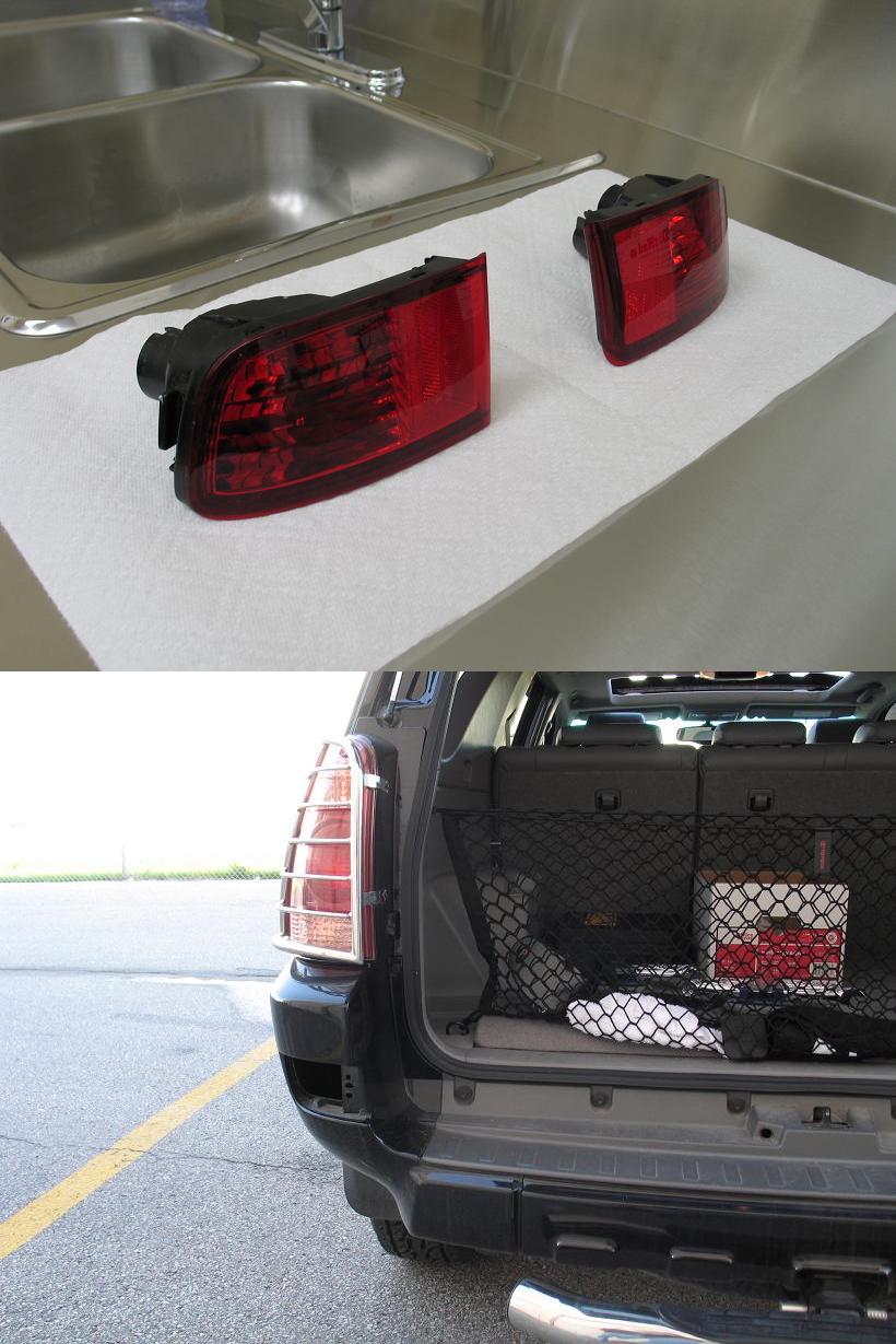

So I took the rear bumpers lights off.

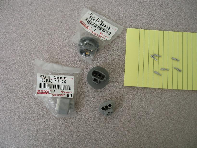

Then I took the connectors (thanks to kmvreter), some female connectors from my local auto store and 18ga wires.

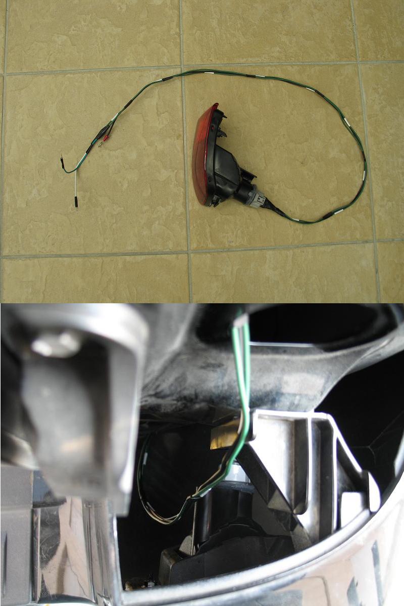

After it I wired them up and put them back in the vehicle. Yes, it

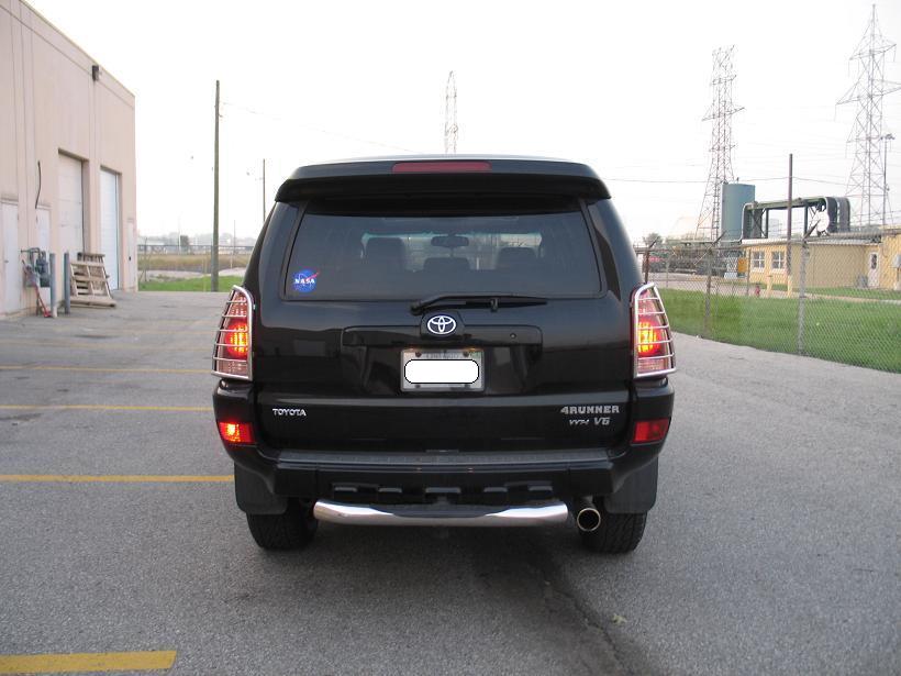

And there is the result. Left bumper light is wired to the vehicle. This is parking lights, brakes will be much brighter. You can see the difference between working and not working fog housing. It looks great for me, plus its safety, more lights on, earlier you'll be seen on the road.
AlexJet,
Looks great! They look brighter than I thought the led bulbs would be.
I can't recall if you bought premade led bulbs or if you made them yourself. Any information (pics) on the bulbs would be greatly appreciated. I know that these tubes in the housing are very small and not every premade led bulb will fit. If you could clarify the bulbs that you used, this may be very helpful for those looking to do this or upgade there filament type bulbs.
Did you use the bolt for ground or did you tap into the ground wire used for the other lights?
Thanks and glad to see you made it work!
