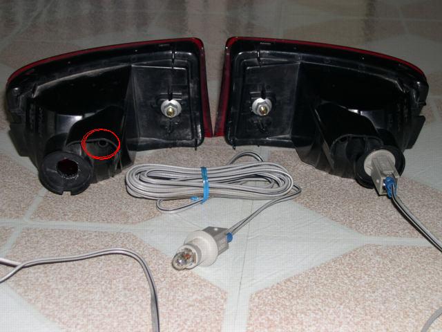

i finished mine today, same setup like TRD04RUNNER.
question: on the lens, there's a cap (red circled). Should i leave it ON or OFF.
You don't want to take it completely off, do you?
Dirt and moisture will get in.
I just opened up the membrane and pulled the rubber cover deal out some to expose more of the venting holes that are molded into the rubber cap.
Correct. That's what I did. You want to provide venting without letting anything in.
