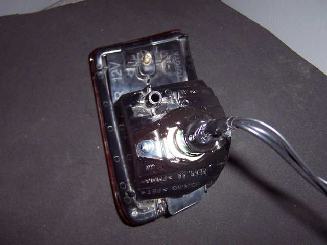

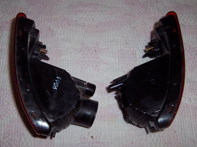

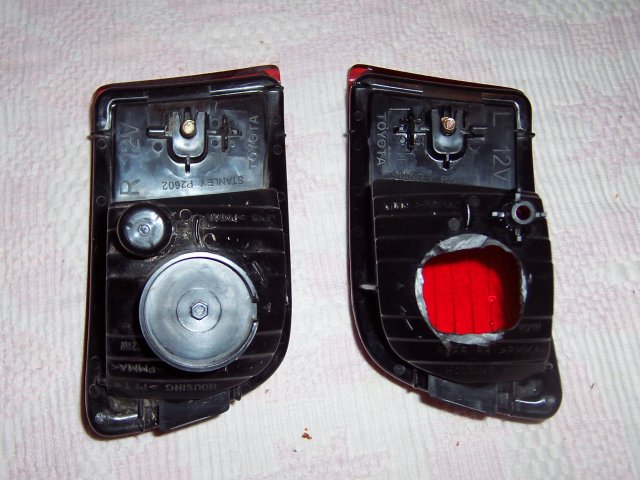

I chose to use a Dremel and hack the whole round end off so that I could mount the sockets properly. I also smeared Goop over all the holes that were left after mounting the sockets.
Goop works well. It dries fast and leaves a rubber solution that can be removed easily to change the bulbs. I have first hand knowledge of that as I forgot to install one of the bulbs! :bash:
Anyway, I took my time and did it right. All the wires for wrapped in that black spirly casing that is available everywhere. It's very clean and very cool! Here's some pics ...
Tip: Before installing, make sure you test the bulbs to identify the brake wire. It will be the brightest. As suggested earlier, ground wire to chassis and touch red battery post with one of the other wires. Good luck!

Last pic 3 showing the Goop ... The earlier pick of the lights in action on the other 4Runner is exactly the same as mine.

Hey, just got an 05 4Runner and wanted to make the rear bumber lenses functional. Great write-up but I have 2 questions...
First, how to I identify the lens vents? You mentioned taking them out but it's not obvious to me where they are...help, please?
Second, the socket I got has two leads a red lead and a black lead. If I only want to connect for the brake light and turn signal can I use the black lead as my ground wire?

They are little rubber caps on the back of the housing... simply pull them off.
<I>
Second, the socket I got has two leads a red lead and a black lead. If I only want to connect for the brake light and turn signal can I use the black lead as my ground wire?</I>
Red is likely the stop lamp, and black is likely the signal. (but don't quote me) The socket exterior is ground, and since these lens housings don't have a ground on them, you'll need to solder a ground wire to the socket exterior as indicated in the instructions.
