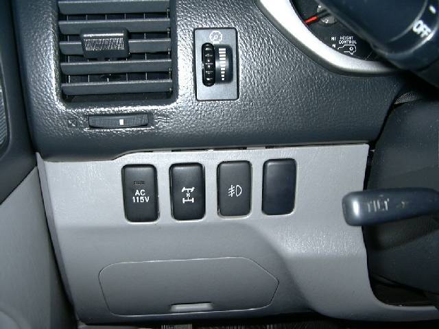

Ok. Got the switch in. All wired up. Here is a picture and part#.
Switch Part #: 84160-04010 ($80.38CDN)
Connector Part #: 90980-11090 ($4.25CDN)
Connector Part #: 90980-11090 (makes it easier)
How much were they? Sorry if you already said somewhere, I don't remember.

I know.. :( but this was the best way for me to keep it stock looking and without much modification.

Connector question...
iForce (or anyone else):
What kind of terminals did you use inside the connector? Or did it come prewired? I'm looking to do something similar with the switch but the piece of the puzzle I'm missing is how do you make the wiring connections at the switch. Do you have or can you take any pics of the actual wiring inside the connectors? Are the terminals available other than at the dealer?
