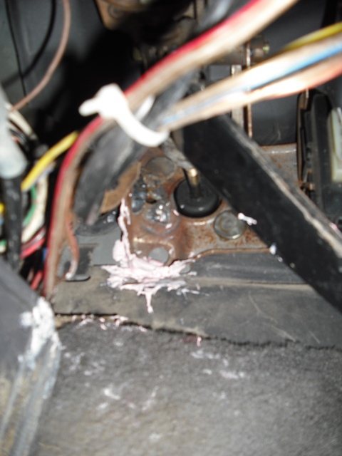

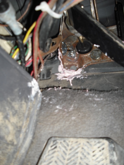

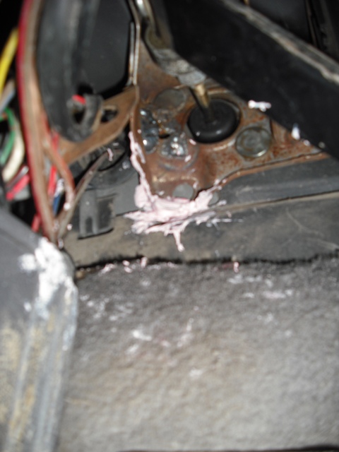

Two months ago the following happened to me but I have no time to write. One day I prepared for hunting and I decided to uplift, having got into the car and pushed the clutch pedal sank at first thought the brake pump sucks or is a tube in the system is loose. But alas, once looked on every side I saw a plate that attaches the clutch pedal has broken. In this situation the car could not move under its own power and left me nothing but to seek help from a friend. Of tugboat went to the nearest welder CO2. After a long and explain it with great reluctance Blood plate, and said it should be removed and thus saw to make it properly. So the next day with much fear and not trust went hunting. Everything went without a hitch. But I had to find out the reason for the shattering of the plate. After the study found that a factory curve at the bottom of the plate in which resist pedal. And then wonder what unknown to fill this recess decided that the car kit will happen here is the result.
