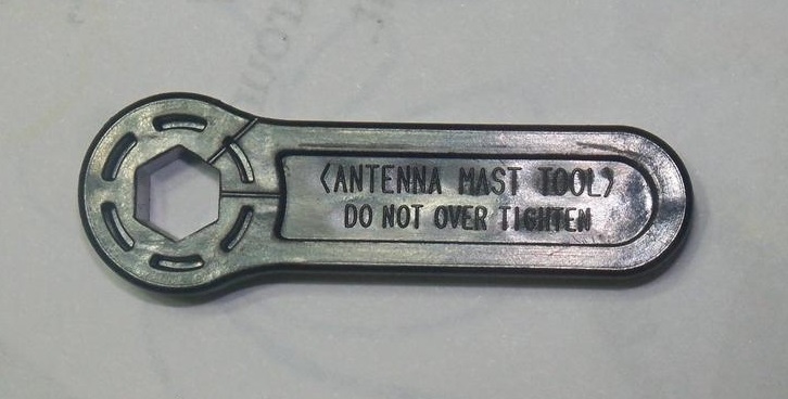

Tighten it with a wrench, if you hand tighten it the waggling back and forth will loosen it up and it will eventually fall off.
Most auto parts stores sell plastic wrenches that won't damage the antenna base, or if you don't care (like me) us a crescent wrench.

Or you can just use the one that's suppose to come with your 4runner :)
