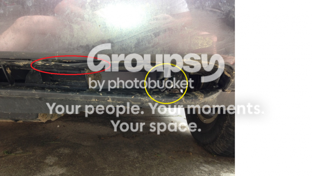

Here's a before picture. You can see in the yellow circle where the vertical plastic stabilizer has broken off. The red circle shows the permanent plastic deformation when it bent on the rock... so off it goes.

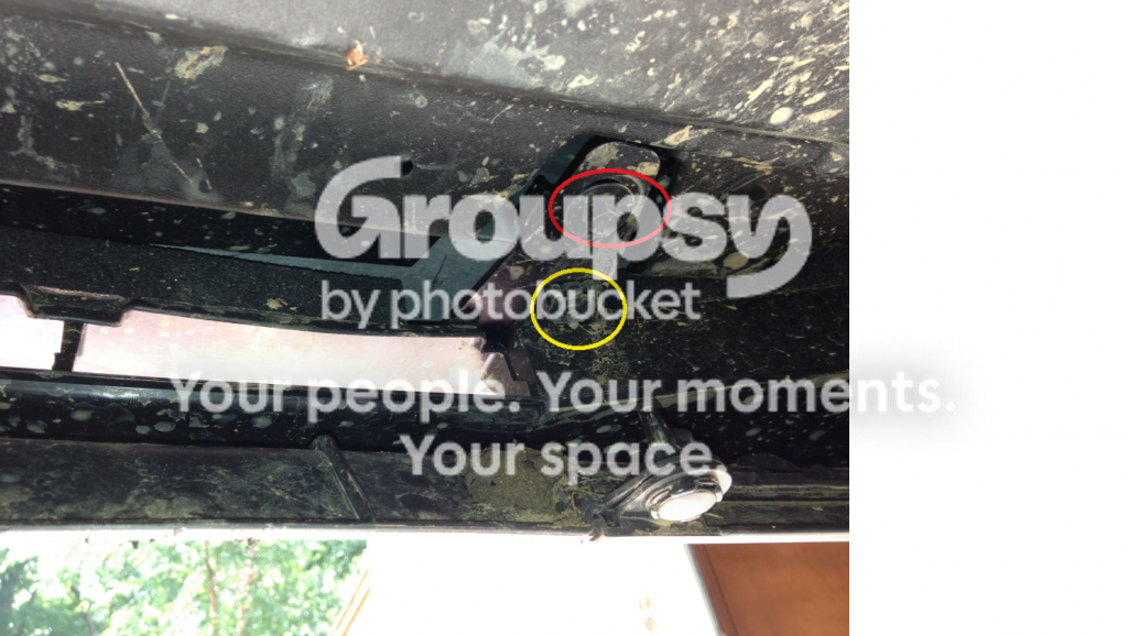

Here's a shot from underneath toward the middle of the vehicle, looking up and slightly forward. The red circle shows where the bumper mount is. You don't need to take this off until the end because the air dam has a closed loop piece of plastic around these two mounts (other one is just a few feet away on the other side of the vehicle). The yellow circle is what you have to remove, but you have to bend your hand around the surrounding plastic with an 11mm hex wrench. I had to push up on the surrounding plastic to get it out of the way enough for my wrench to fit.
