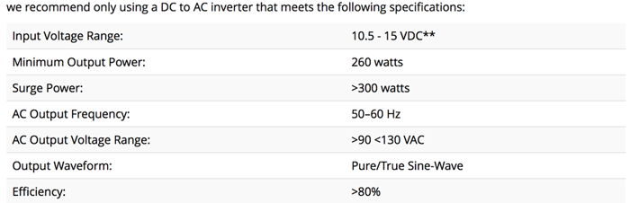

I'm trying to figure out if I can use a specific Lithium battery charger with the inverter/outlet back in the cargo space.
Here are the charger specifications:

So from what I'm gathering, and if my brain is working right, I'd be ok @ maximum capacity of 400 W, with the shift lever in P or N, as far a meeting the charger specifications. But I have ZERO idea on how I might verify the Inverter's Output Frequency, Voltage Range or Efficiency?
Any thoughts?

You can't verify frequency without a scope or frequency meter that will measure 60 cycle range. You can however plug an incandescent (not CFL) light bulb into the socket and see what it looks like. At 50 cycles you might be able to see it flicker. At 60 you shouldn't.
I think you will be fine, what they "recommend" and what will work are two different things. My fridge is UL listed at 6A, but I don't believe it pulls that much, and it's on the inverter for now. I UL certify control panels at work and they don't use even close to what we are required to put on the schematic. Try it out and report your results.
I don't think the factory inverter is pure sine wave, but I may be wrong
Sent from my HTC6525LVW using Tapatalk
I don't think the factory inverter is pure sine wave, but I may be wrong.
I bet you are right. I'm seeing a lot of speculation that the factory inverter is not pure. But I can't find any confirmed data or specifications on the factory installed parts.
