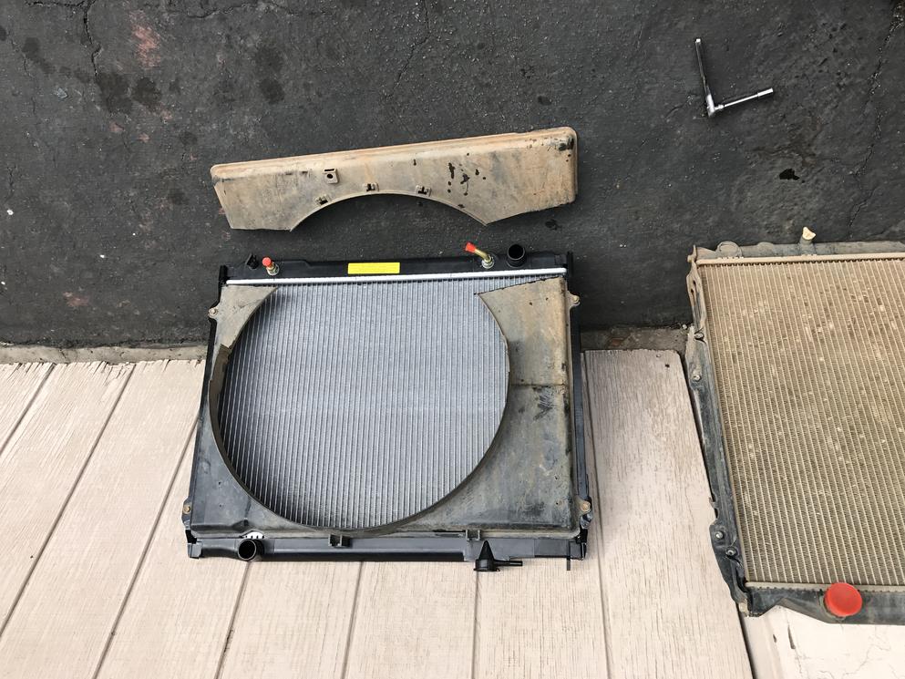

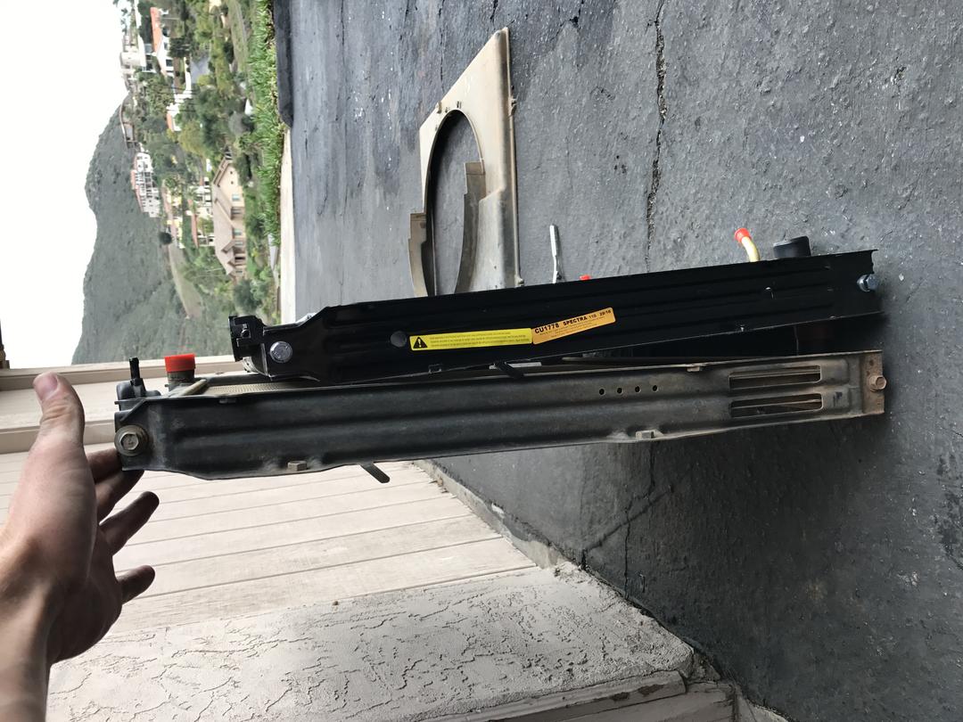

I put in the OSC #1985 radiator for a 3.4 V6 Manual Tacoma this weekend.
It's shorter than the factory 4Runner radiator, so I had to cut my shroud at the bottom. Also, the Tacoma radiator uses a different cap than a 4Runner, so I had to go get one from the parts store. Other than that, it went all good.
Same coolant temperatures as before ~190
The OSC radiator seems to be very high quality even though it is made in China. I trust it much more than I would a TYC rad.
