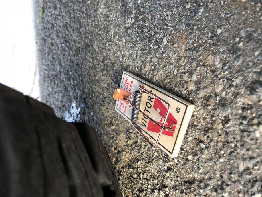

Believe it or not, my secret weapon for getting rid of them for good is....
