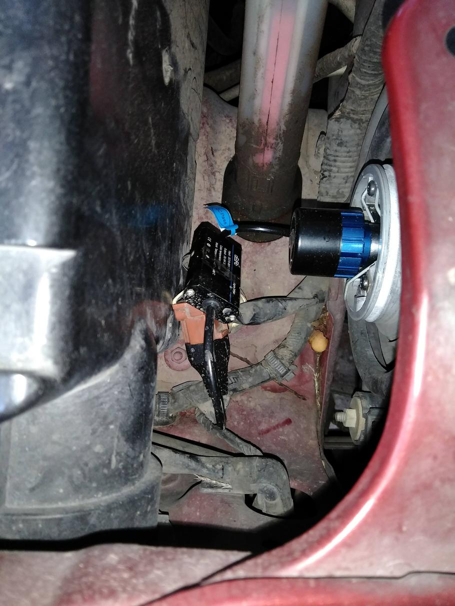

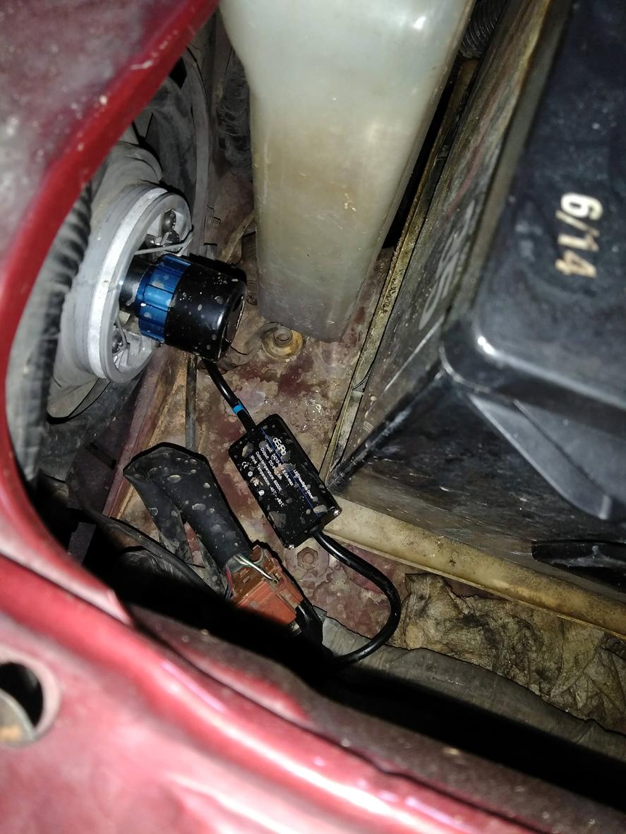

My set arrived today and I quickly installed them. Some notes:
IMG_6128
Installation was easy. As the mount ring does rotate around the 'bulb', they should be installed with the cord down and the two sides with the longer LED arrays up. The shorter ones go down - and the fact that there is a shorter side is somewhat of a problem. More of that in a moment. I installed them without boots for now. I've got an idea on how to protect them but I'll wait until I see if it works or not to speak up on that.
