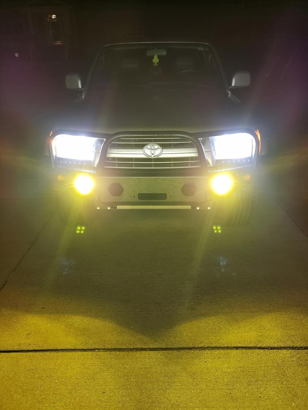

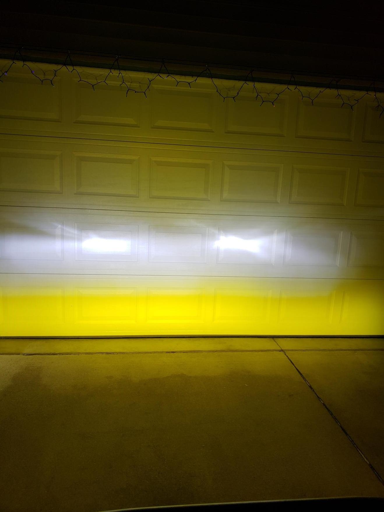

^^^ this.. So I got new aftermarket headlight assembly which are still glass like OEM and I'm still messing with the alignment.
I need to post better pics without my Baja Designs Squadron Wide Cornering Amber (I use them as fog lights :D)
Also my driveway is at an angle so don't go off these pics.
What I can tell you is that my old LEDs, I get flashed every day and I haven't been flashed at all with this set.
When I am behind someone, I think it's actually aimed down to where I don't see the headrest or anything inside the car... Most of the light is either around their bumper or wheel.. Which sometimes I think it's too low but I'm totally fine with the amount of light/distance it throws so I will keep this.

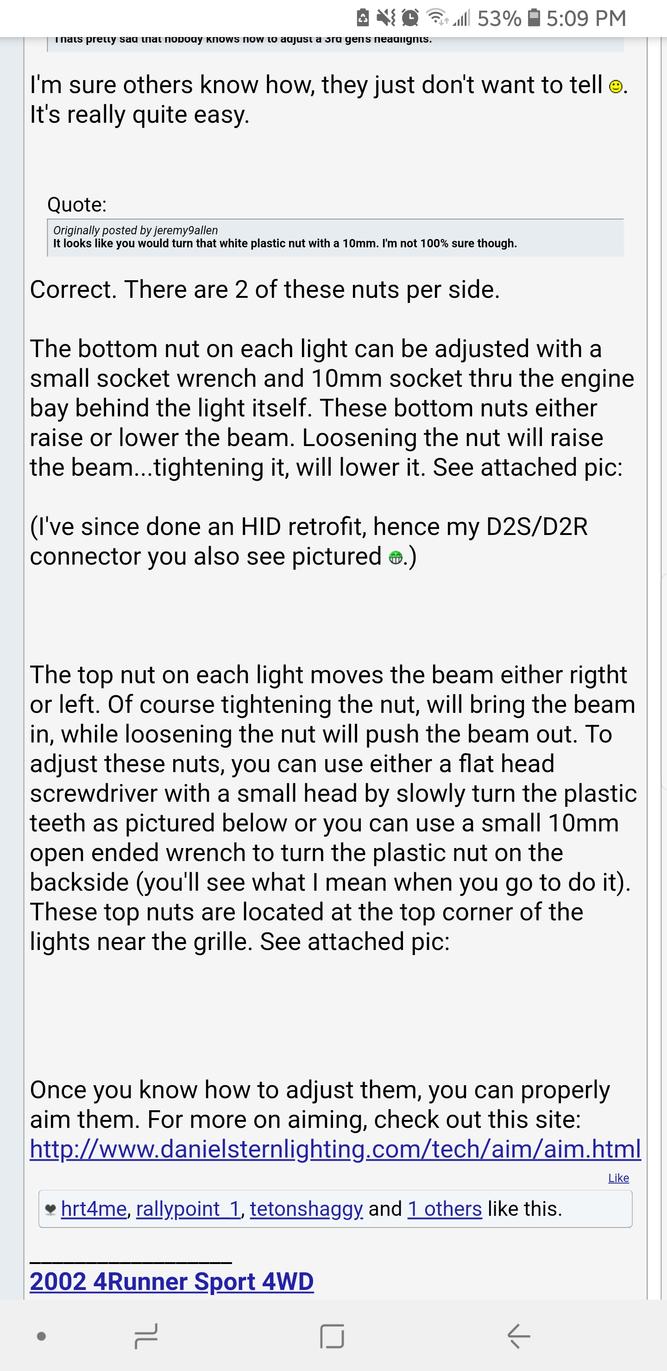

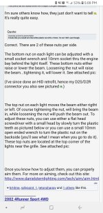

I took a screenshot from another thread I forgot where I got it from on how to adjust the headlights. Pretty easy with a Philips screw driver and a 10mm socket
