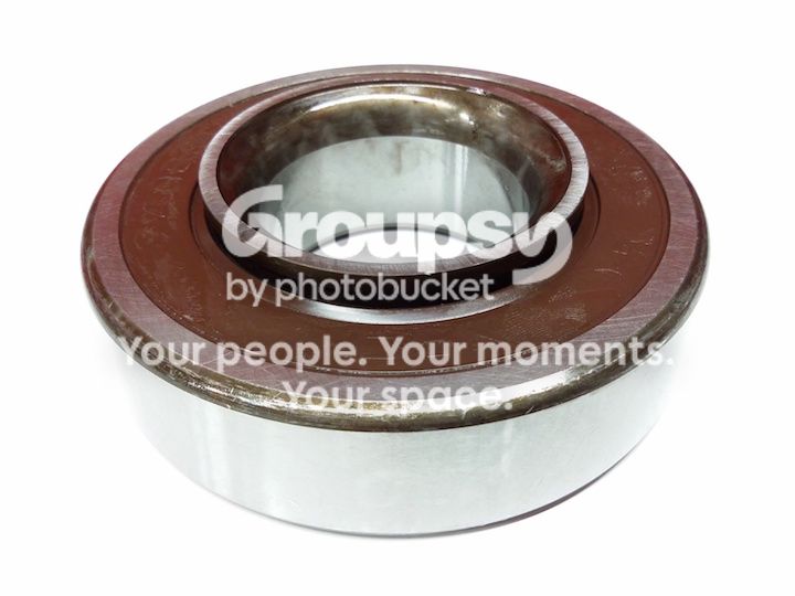

Looking up the Toyota part number online yields 90363-40068. The picture of this bearing shows an extended inner race:

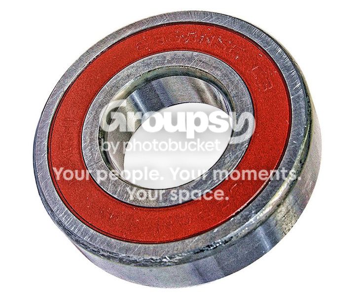

When I look up wheel bearing kits on sites like Marlin Crawler or even RockAuto they show a standard bearing without an extended race. When I did the wheel bearings on my 1988 4Runner I recall it had a standard race. Like this:
Normal%20Race_zps2uxbybl4.jpg~original
If I can confirm that my truck uses the standard bearing style without the extended race I can just order a premium Japanese 6308 double-sealed bearing and be good to go.
I seem to recall reading somewhere that the extended race actually appeared in the 2001-02 4Runners?
Any guidance here would be appreciated!
That bearing is for the 2001-2002 years

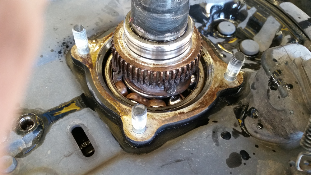

When I bought this runner, I thought I was good as the PO had a receipt for axle seals AND bearings being replaced around 40K miles ago. Few weeks ago I was driving to Cali from Az and coming off the hill into Thousand Palms area, I started to hear a funny noise. By the time I stopped, got gas and started to drive again, it was clear there was something VERY wrong. Felt like one of the rear brakes was hanging up and I had a terrible grinding noise. Luckily I brought tools with me and took off the drums / all was good with the brakes. Without a lift, not much more I could do in a parking lot so I took it into the only shop open on Sunday. We got it on a lift, did some troubleshooting as i could not pinpoint the noise driving or find where the hangup was. We found the left rear wheel hanging up. I pulled the ABS sensor and whoa! It was a MESS inside. Luckily the shop let me run the project / use their tech as a helper - labor as their techs experience was limited. Painfully, they only had a small press with limited tools in the back. This was more of an oil and tire shop willing to help but it ended up saving my bacon.
We got in a replacement bearing, seal and race from Napa... the rest was a nightmare as I did not have any of my specialty tools with me. We ended up cutting off the seal race, somehow getting off the ABS ring and rigging up the assembly to press the axle out of the hub / bearing. In total, about 4 hours of pain and suffering for what would have taken me 30 minutes with my tools. But we got it all done and I continued to cali - no issues since...

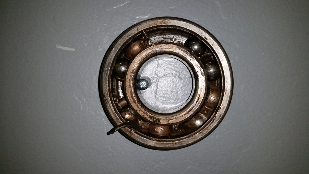

What I found was: The shop that supposedly did both bearings and seals only changed the left seal! But charged the PO $1200+! (and people wonder why I trust 0.0 shops unless I am standing in the bay with the tech) It was noted left seal leaking which is why he had the work done. When I pulled the left side apart, it had an aftermarket seal but OEM bearing. Right side still had the OEM seal and bearing. It was clear the ABS ring, retainers and such had never been touched and both bearings were OEM.
This bearing was fine for the last 40K miles as it has been almost all in town and low speed. But when I got on the freeway / 80mph for hours on end, she let go in a bad way.
Mounted that bastard bearing on the wall in the shop.
