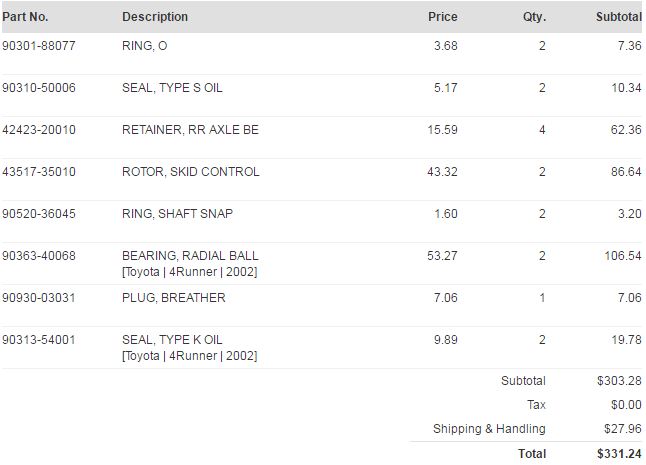

Here's an updated price and part number listing since the OP one is a few years old. I had to move my top retainer ring almost to the very tip of the machined portion on the axle (about 2/16")
Toyotapartsdeals was the cheapest online place I found. I just finished mine for about $450 total. The driver side was barely leaking but I went ahead and did both sides because the truck has 97K on it and it's a 2002. It was time.

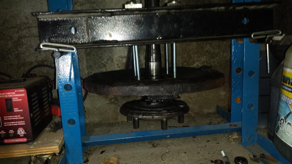

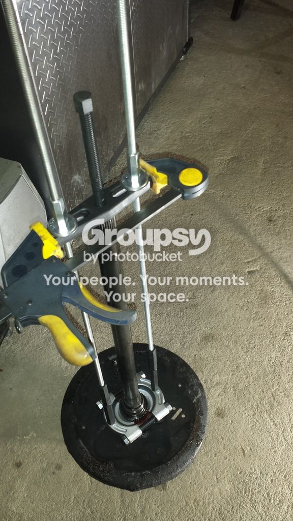

Hardware needed is only two 3/8-16 threaded rods, 4X 6inches 3/8 fasteners of any kind for the bearing separation from the shaft, and some metal plates. All available from your hardware store.
Here is the layout with the threaded rod and bearing separator kit. The puller is a part of a bearing separator kit. The long, black bolts at the bottom are also part of the bearing separator kit. It was pretty easy to remove this way. Just be sure to turn the puller screw just a bit, then un-tighten, screw the rod screws, then pull a bit again and again, so the puller screw does not get crooked. Took about 5 minutes of pulling. The clamp is not needed, I installed it for security reason. Use an impact on the puller screw if you have access to one as it will ease operation.
20161118_224619_zpsfgv0hz2g.jpg~original
20161118_224631_zpsgtbxo0dj.jpg~original
and here are a few views of how to use 6inch fasteners and the press to separate the shaft from the bearing.
20161119_002104_zpsgbytmis8.jpg~original
20161119_002035_zpsdh0ddv4w.jpg~original
20161119_002111_zpsguycgn6p.jpg~original
20161119_001959_zpshxnsgx44.jpg~original

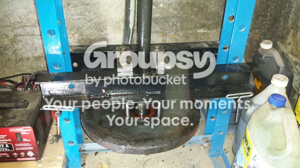

here you can see where one of the nut, on the 6inch fastener goes. It takes the place of the four studs that holds the axle on the diff assy. It took most of my 12 ton press strength to start it out. Do not forget to remove the retaining ring like I did at first! The 3/8 fastener are the correct size to go through the stud openings.

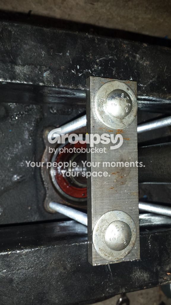

The re-installation process is pretty straightforward with the press. Just make sure the hardware goes in straight as even the ABS ring had a tendency to go in crooked.

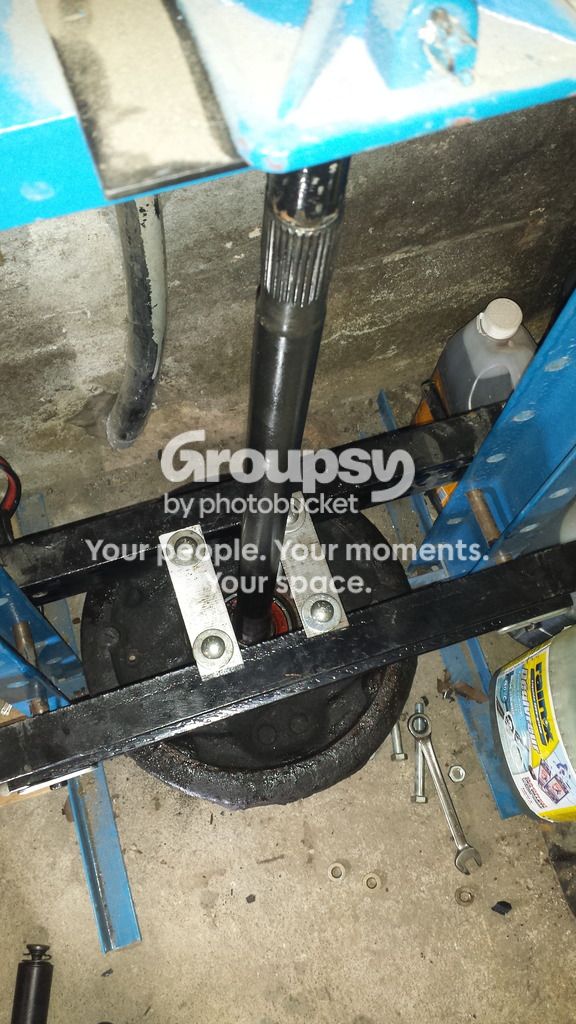

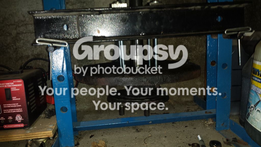

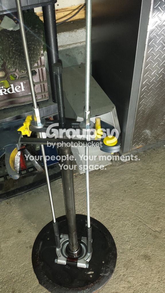

Hardware needed is only two 3/8-16 threaded rods, 4X 6inches fasteners for the bearing separation from the shaft, and some metal plates. All available from your hardware store.
Uxoh610diGvVF--NYLrr7KPtnvUdwDrNZha1ZgpLE9f-oCtttfabzbHdbdWOHOmW6RK9wZcJkmPY29xuQLNjHw1JTLEdY3HIGXyJIFOVPfvBxybd4Ji1d0AtIxi6s2lCVhCI3Xz1XRvJZJkKe66afUsMf4iril9UavxgS-kLQ071A-Rd8Nx4ihCdhd9gJrZY7LgI-A7gU9SPnt-wAk4SyGze-PG8eQyUsV0WqXdWD4U_qb8rDkwUEXbZaGP-ZLYPOuQpHPTQfE2GBkYcWzpCK5XB61H1qI5FeRwYLM_GRFCIlhkCOhomeByE4bNFipIeBoWIkoc2IhxY4vZyvO9kVnGKmV8jqp9BAPYEiUKjDukAbHA9mHtdMe7vDIgalaRB1FTnh5s186W0I8Kbe013yp9C0sugpCLbsJ4JwKy3Z6EaOLoogBG8TnIRIlNDoxYkjcafoPSeUNDxqiXRMWYjjoCuEgtNtBqpFCl8bI0QGbsFxuzceokKpUQPHwawmGeacZKu5JNKCoMd9sVHoM3n1xjLlyO7zqssqHCSQ-wmWJUyQ7Ea_vjHeksoxMn6LhzQ7qqVNQd6MnVlnyH2a4yVmUL_YrD8fPeuyzKjizjvgfpb3Z8=w535-h950-no
m-_SyOZHDsluE6H3VScYoKDZ0x6SKtW3FgSM5vtCW2GL4_pnsN3LRiWVv7pE3EopG0WnKOmSxUveTyqddXXydeAEvSyL18WufqwlZQUUoqxiaYOK8oIhamGm4phM8YBt7dl5tBFKDpG7LwvYosXe-B01NpOzIdbwXTBu0Ggr4ejWStKP9owcdtk9EP-ZntU12UYQVerwZPxm5QKsn0tJUbkmB126mQvpj4DRVQrwFbHSKL728svNgb7sVH2_UlsHFXh8AOI063JkGM4vWUiJ2oOL5MDi7DKC9IgbJ46xebQVX74ycQj0SOsQ3leHFk1q1GLFjPd7rhPucwyZXluGK3kQ4eFeZo4B-iFhbO7E89qmpr8S102B2vx3ZEUilhtIgASnPqWDYTAj5wIPk3NZt7dM1mX9nMK6S6Ibj-uHgFQUVGaLSQ-3z3wrlFKB6Fi5NDRqibuMfsfgGQXKmt80qOBzBX34LbqjnRLuXw9YkqQ0ctuall3kbMqvK3wJKHK4cBYn48BX8ED5ioGLg0xOgUjWMJoJKdH-dL_TGyEPjRtC8BznMe9465ykXwNvHi8pBT8MHovYkum7YHmhMJStODoq-B6B5DbFdIg8zNr74e4EqJA=w1689-h950-no
FzsNM4_5k2bXp5I561CiDiQ6J86IkfhMkZLLe9G9UAR2YW2vtnjoiTW9EcwRHWaXuoKeNO-LQL0saUcObirW5hAoB9iOkt5x4E8YecyJs5u9VW3CJXJNq3tTA0hgWxcjgYVdDSyhHJmw56CbqRb7GzfJGzsdG2zH8UXiXRn_5tzO0lbxOuF4gJHUdx86cj9gvkrF5XUV4e0-2Qo_0L3ZU7sQ2Lb_OxTMkykMV2hUCy-dM-nXb_Oj1X5AgJwneDCcmYFYwLaz4YiEQPme228hOkAe97cGjONWaZHA_8hX0hMqAj2UtlNwetqQmNy-sgs-uM31QHlwlg8p4c0GoSAd71Lqt-z7ZGnTcOtJUVgBGOMVNE9x2WgTALiZQr-BJhZE049JChyrZR5Zb0OEZYXiqEkadRBXHoFMii9L8MU9X6NkHGY7Fja5CtT-2zXFCPKpFkUEgai00kqikusmKDRXGJ01petrjynDmvLzF6a9qkrf9xPPk7jTpHmpo96rbj10b_kSCXHUY6pk-hnFR8A1nMfheaK4g-AmQKl-cVHLkpKAvX__U6qYpv4Ff4sXVWFZVg0z_pvDgmezQNJUwIWc36q3lpLSrqanrtPEs-IBJ5jaiFE=w1689-h950-no
SDnPf6Fg3zD98tz0U2oxEE_wSR5dDO4nsxs0-fuE-eDSPsLoN0wfdK2wg4A0ntqTf9aAiTZlUw22SaDuU5Hq4QApWbwsKYAq29TVhb5JuX0xtLnedRc1TNTCt2Nxgz1uOvgbd-RjK1YHGu2U0M0IcEmmobdl4JhiBmnCzui0otcMEJdmeomod9tGDGj4MWCQnL3XO-Dli_XblFCbRcu-_H_GCnmiBF6CbAqHuKQP2Dhboc6dJjOk_dWd6N2x7vmKlkTEf74u8ZoV0lxfLE8vWGXfYBbqwxtx0PVBweiUy8KuOz-CG-c-yaduygvwghnHjPB7ZOYZZZybt9LmYVKOGJtI5REho3Oe-me2J5PrVaSkbwJzLyJWOC0ld52wAqXlz1ogOvjqy-3rFHQd71kKUW43S8aR7UWghbUq6-sGKuFmsi70pghRlsYAqu5FJkMqfuIATN6nkXD9U96uPP2FQ84ENh3E3d44aGJU5z2ob1NJz6QA22WisbD_aoVSXxKAiv5X7551Xd2-WaeP--94k6MXlfrVS8faYl-3Zy7dyyfXAlqxeevDEAna3xoCtMsTAS-v82-sHweNokS7QJ_JXLn_APGCNH6vgiRojAdU0887YyU=w535-h950-no
Rm0LGIXiFkvGTa53ovrvtcEdrEBf8uxISO-rEg16lOYZjdOwNz6uFQyohIxK3EbArlCUngz5Jo36qXv4mWPjZiAsP6-t1niXXkc6OFdrQjhvq2a9EwX01T3Ys7OH4sx1Cc06VG1rShuzpXfomiFLh40TcByiIEmYUsWpNEYjqp_K9TPEkETc8sij8Y8CHJ3NWVdc6q139EcMHoufOBlS3HTY8_uYN0jACgIgt89-Lu8MOsrpZBuDWLj3W78sxFbu__5RPKZ2mogzhBxLV0XkAvvszK39dcFQuspRTuGH-93fqweKelK4vxfcXxyUNmRBjeUXDHAzR99Sue_RwFqN-ekEVj-48vXRiuU81h8KRpKoH6RczYedUGFl7rGKSX9JsxDWVVnDmcU_hIWogBQ0DqbdVCJTA9qU-hUpCntZHFrWv24BCcxc3xY6KxJHC-SxQT9BMEvmjUlbjuC0kEGgW-800r_DwoWN70oJQhIHP-T6977_lQC2dS2_h_kMWHpsN57HUU9W_WzqqfDSovWgF7KEDPs3RnLLxjx8Buy9BRbl7QlfGZ1IxXGw01OfJc9UezDc97kZRre9hFthLW3i9RAg5Ferul8DMUiwJX7_jMP-Z2Q=w535-h950-no
9frLFDgRTxGhVa7LluopsDfimH8XgeJgKOSo_v2WJ_k3YAuEUyYuFO_ApUYTs7uC73E-1RxoW1HdZ3YWSjhzM_enhbDUnQ7aPi2SThrjoEDAcHkXXf2Sh02CmH-xTKeMSja1Kk0dkDMgd4EGHZeIpns6beFwAZbghCiBp1XgeYdDKqB6svQ8UbTMu9liBtVPukP13cqFlYS6l_ty8tU-CcNbbp7PyVzmZN0JY2XNOJszpgbMXllFlGIlCEntRkC3dQhVi9aID6pfNgeLmsUAwdvE36CVsJCBlRi5dpqENAc1IOXZbi2aZGloYdimS4dPq8XKRi-0uFiRbxVNJDib1XVyG5gfkOYuiu5mWLW2zwj1yPT-IEVA8XzShR4fa5atolM1UAt5DUdTuM5EdD6ZnAK1O2AZcttPkNLbTLrjUpWr5QpkkWDvKXbFzQCSZl5fhl0YxVeKgU70gDWXMmmIOOz9y4RA7TtV_-blFU7wDjT8HuSzeHgZMshnYghwRCTL5haVbfKVTpXYy4dv4qk0khAUEBvyRb5iVxq8NUIQVRj_cv-R2M2_XZT4re8FOThzrIZKnIo3eWMTATc6v46-LDlbaZfDy4cXz-B6CUIM3cML7vA=w1689-h950-no
