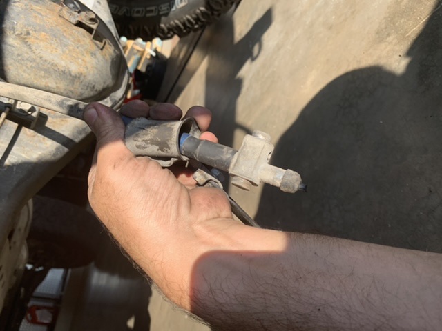

Question about the e-brake kit, what do I do with the end of the OEM cable that has the pivot link(not sure what to call it). Should I cut it off higher up the cable?
I cut above it. Ultimately you are cutting all but about 16 inches of the outer cable cover off by the end of the install.

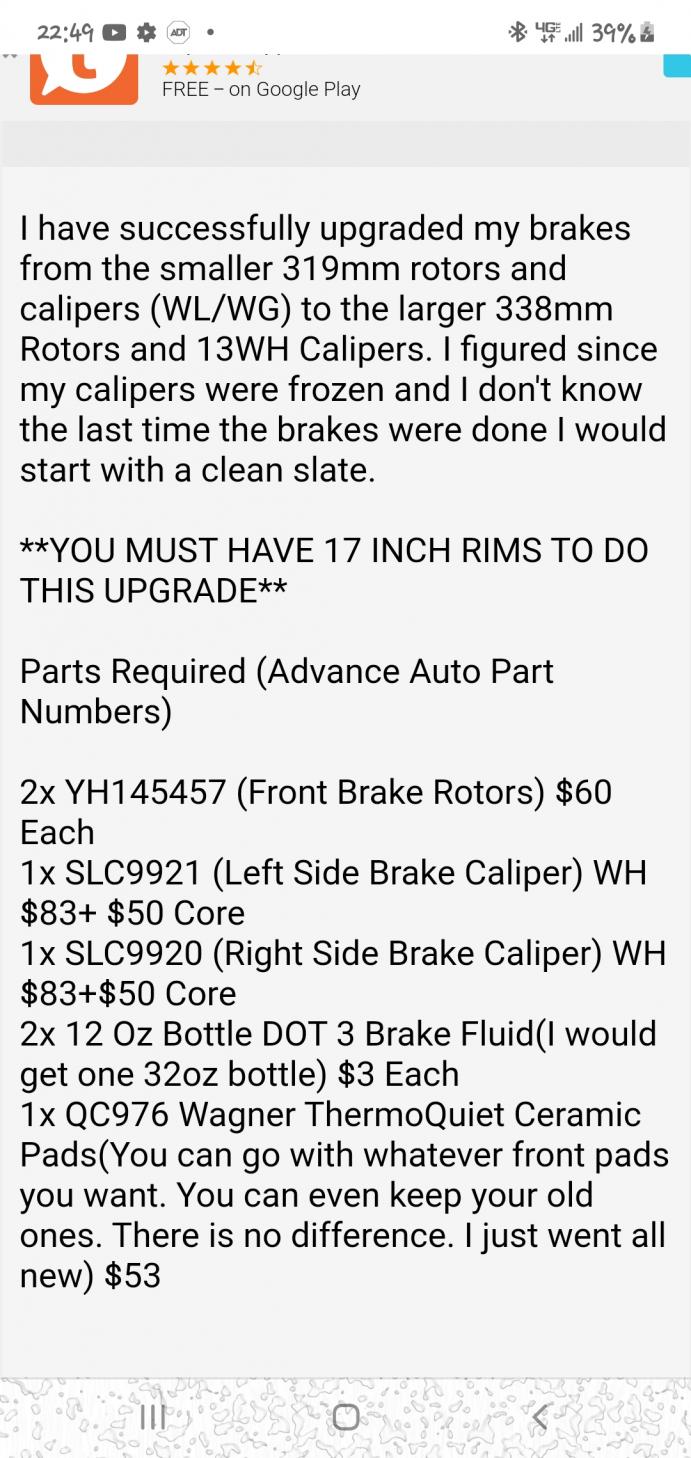

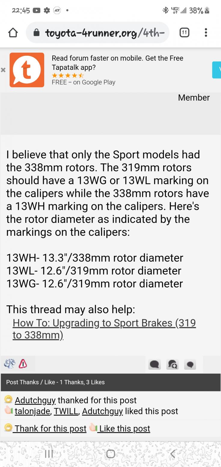

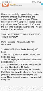

Here is a photo of some info on the 2 sizes I talked about as well as the post on here about it info below
I believe that only the Sport models had the 338mm rotors. The 319mm rotors should have a 13WG or 13WL marking on the calipers while the 338mm rotors have a 13WH marking on the calipers. Here's the rotor diameter as indicated by the markings on the calipers:
13WH- 13.3"/338mm rotor diameter
13WL- 12.6"/319mm rotor diameter
13WG- 12.6"/319mm rotor diameter
This thread may also help:
How To: Upgrading to Sport Brakes (319 to 338mm)
Those are fronts.
Not rears.
