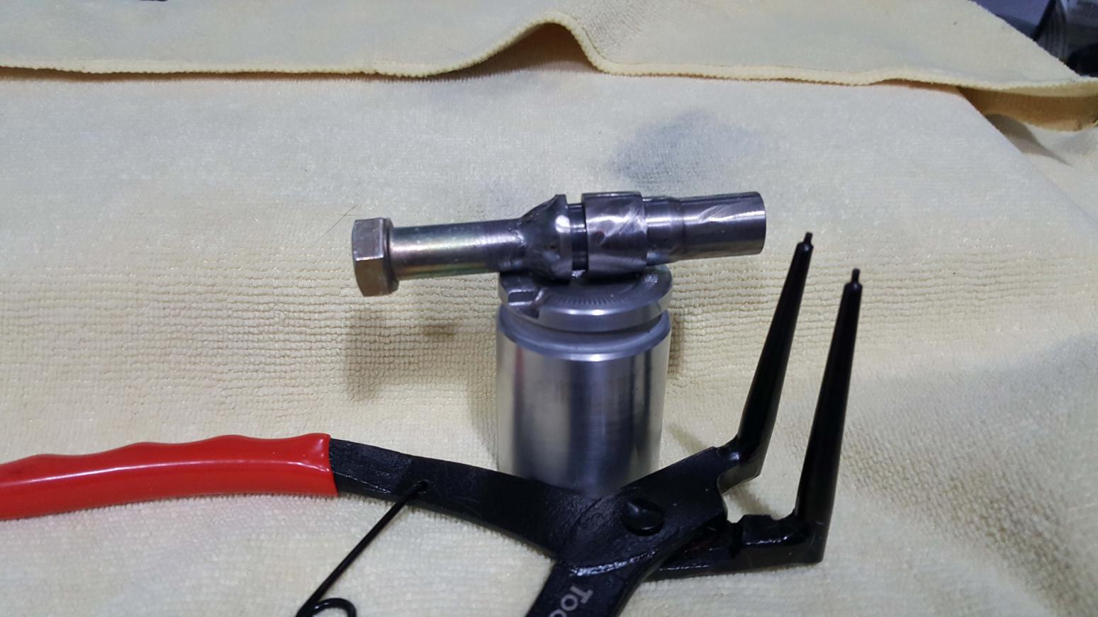

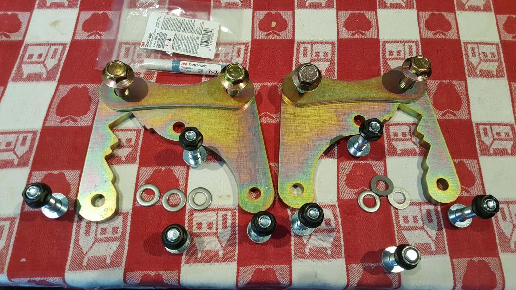

Got the brackets from [MENTION=118207]midcoma[/MENTION] today, and man he didn't skimp on anything in this kit, good quality bolts and nuts, and good finish. Here is a pic. Also the special tool I made from a rear piston auto adjust and a 3" bolt welded and ground. Can't wait for the e-brake set up!

Glad you're happy with it :thumb:
I can't wait for the parking brake kit either!
Did I miss getting these?
You didn't miss anything. 2TH4IST chose to set up his own brake lines, so I was able to go ahead and send him the kit. For the people that sent me info regarding brake line preferences, I placed the order on Friday and will hopefully get them soon.
