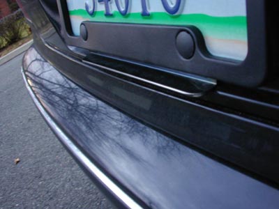

jason952's suggestion one of the best commercially available (and attractive) solutions for this problem. (the clearbra material on the lower part of the lid is idea is good too - Will see if my tint shop will give me some scrap clearbra material from one of their jobs) Also Might be ordering one of these handles myself tho...

jason952's suggestion is by far the best commercially available (and attractive) solution for this problem. I think I'll be ordering one myself! I have a license plate cover installed and was just using it when closing the liftgate, but too much pressure can crack the face... This handle makes much more sense and it's inexpensive.

Perhaps this application is by far the best. However, correct me if I am wrong. There are only 2 (upper) holes for the license plate that are plastic anchor type. With this modification, which I am seriously contemplating, I would have to apply adhesive weatherstrip to the back of the bracket as wellas with the plate.
Would this work? Do we have bolts at the bottom of the plate to attach one of these?
I have large rubber bump stops installed behind the plate to keep it away from the tailgate, (the kind used for electronics) so I can still attach the handle to the lower bolts that are on the license plate cover that I already have.
